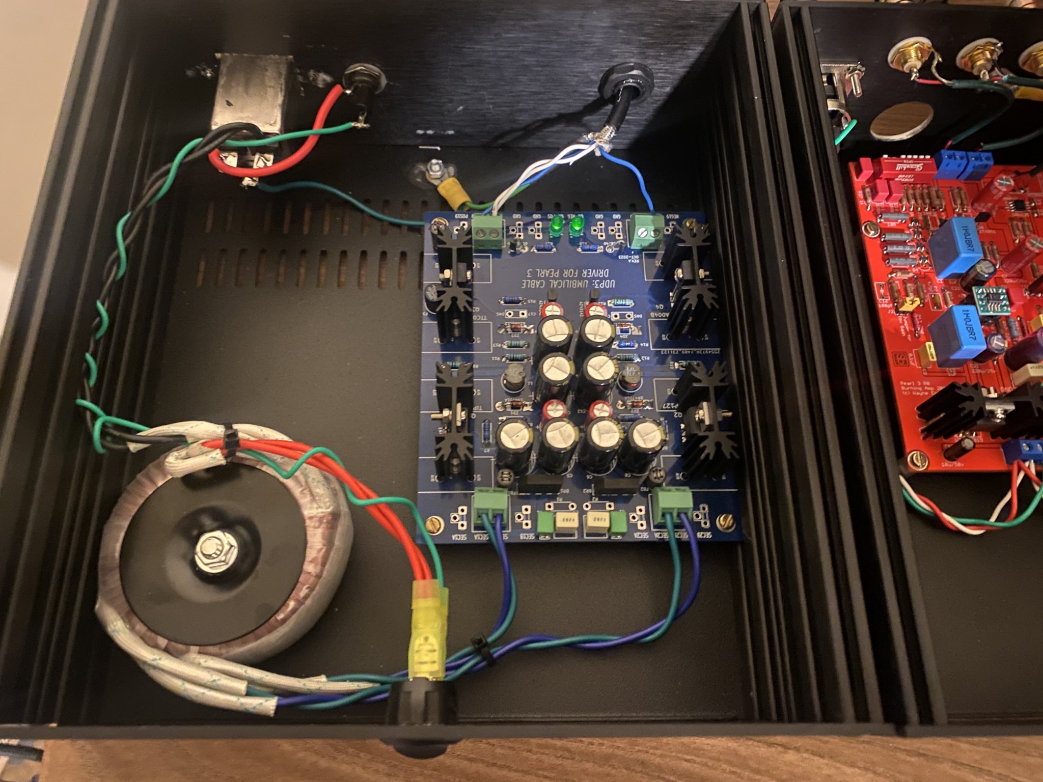

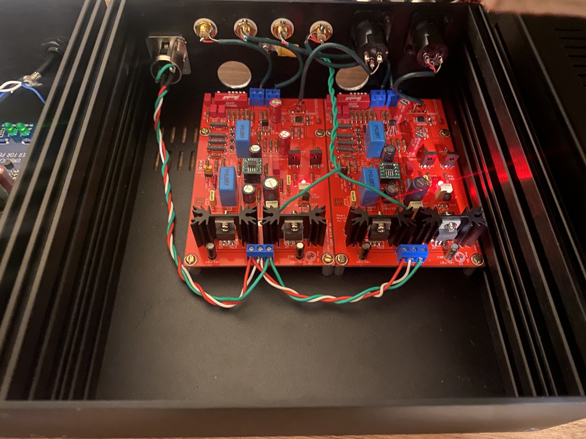

Just finished my P3 and a big thanks to @Algar_emi for the boards and @olen for some matched parts for the RIAA and JFETs.
I’m using OPA1656 and been comparing it to my Pearl 2. The P2 does have a more Analog sound while the P3 is more exciting and has more top end detail. I noticed the P3 has opened up more as I play it. When I first turned it on for a listen I was concerned with the bass.
I moved it to my main listening room and just turned my subs up a bit more. Hoping more hours will continue to help it balance out.

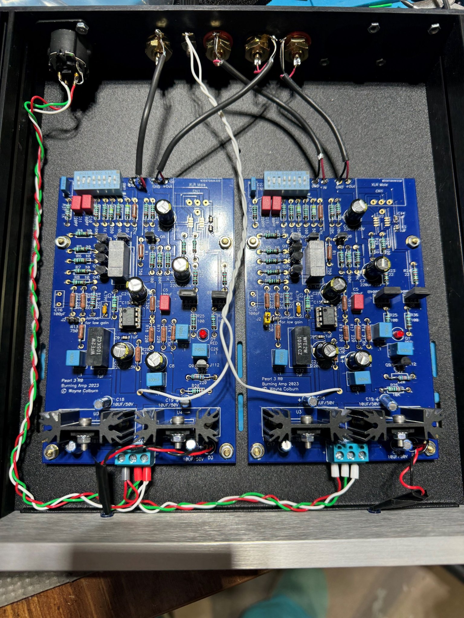

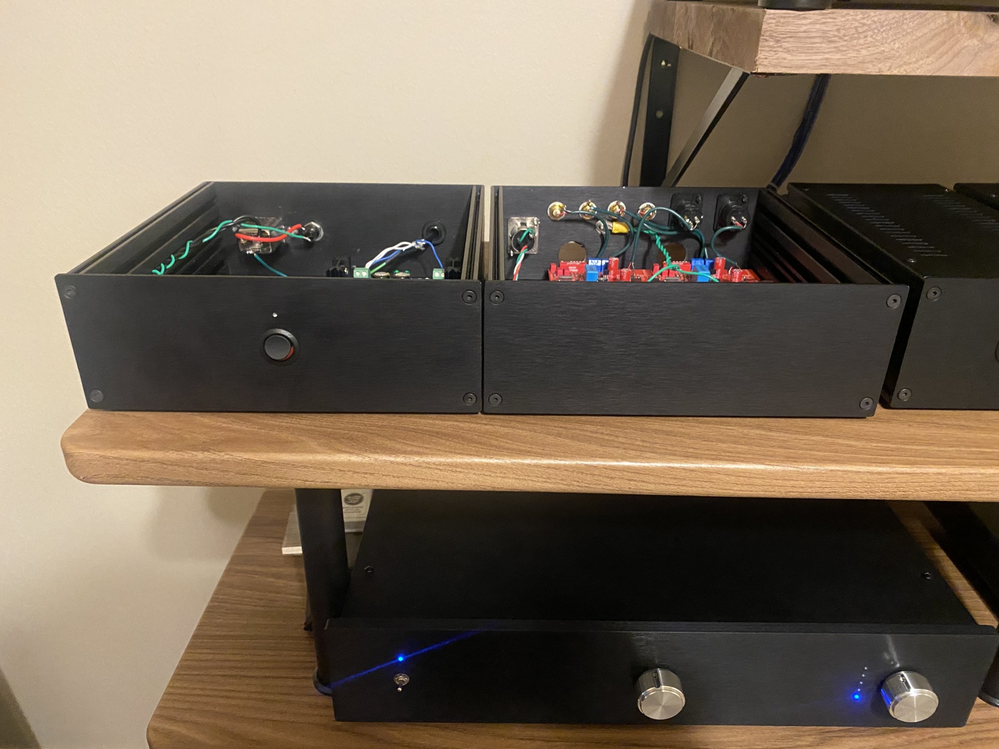

Finished my Pearl 3 it is amazing, a step up from the Pearl2 and my Bottlehead Eros 2. Listening to Ludovico Einaudi, one of my favorite composers. I listened to it with two different turntables, a Rega P6 with a Rega Ania Pro and a Sota Saphire with a vintage Kiseki Purpleheart cartridge. The Pearl 3 sounds very detailed and has a very immersive sound stage I am hearing more than I have with other Phono pre's. I tried a few different op amps. The OPA 2604 (came with the kit), Sparkos SS3602 discrete opamp, Muses01 and Muses02.
My favorite is the Muses01. This gives the best balance between clarity and warmth. The Muses 02 was little less warm, but still amazing. The stock op amps came in third and I really didn't like the Sparkos, sounded less "clean" to me. Take this all with a grain of salt, as i have gotten older I realize I listen to 1000's of $ of audio equipment with $200 ears.

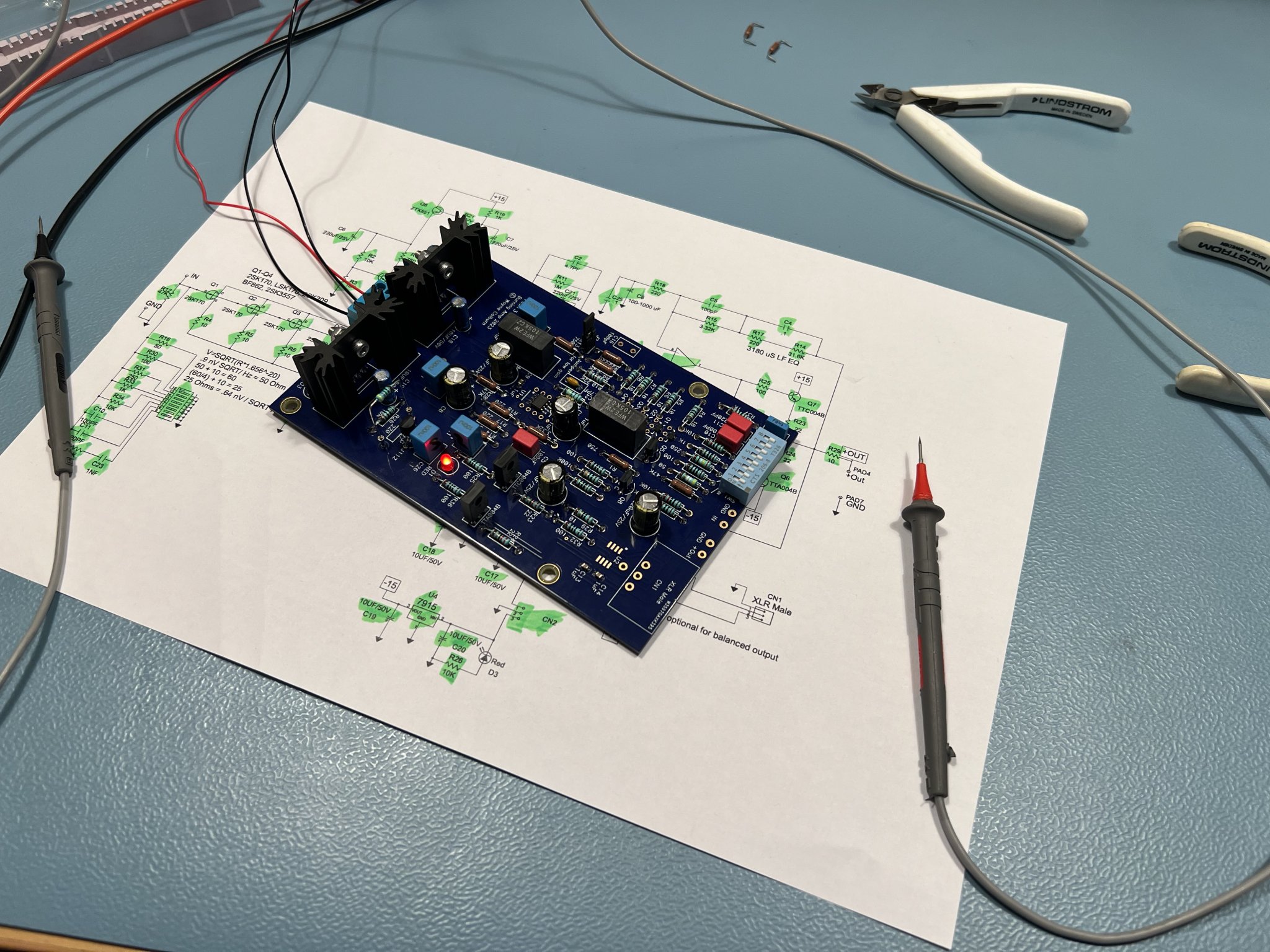

I just tried lowering C8 from 1000uf to 100uf to see if I could hear a slight improvement. No major change.
When I first listened to the P3 it was with a Shure V15 Type iii set to 47k and I thought the bass also sounded weak there too.
Ugh… I’m dumb. I just realized my XLR pin 3 was connected to shell and NOT pin 3 on my board. My boards have a shell PCB connection where the boards online are just 1,2, and 3.
I fixed it and and immediately the bass heavy Justin Timberlake album (belonging to my wife… wink, wink) blew me away!
Going to reset everything and restart my listening on the other albums I had been testing before.
