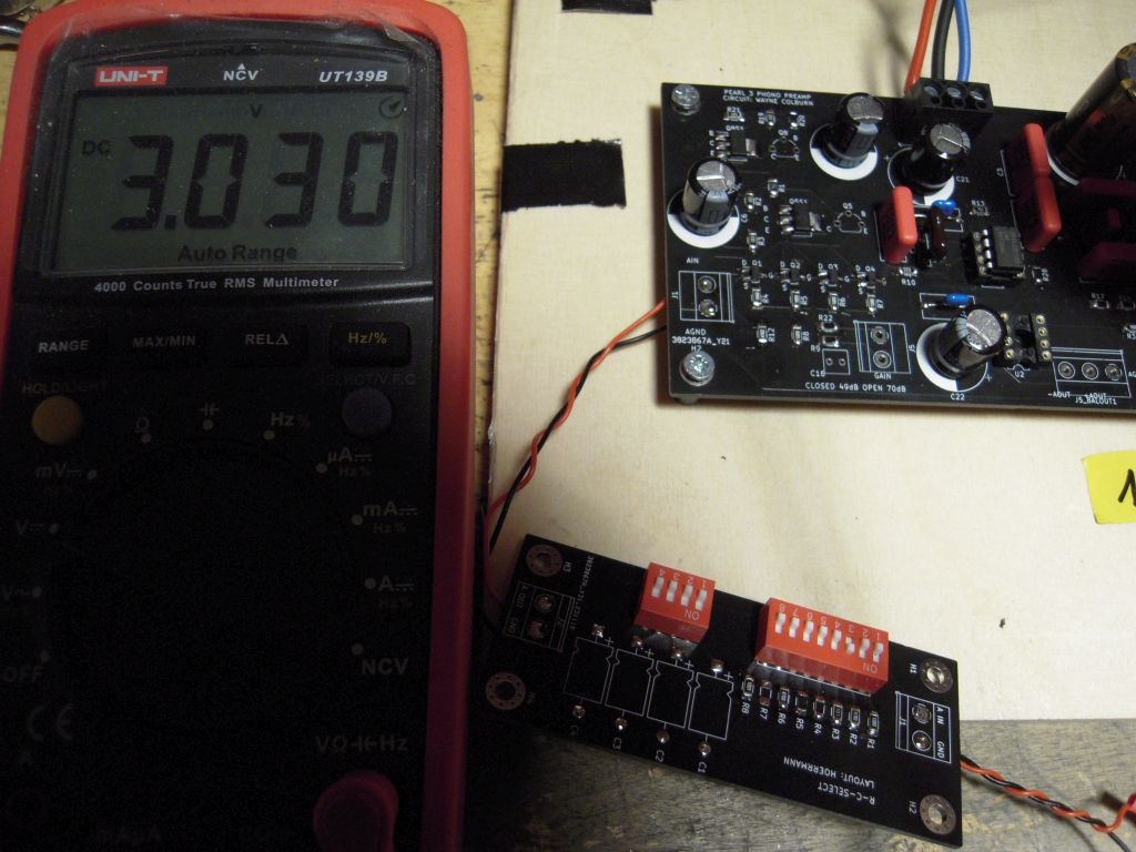

Good evening,
not another finished build...

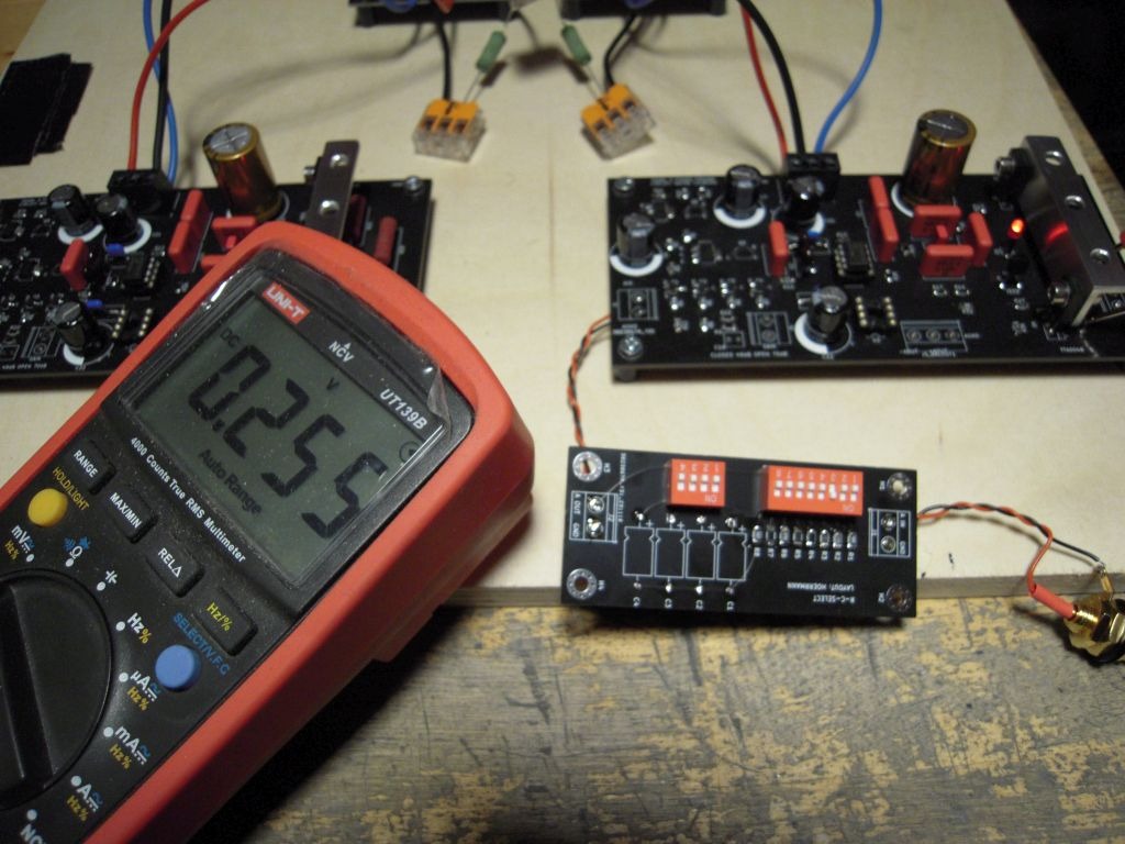

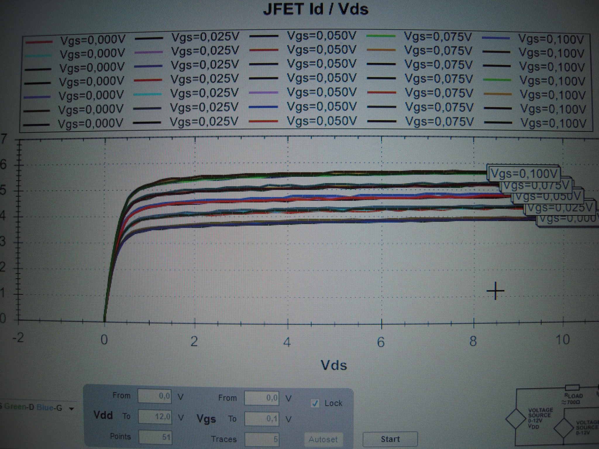

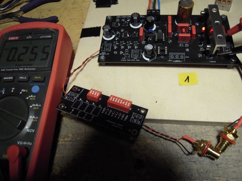

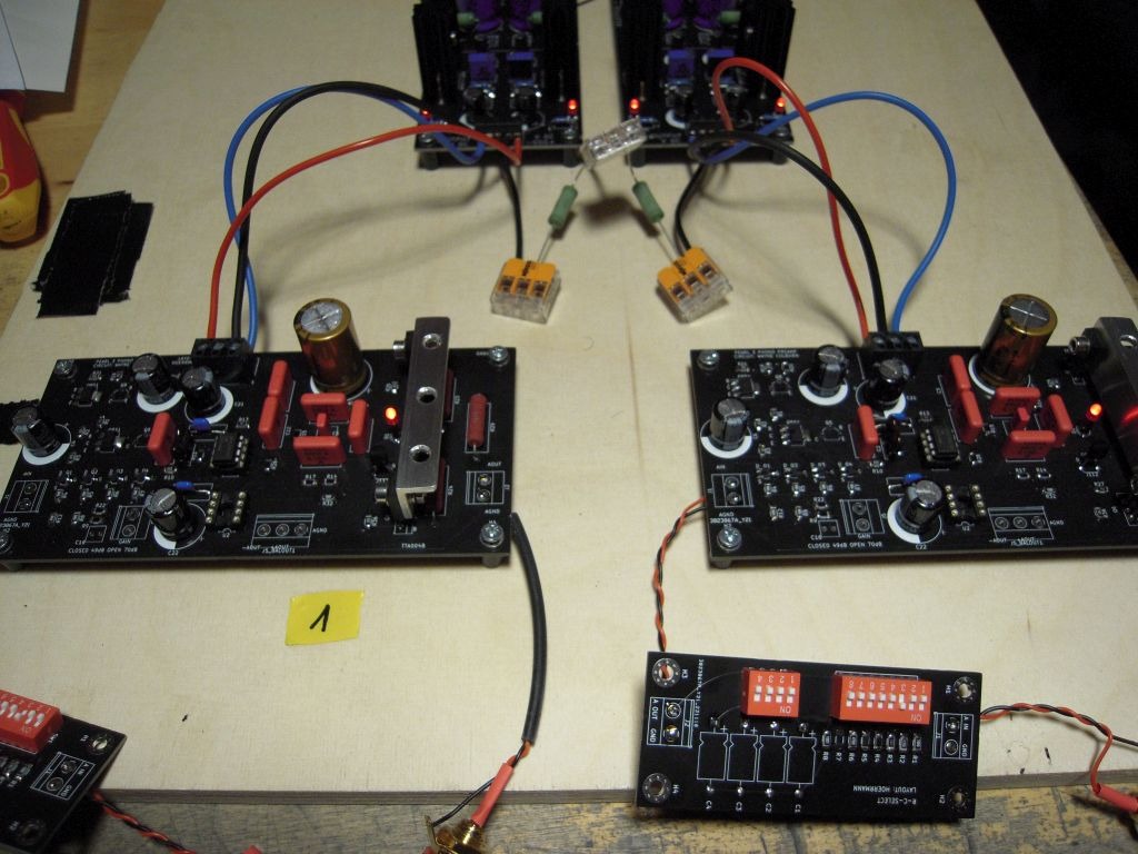

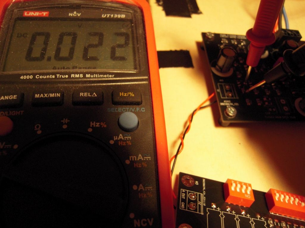

But a finished 2nd set of boards.This time with TOSHIBA 2SK209 GR in the first stage. I measure 0,022 V or 0,021 V over all 8
source-resistors (10 Ohm). So they are all running at 2.1 mA to 2.2mA.
I measure 3.03 V over R 27 (increased to 750 Ohm), so this equals circa 4mA. Looking good.
Offset at output is slightly fluctuating without load - anywhere around 1 - 3 mV. All good.
Bias of the TOSHIBA TTA/TTC004B is 0,255 V over the resistors R23/R24 (22 Ohm), so anywhere around 11.6 mA.
The balanced line driver is not stuffed for testing.
Did I mention, that it sounds really great from the start! No testing with cheap speakers - full risk and full pleasure! 😉

and sorry for the fotos - I made 'gymnastics' to measure in the circuit and taking fotos at the same time...
Why isn't there a third or fourth Hand, mother nature?

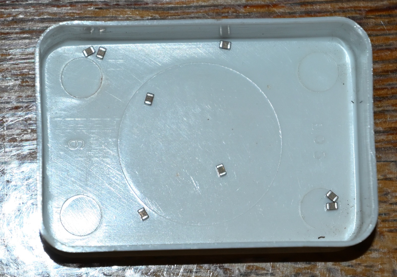

I plan during the weekend to solder the 2 x 4 small smd capacitors.
I put them in a small plastic box just to ensure they don't "run away". But a small accident happened! .....one capacitor jumped to the table.
It took several minutes to locate him and put him back. I can't recommend to drop any of these. Dropped at the floor you can consider it dropped forever!
Just a warning. Don't drop them 🙂

In the kits you will find that there’s (9) 2SK209 Jfets. One extra just in case you sneeze.
There are only (8) of the 1uF capacitors, as the vast majority of builders are not going to stuff the balanced line driver, if you happen to lose one, order an extra when you order the DRV135. Whereas if you don’t use the balanced line driver, you’ll have enough capacitors.
When ordering parts for SMD boards, I make it a habit to order either ($2.00 worth of extra parts) or (3 extra parts), whichever calculation yields the greatest quantity. For each SMD line item on the parts list.
It seems to me this is "cheap insurance" compared to the shipping cost and DELAY of re-ordering after misplacing a dropped component.
