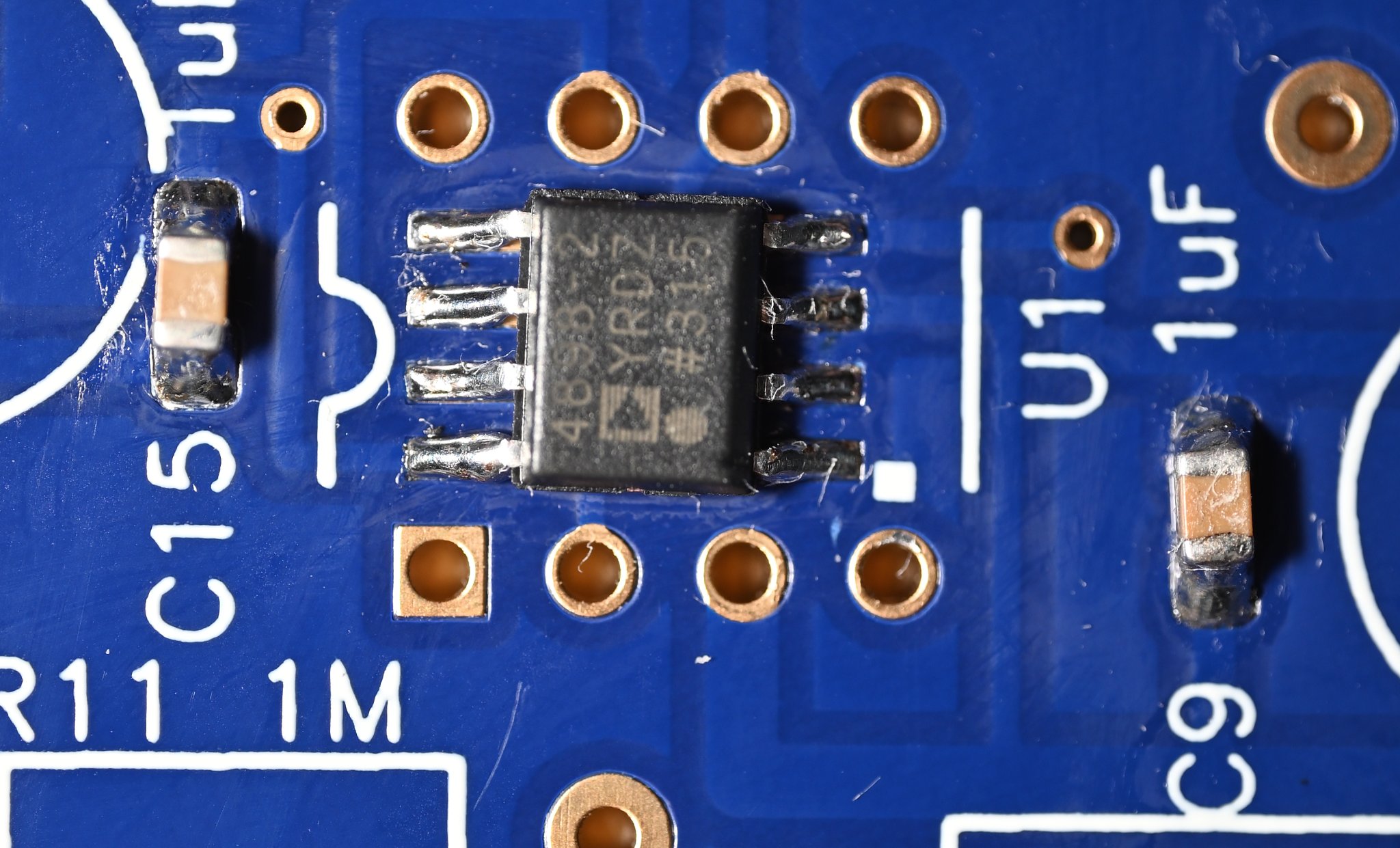

I got the smd solder work finished on both PCB's. It requires some concentration.
As you can see I won't do opamp rolling.
Looking at the images I could see I needed some "dust off" from the cotton stick from the flux removal and also some solder "dots" between the legs. That has been done after the images was taken. Now I just hope the opamps works!
It will take a while before that can be verified.
