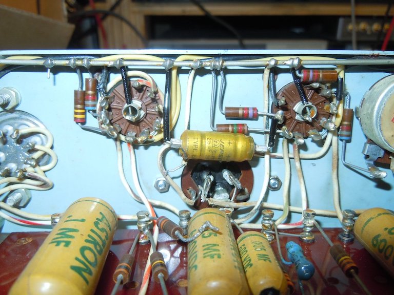

I like the circuit board pressed in turrets and grounding buss that is tucked in next to the corner of the chassis next to the twisted heater conductors.
