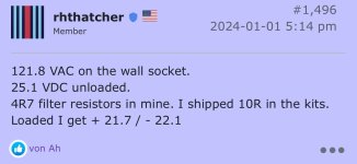

Hello all, I just finished my power supply build (using the group buy kit). Unloaded, I’m measuring 26V at the power supply output, which seems rather large. I checked all values 3 times and measured every resistor. My wall voltage is 125-126V. Any thoughts on where I need to look to see why I’m a bit high on the voltage? My caps are 25V and I don’t want them to break down, so it’s off for now. Thanks!

I ran a PSUD sim, 18Vac at the transformer secondary (unloaded), 10M load at the output. Get 24Vdc with 117V PT input, adding that line voltage could be 126Vac that makes the output voltage 26Vdc (no-load). Putting the load on the PS should bring it in spec.
