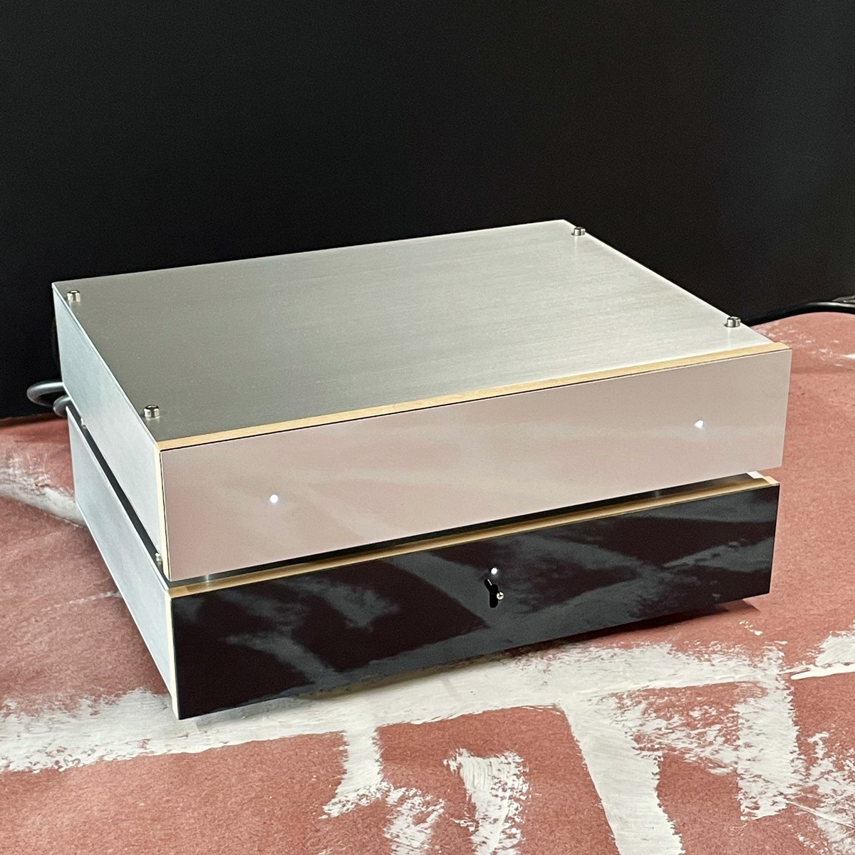

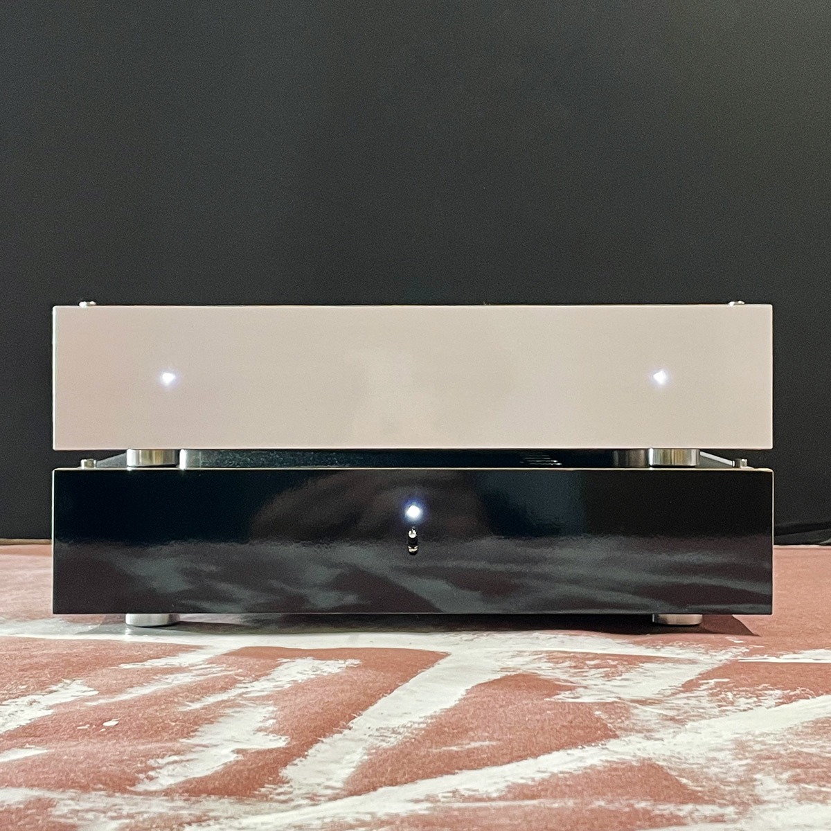

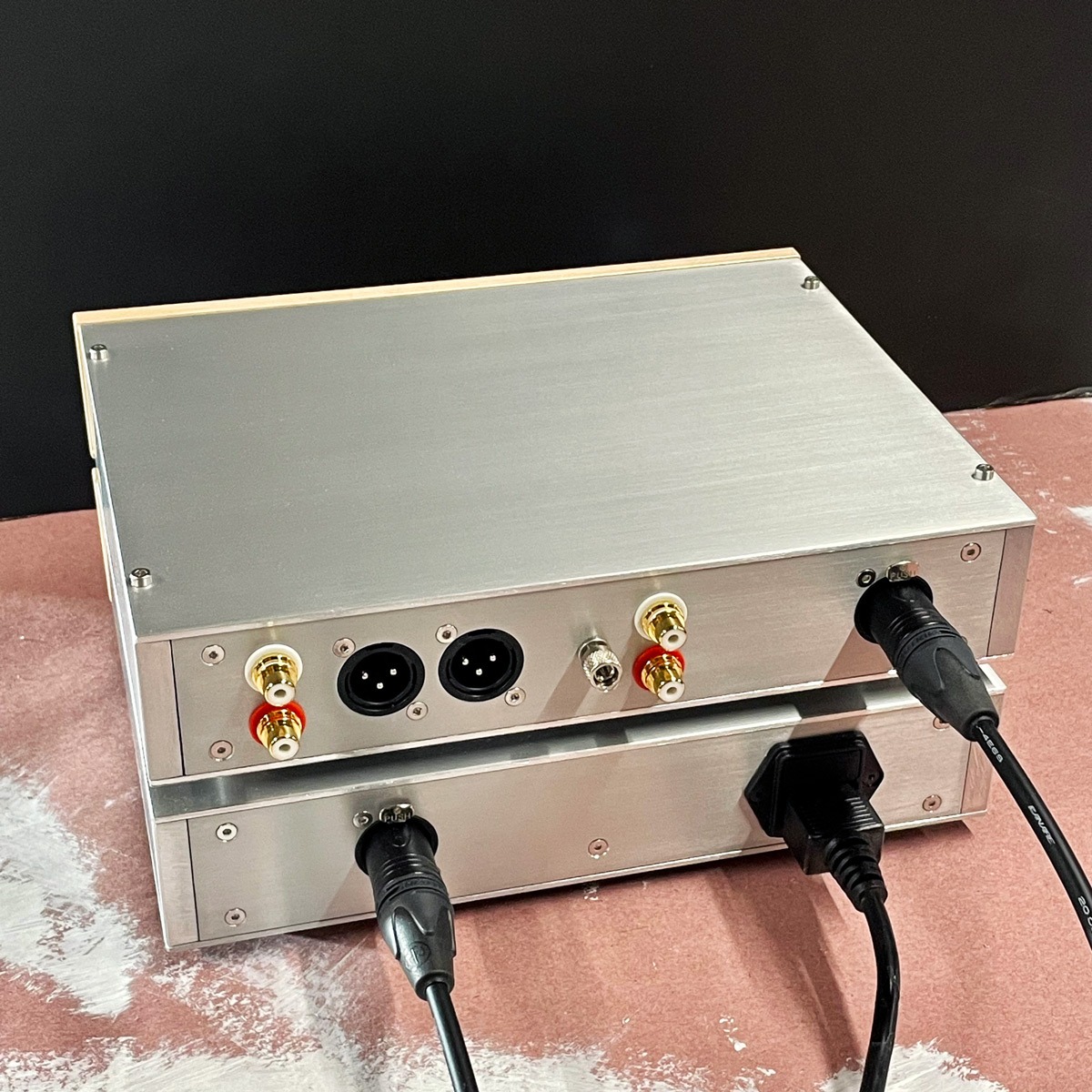

Low res shop shots....finished cases.
Loving the sound! No complaints....I won't know anything in the way of comparisons until I switch back to another amp....can't wait to listen to more records though... what more could you want?

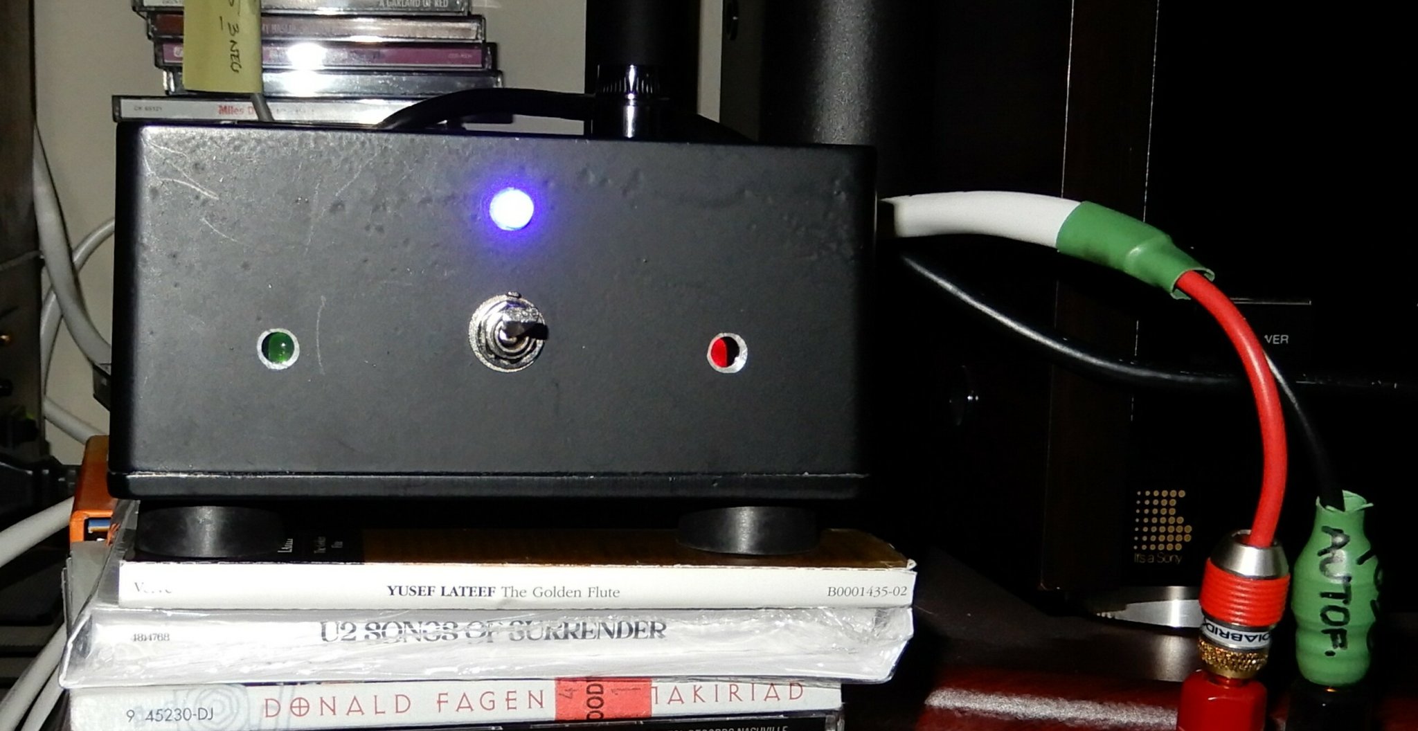

Finished the project power supply and have been using that instead of the lab power supply, and must say - this is a quiet, beautiful sounding phono preamp. Very clean, great detail and separation, frequency range sounds excellent, and very quiet. Really one of my best phono preamps, and I've got lots.
I drilled holes for the red/green diodes, but kept them on the board and just put in clear plastic windows. Subtle, but still able to observe both rail diodes when desired.
Kudos to Wayne for a lovely design!

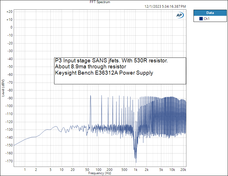

Hello All,
I am still playing with the P3 input stage assembled on a a breadboard and the the power supply.
This thing is assembled without the LM7815 and without the jfets. There is a 530 ohm resistor in place of the jfets.
The intention was to measure the PSRR of the capacitor multiplier. I did not make it that far.
There are the 60hZ, 120hZ, 180hZ and on up power supply ripples remaining down stream of the capacitor multiplier.
See the attached power supply FFT plot below.
Other people are completing the P3 with reports of quality sound.
What I see in the FFT plot is ear to the speaker noise and the need for more filtering.
Thanks DT

When builders install the LM7815s / LM7915s, they will get different results.
When you put the JFETs in, the PSRR will change by the amplification of the first stage.
The three-legged regulators will knock down the transmission of the LF by 60dB at least and the cap multiplier will reduce the noise.

The noise performance of course depends on the non included power supply.
When I run my system wide open I do indeed get ear to the speaker noise. Everything in one box.
At normal listening levels it isn’t there. I don’t know how much is supply and how much is pick up.
