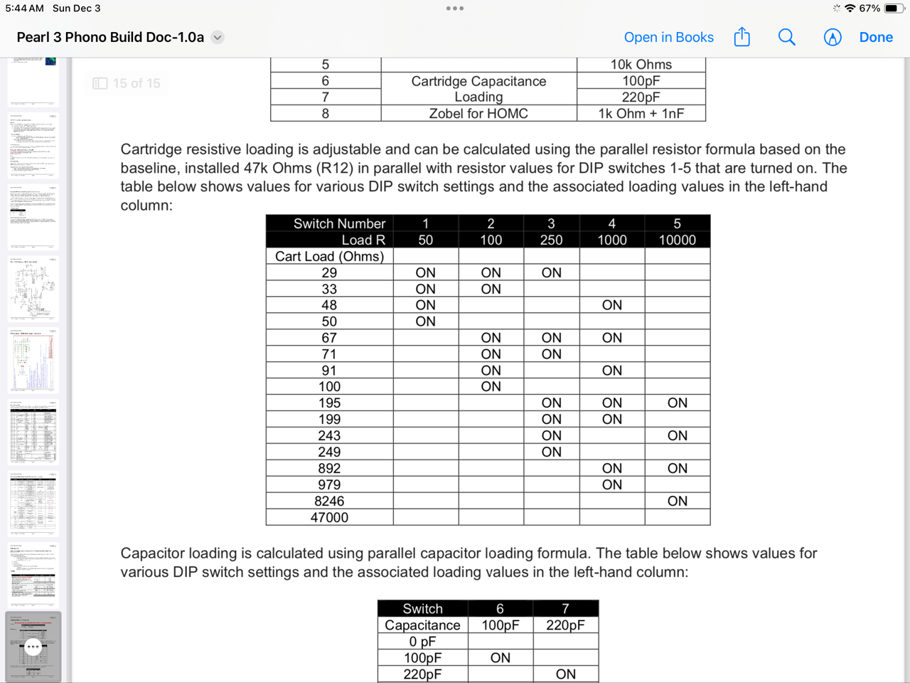

(1) How do you select 47K? It's not clear.

That's simple - don't turn on any of the resistor DIP switches. It's always on. Every resistor on the DIP is smaller and placed in parallel.

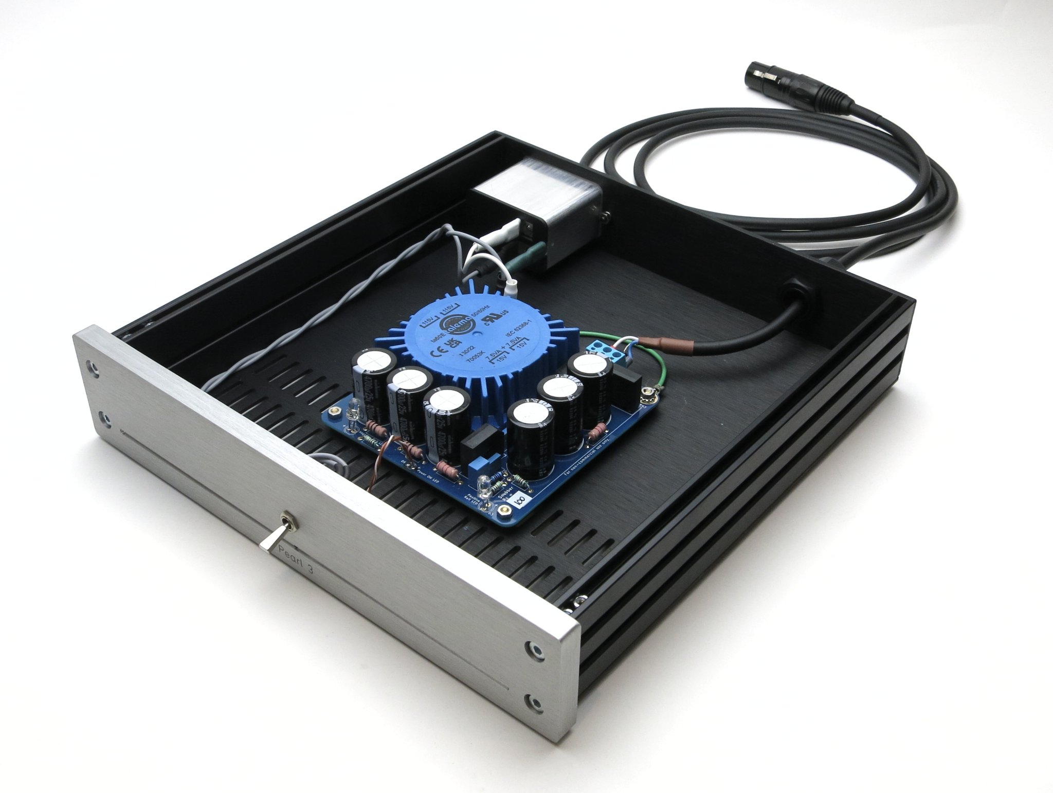

Example PSU using the included circuit board. This is built with the parts similar or identical to those listed in the build document.

As far as not using any of the DIP switches to achieve a 47K load... I looked hard at the provided tables but I didn't see such an option. If it was, then it wasn't obvious.

It’s right there in the resistive loading table on pg15…

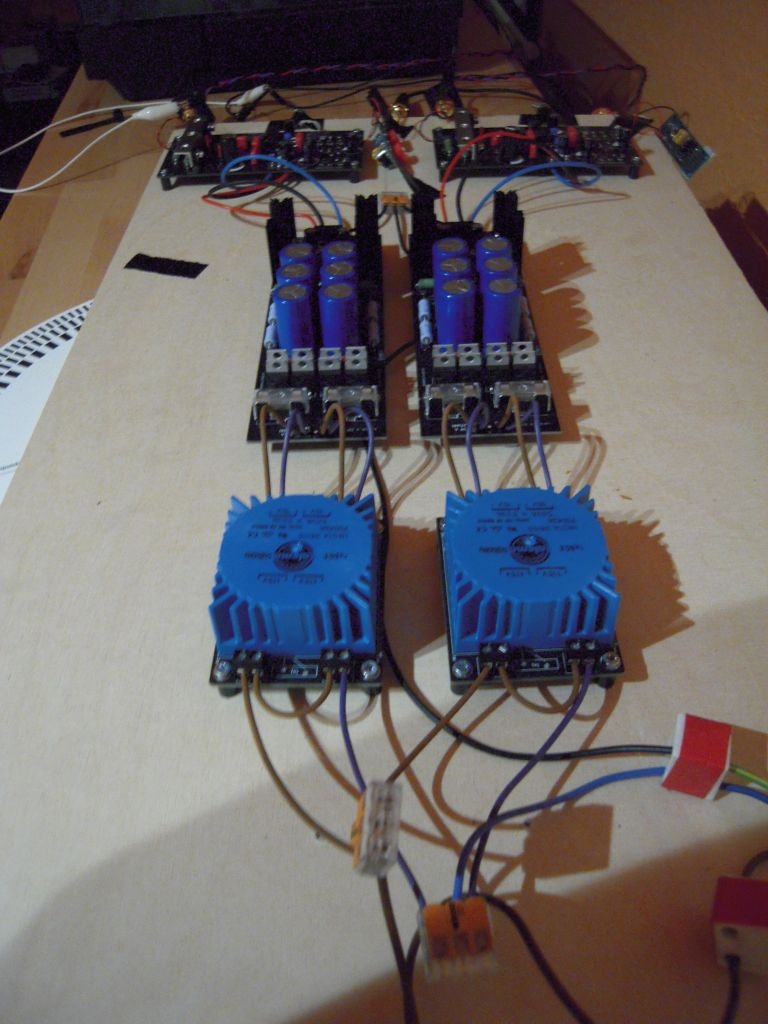

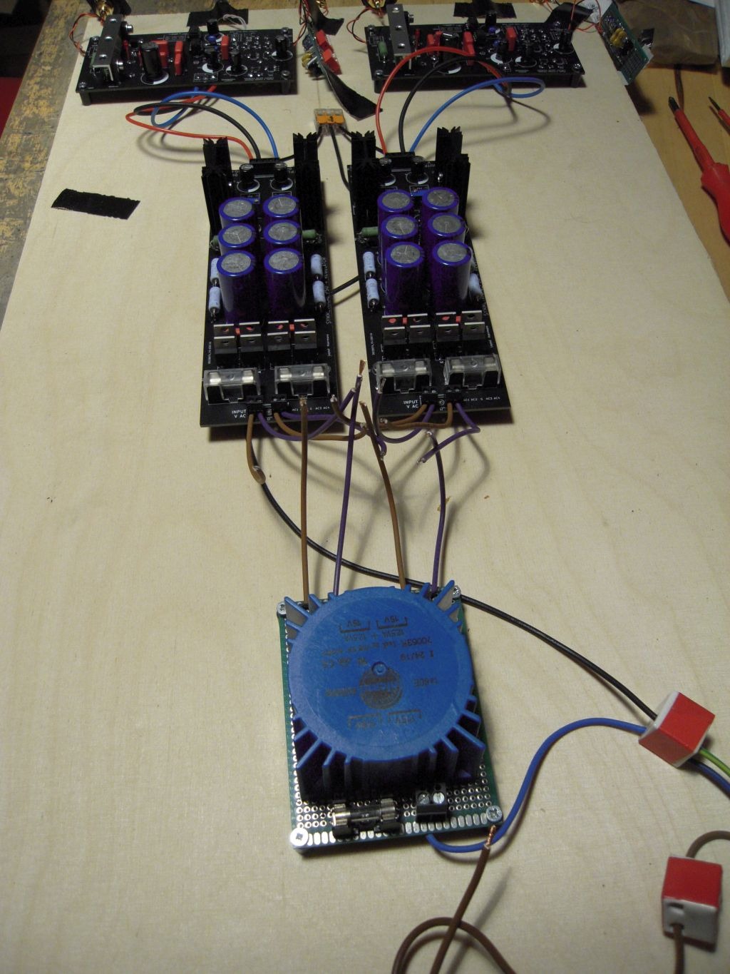

What all is populating your boards? Are those pre-regulators at the far end?
That's what I've been thinking too...
Thank you, Cubicincher.
I've considered the same thing - even mounting the individual phono boards in their own chassis with an air gap, but common faceplate/back panel. Cuz, why not?
@mhenschel:
You are right, it is a simple old-school PSU with fullbridge-rectifiers (MUR860), followed by a CRCRC-filter, followed by adjustable regulators (LT10857LT1033).
But this solution has the disadvantage, that the regulators are farther away from the PEARL 3 - boards... Hmmm 🤔
Waynes solution with the regulators on the PEARL 3 boards is in my opinion better. But I had these PSU-boards, so...

@cubicincher
since you have the boards... just set the PSU output voltage to whatever Wayne's boards need -- perhaps the minimum of 17V -- to make 'em run well and to generate the least heat.
I'm considering this approach because of the unusual enclosure (with no or little ventilation).

OK. so you can reject that one comment about 47K loading.... Perhaps... instead of blank, it ought to say "OFF"? But know I'm grasping for straws... I guess you can let it be.

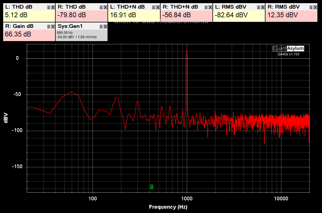

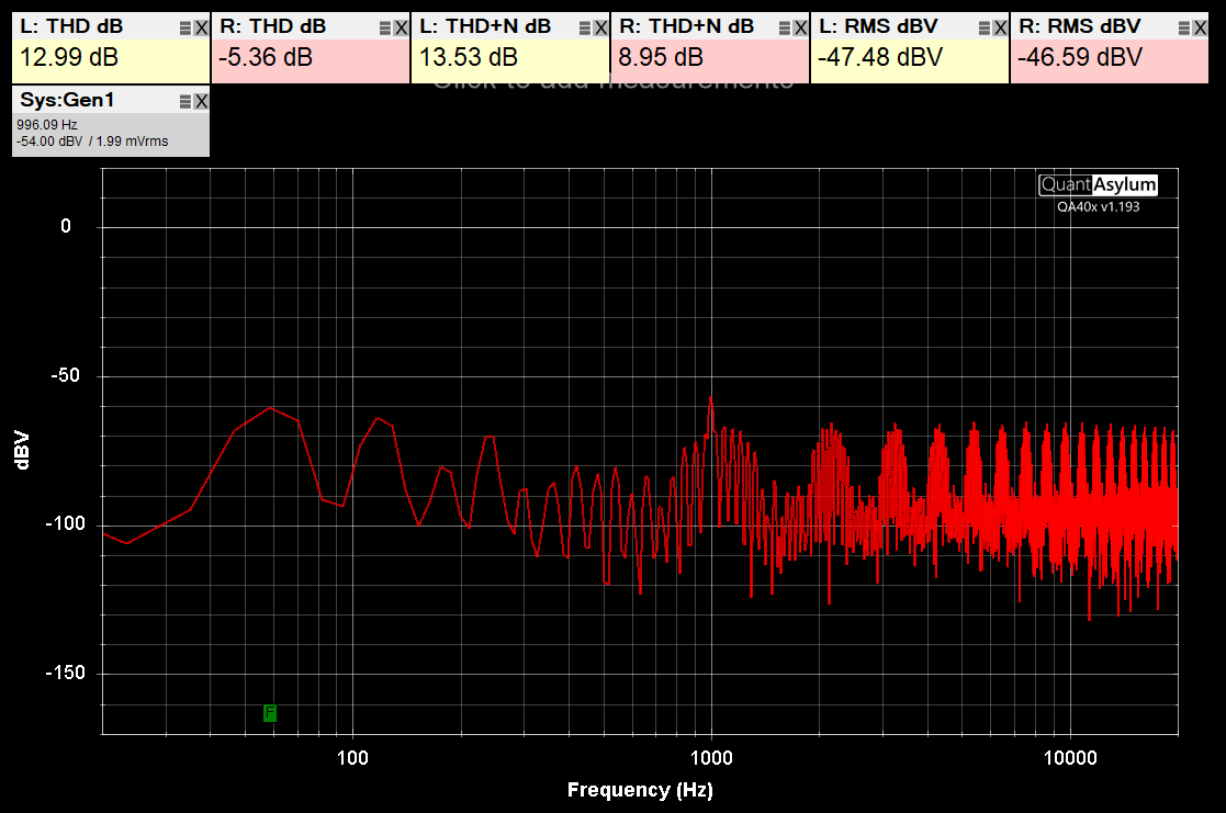

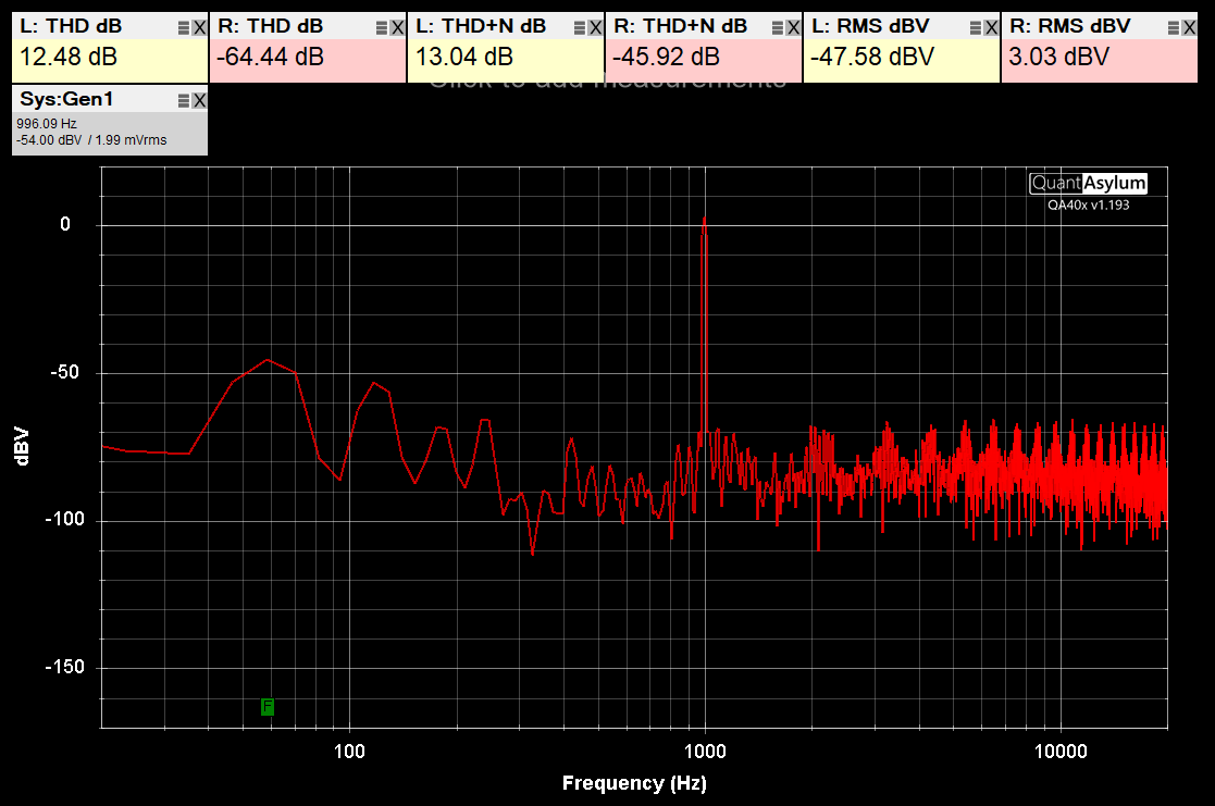

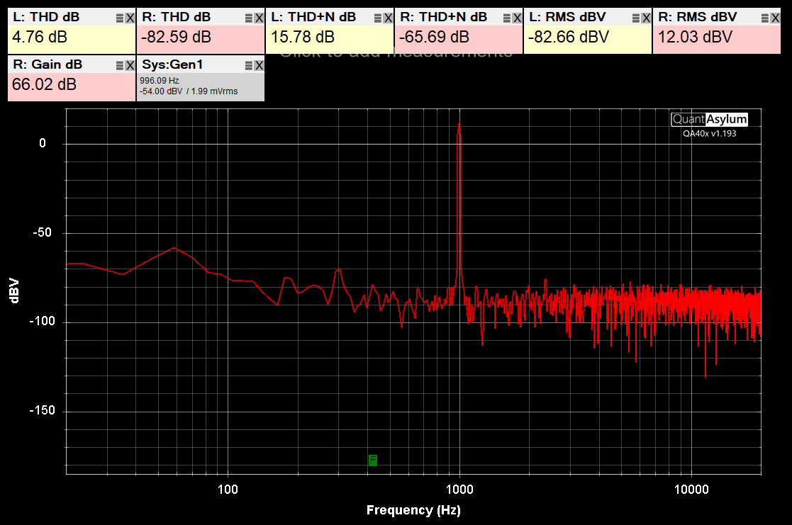

Here are a couple of distortion measurements of my Pearl 3 with remote power supply. The first shows the performance with the power supply 6 feet from the preamp, and the second is with the power supply box sitting right on top of the preamp. My Q403 is new to me - have only used it 3 times before, and only with power amplifiers, so I'm not sure if I've got the settings optimized. Oscillator input was set to 1.99mVrms for all tests, corresponding closely to my MC cartridge.
For comparison, here is an image of an iFi Phono preamp with remote wall wart. I tested it with a reverse RIAA board (Hagerman), and without.

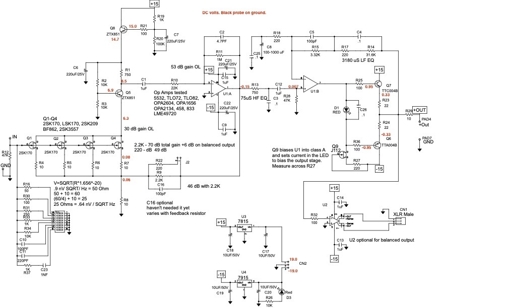

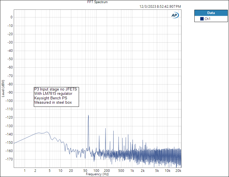

Hello,
I like what you are doing with the QA403 P3 measurements.
I revisited the P3 input stage noise measurements. I found that the bench power supply interfered with balance input measurements. Single end input to the analyzer works out much better.
Included this time is the LM7815 regulator. the added regulator helps reduce the noise measurements just a couple of dB's.
Next round I will add the jfets.
My impression so far is that much or most of the 60Hz on the FFT is leaking in somewhere.
As @wayne tells us 1 part per million is -120dB's. a Small leak may show up big on the FFT.
So we will watch to see what happens to the 60Hz spike, will it stay the same or amplify with the added jfet amplification.
See the attached FFT below.
Thanks DT
