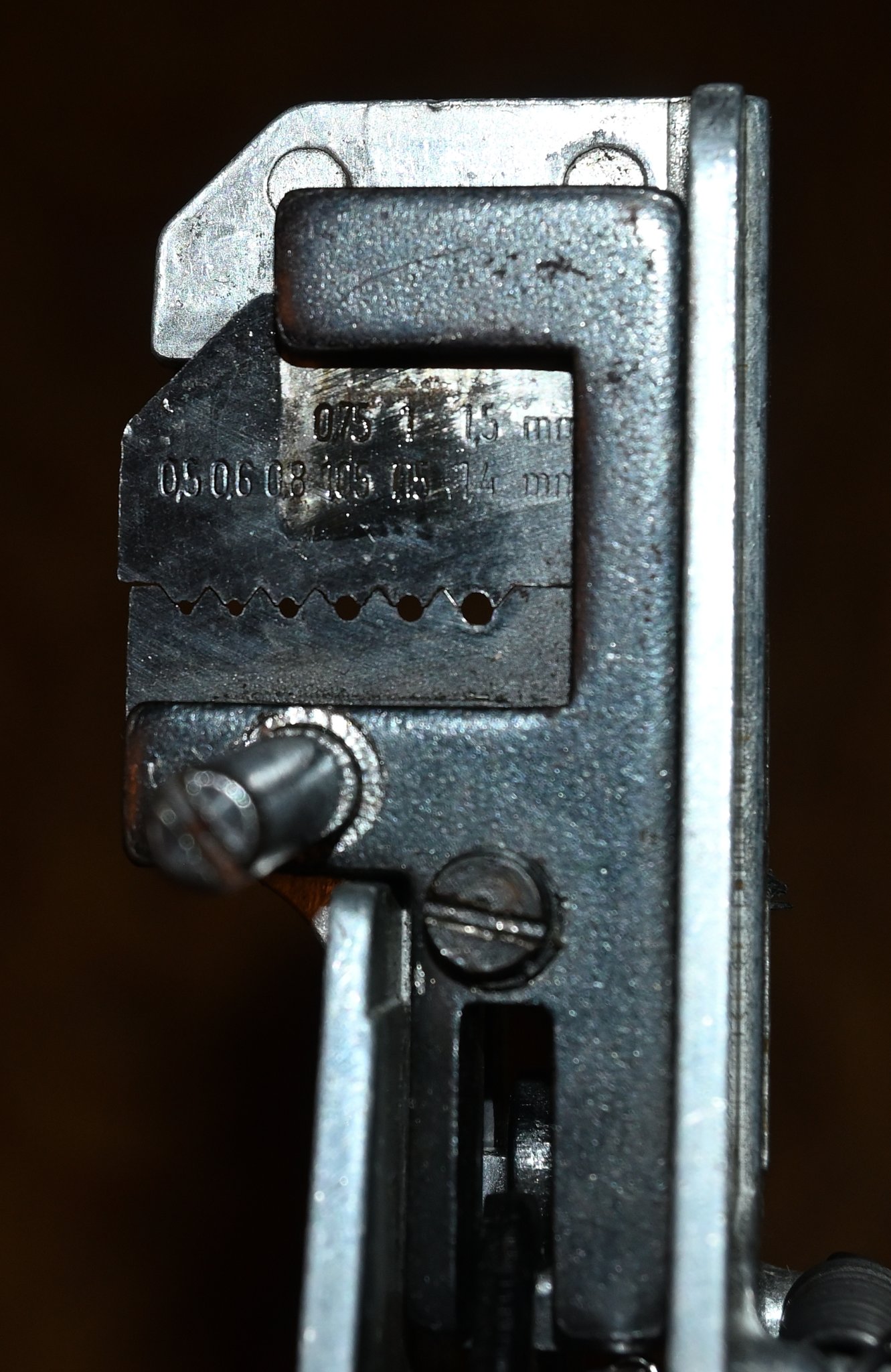

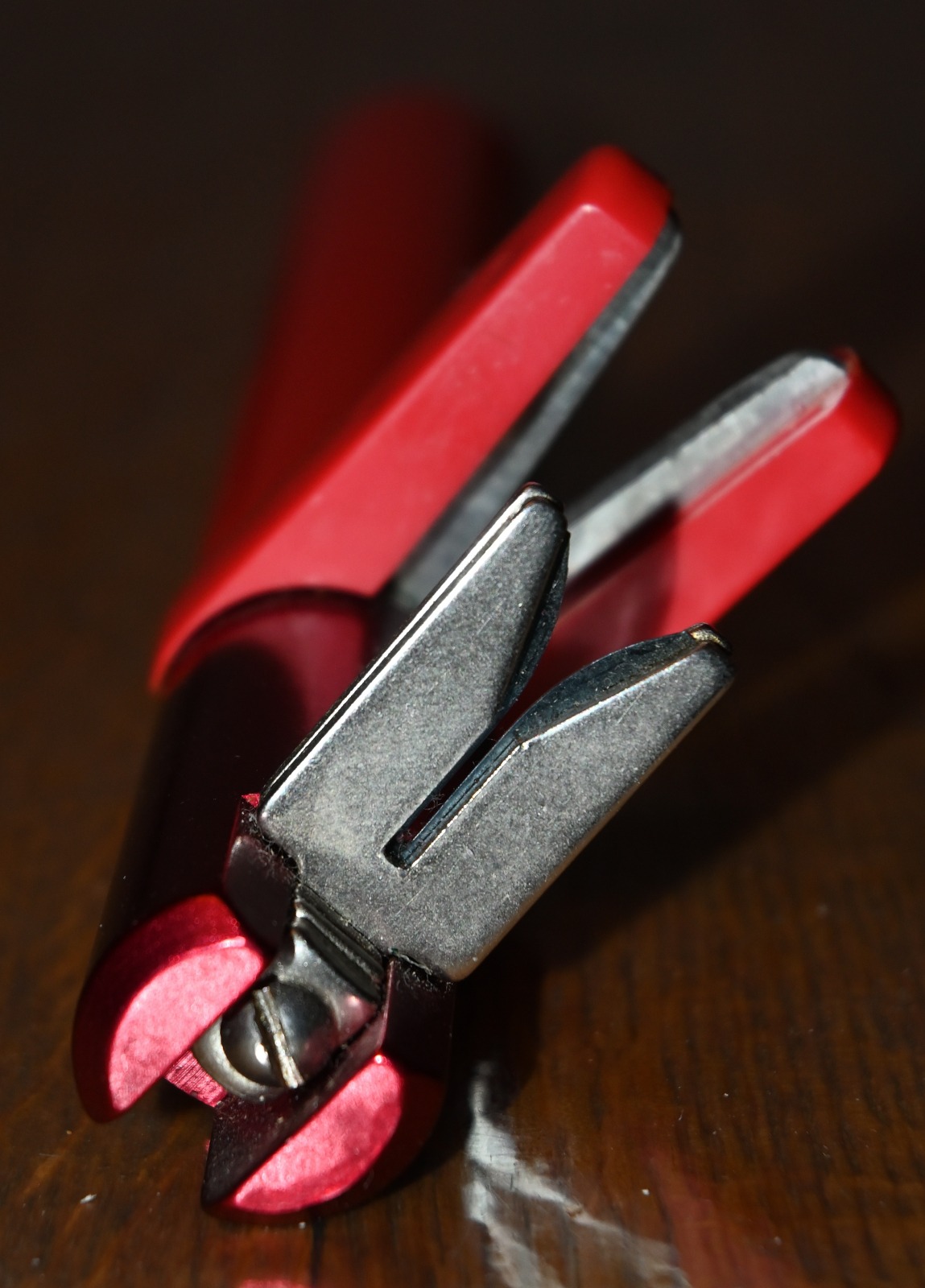

I will look for the Kleintool for the small gauge wires.

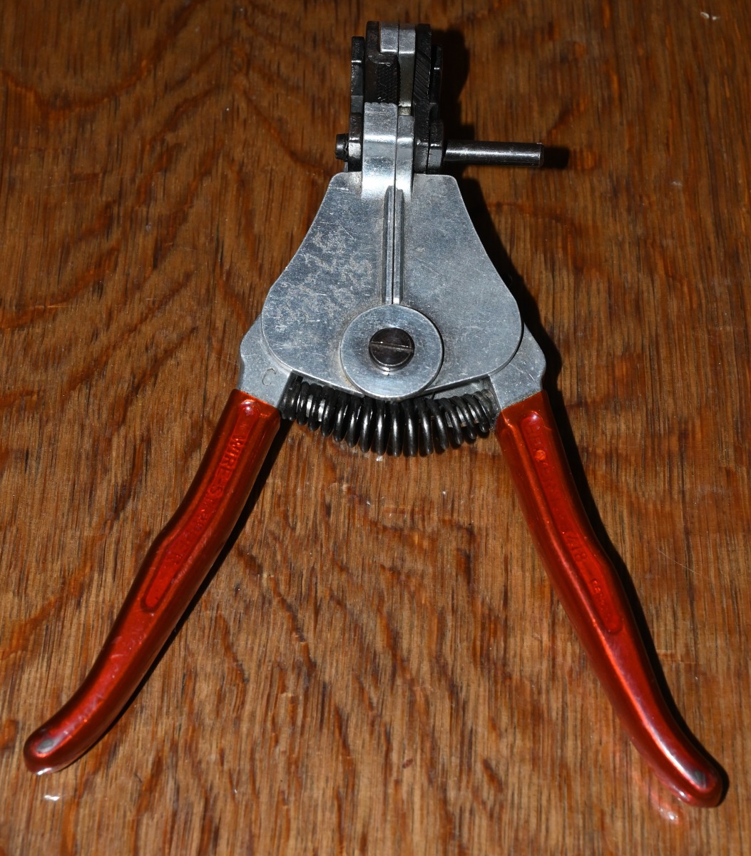

I also have some of the "Katapult type" strippers. In my case those are vintage Belzer tools (German).
The one which takes smallest gauges shown at picture. Maybe those exist for even smaller gauges.
The dedicated WW-tool I have is for AWG24 only but also exists for AWG30 and can be purchased new. But they don't give them away as gifts. Same applies for this Erem (Weller) tool which I have considered to have as "Christmas gift":
https://www.weller-tools.com/us/en/precision-tools/products/pliers/552s
The Klein-tool is a bit more price-friendly and ZM's approach.

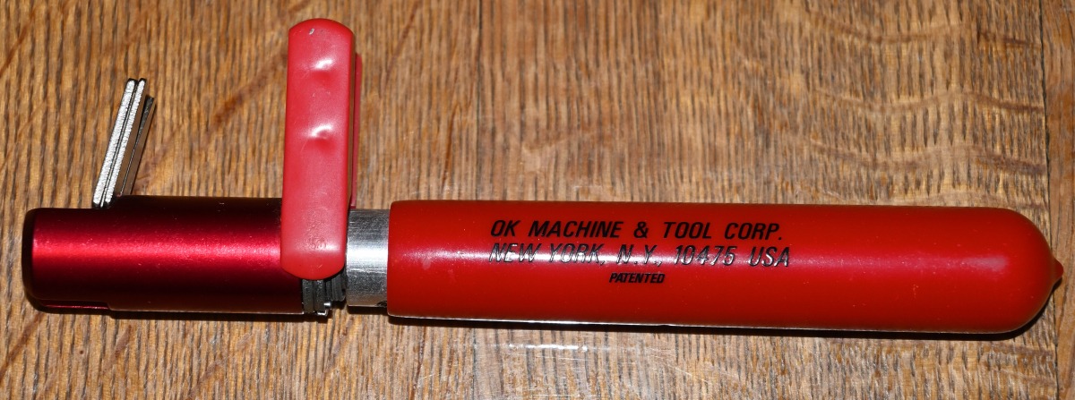

Also if it is "teflon" (PTFE) based insulation? ....that is the case with my vintage wirewrap 30 AWG cables....

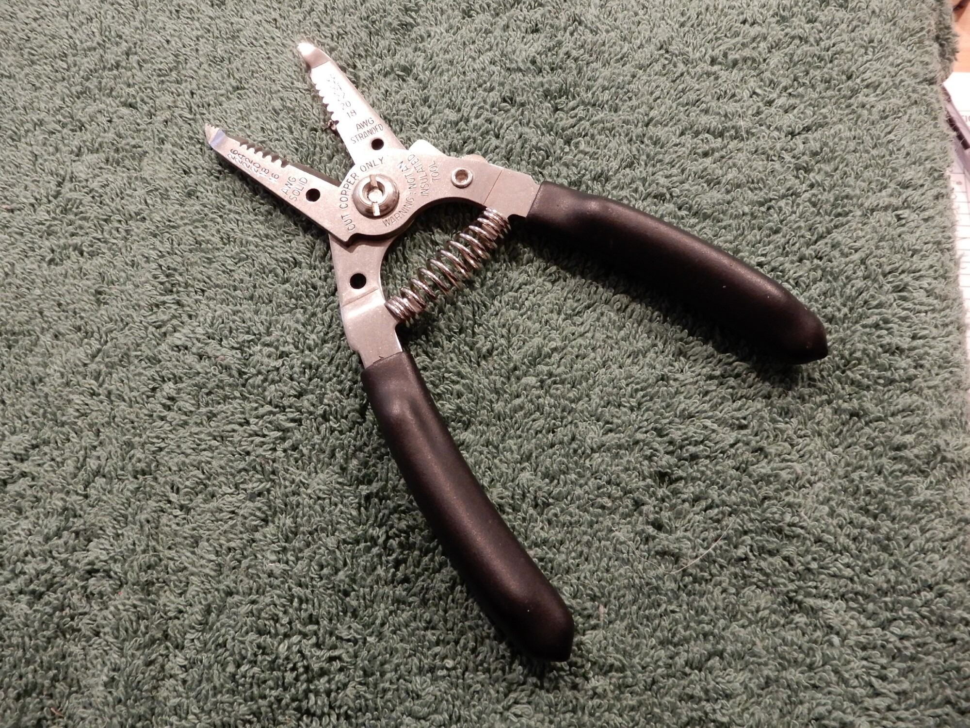

I just ordered this one at Amazon to try it out:
https://www.amazon.com/dp/B000XEUPMQ/ref=pe_386300_440135490_TE_simp_item_image?th=1

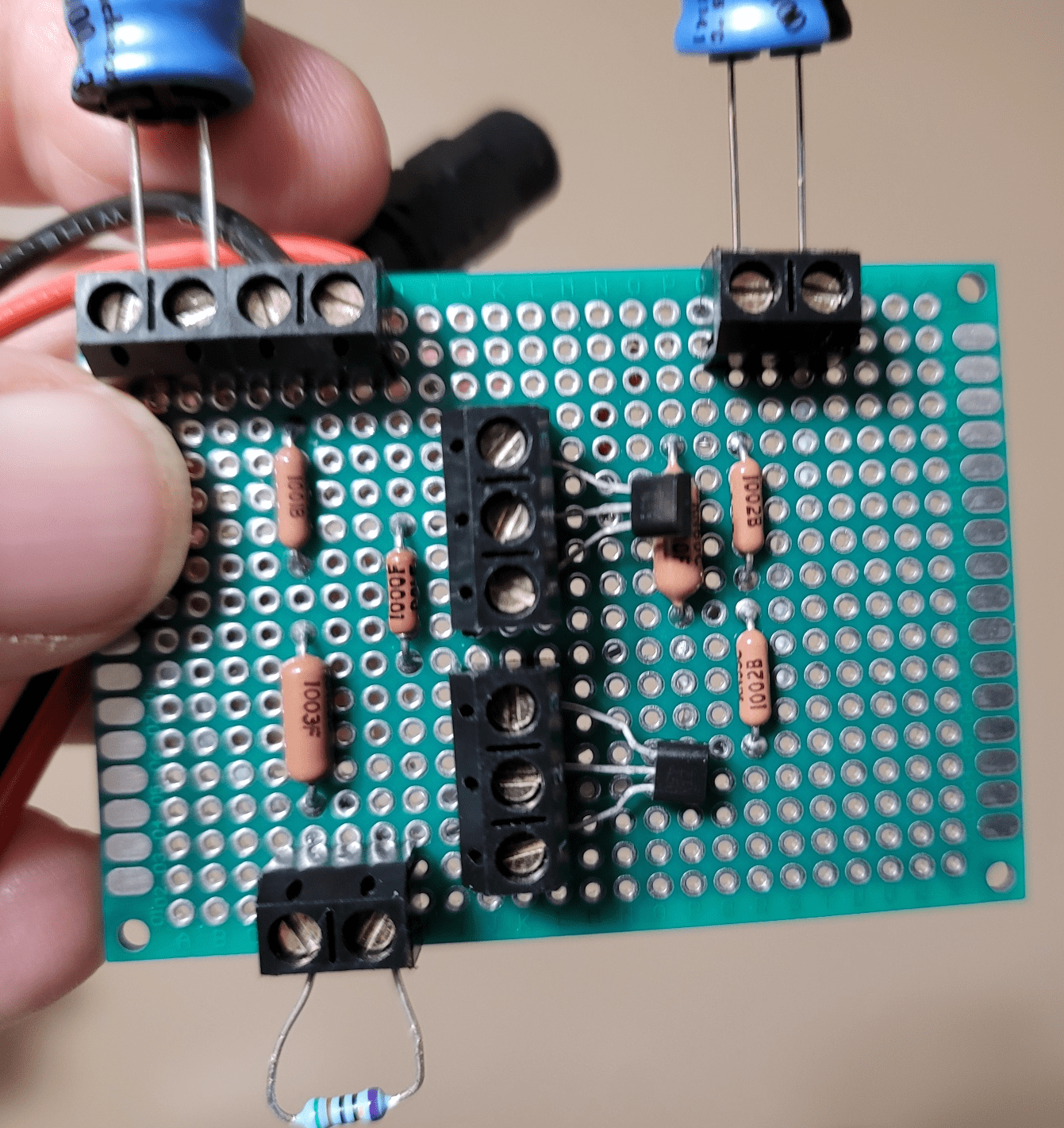

Odd aproach.
Like buying a high performance car, replacing the big brakes with small ones, removing the high performance engine and replacing it with a lower-output motor, then measuring the poorer performance, and documenting it on the internet.
Might be more useful to the project to measure with the preamp and power supply built as designed, but measuring the differences with the range of different components suggested in the design - JFETs, op amps, etc.
Odd that you should take exception.
Using the experimental modules on the bench allows holding some variables constant while isolating other to observe their performance.
See the 1st Stage breadboard photo below.
Note that the capacitors can be quickly swapped out for others. The current through the breadboard can readily be changed by swapping out the load resistor. Also note that the Bipolar Junction Transistors can also easily be swapped out. I now have data for several NPN's.
The output stage breadboard will allow swapping Q9 and R27 in search of a distortion / noise sweet spot.
I do this for fun. Props to @wayne .

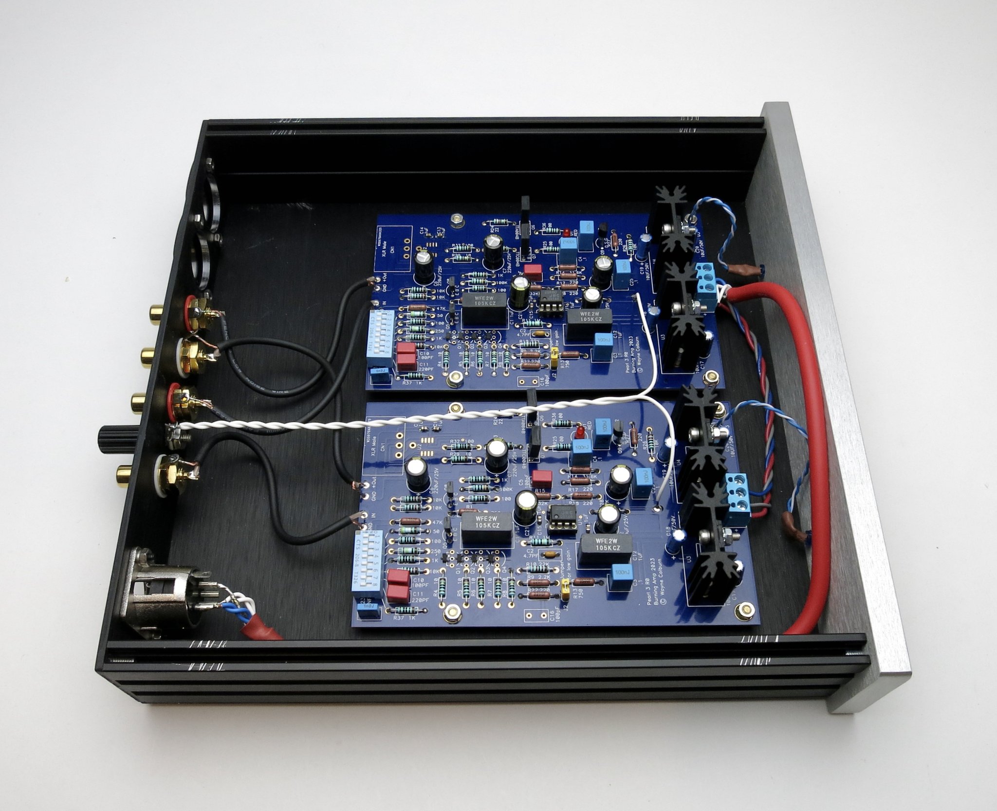

EDIT: This guide has been superseded by ver1.0b, see post #1020 https://www.diyaudio.com/community/threads/pearl-3-burning-amp-2023.404054/post-7533872
See the attached Pearl 3 Build Document.
This will be something that goes along with the illustrated, step-by-step build guide that Jim "6L6" is currently preparing.
Thanks again to Wayne for this design and the technical input on this document! Thank you to Jim and Greg "GKTAUDIO" for the collaboration and review of this document!!!
