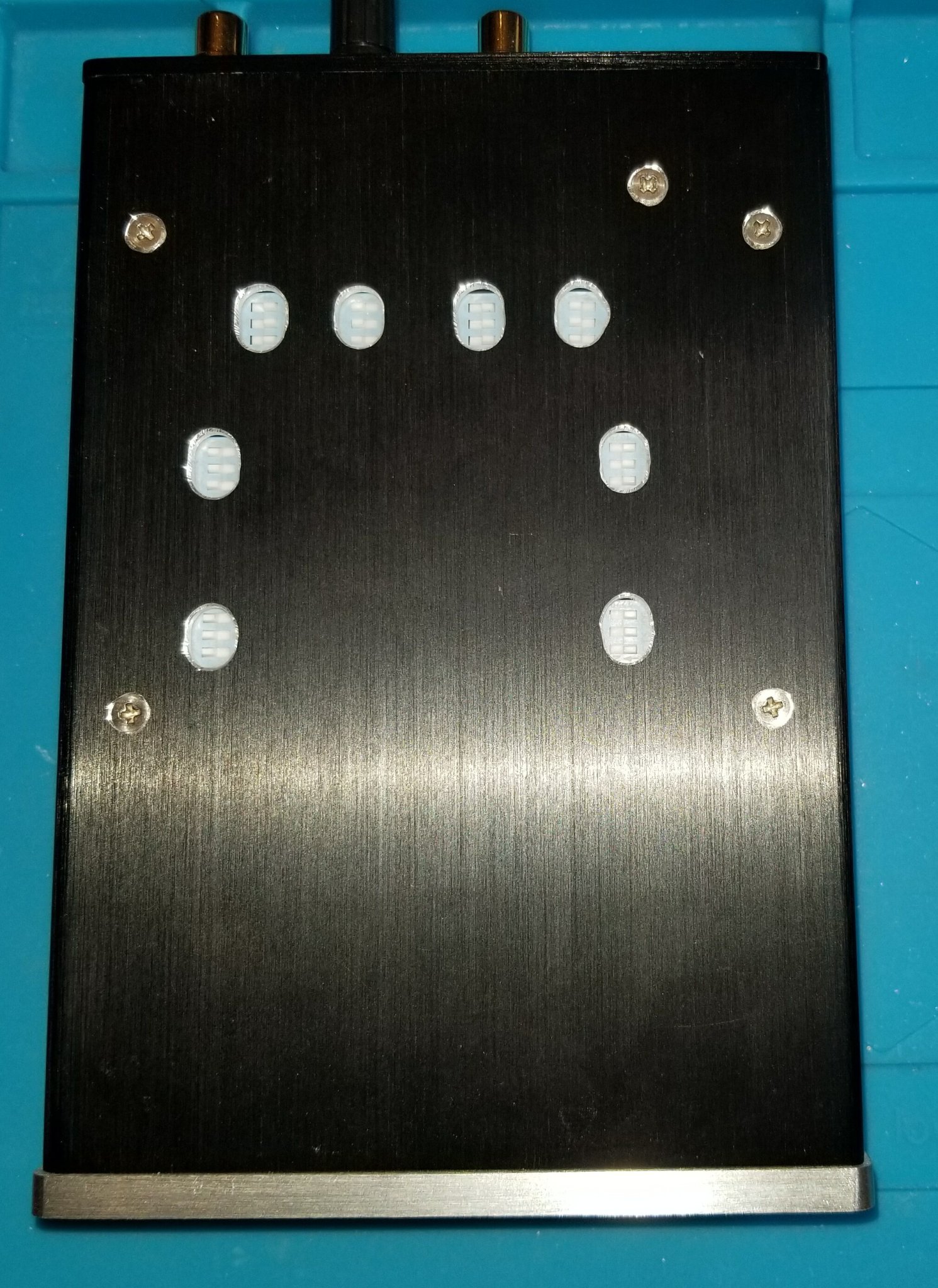

Or, you could cut holes in the bottom of the chassis and mount the DIP switches on the bottom of the PCB, like I did here.you could butt the pcb against the back panel and flip the cartridge loading 90 degrees
You can buy a 90 degree dip switch that fits right in there.If one is building their own chassis the way the 8 pin cartridge loading bus and inputs are arranged

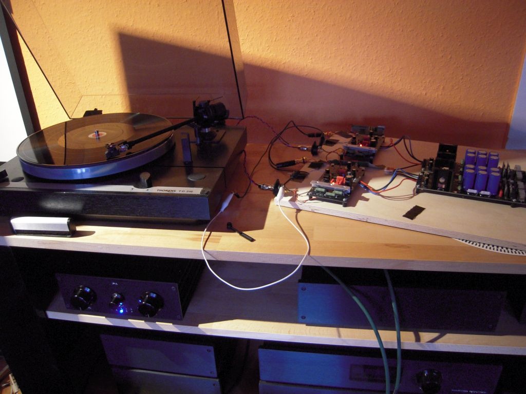

a first listening session with the PEARL 3... very promising. Testing if all values are in the ballpark.
Waiting for a lot of parts. But it plays.
Thorens (with Ortofon MM) - PEARL 3 - IronPre - 6-24AXO - BA-3 (bass/mid) - ACA-mini (high) into 2-way speakers

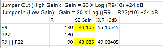

Yeah, but some cartridges are more like 7mV at 5cm/sec. That is 2V out (about the same as a cd player), but records can easily be cut louder, so 4V out is not out of the question with those cartridges. Ticks and pops will be even worse. Older integrated amps often had 150 or 250mV input sensitivity for full output.@Wellerman @MEPER
49db will be just fine. 5mv cartridge (0.005v) will be increased x282. .005*282=1.41v
That’s less than a CD player or modern DAC. If your preamp has any issues with that, there’s something wrong with it.
Current Accuphase pre-amps have input sensitivity of 250 mV. You might not overdrive them with 4V in (6V specified as max) but not comfortable for regulating volume. Personal preference, others might feel different.
P3 could be made an "MM only riaa" by selecting appropriate feedback resistors (e.g. like 43 / 49 dB) for those only using MM cartridges.
Maybe some "tweaking" could make more gain settings possible or an easy way to swap out the feedback resistor.
I guess care should be taken to avoid bad contact to avoid open loop gain.
