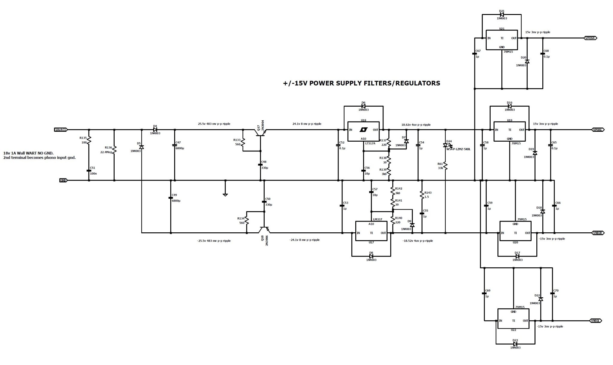

The Pearl 3 boards have LM7815/7915 fixed regulators to make a bipolar +15/GND/-15V DC power supply.
They need at least 2 volts more than their output on the input. 3 is better.
That makes the raw PSU voltage needed somewhere around 18V.
A 15VAC transformer will be enough as when you rectify AC to DC, you gain 40%, but lose two diode drops.
15 x 1.4 = 21v.
21V - 0.7 twice = about 19.6VDC
Good, that's enough. Could you use a transformer with more voltage? Yes. Watch your capacitor voltage rating, and you'll make more heat in the regulators, but the current is pretty low, so that's not all that much of an issue.
Now as for transformer size, which means current, little transformers, to put it politely, suck. They have very poor load regulation, and like to make more voltage than they are supposed to when lightly loaded. They also heat up and make too little voltage when heavily loaded. Could you use 6VA? Again, yes, that's enough current, as the total draw of two boards is about 120mA and the 6VA can supply 200mA, but do you really want that little overhead? It makes everything work harder as the small transformer will vary more with the load than a larger one.
The 15VA is large enough to be loafing, but not so large that it's going to spit buckets of excess magnetic noise where it's not wanted.
It also fits the nifty PCB that's included.

I remember that post. Good one. It started me thinking of using a pre-regulator on the external PSU to a achieve the voltage the Pearl would like to see to run cool.

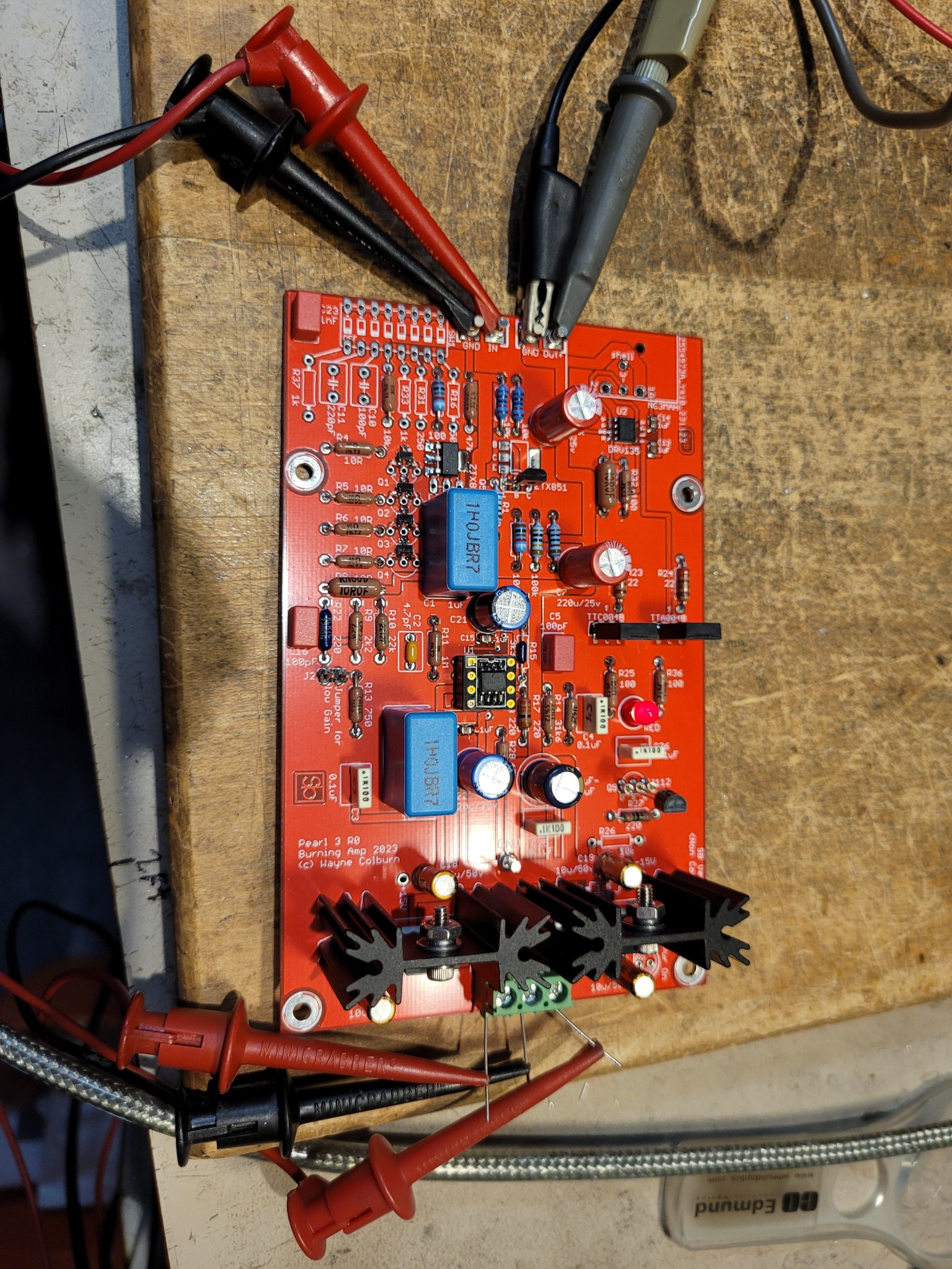

My prototype is working perfectly, it validates my PCB layout. I have the same volt readings as the original, as posted by 6L6. No DC offset at the output.
I'm using 2SK209GR JFET, and also confirmed that my pcb is compatible with the smd version or TO92 of the ZTX851.
Now time to assemble the UDP3 supply...
