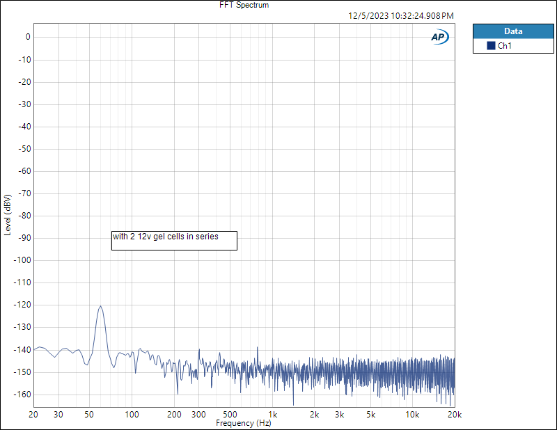

Perhaps the AC line harmonics will disappear on the FFT?
I have a couple of 12V 12Ah gel cells hear. I will top them off with the little charger for a couple of hours.
Same set up as before except with 2 12v batteries in series.
The cap multiplier and cascode NPN transistors are very quiet.
The KA7815 also looks quiet as well.
The noise floor is ~10dB higher with the batteries. Needs a closer look see as to why. Edit: see the added corrected plot below.
looks like the power cords need to be shielded.
Leakage is still unknown.

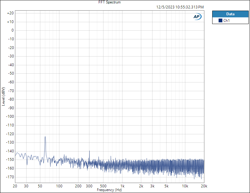

Thanks DT
Oops I used the wrong Bandwidth
this is the corrected one

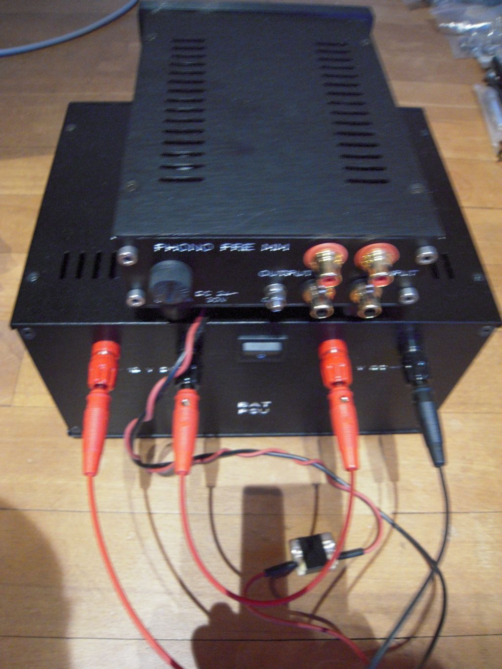

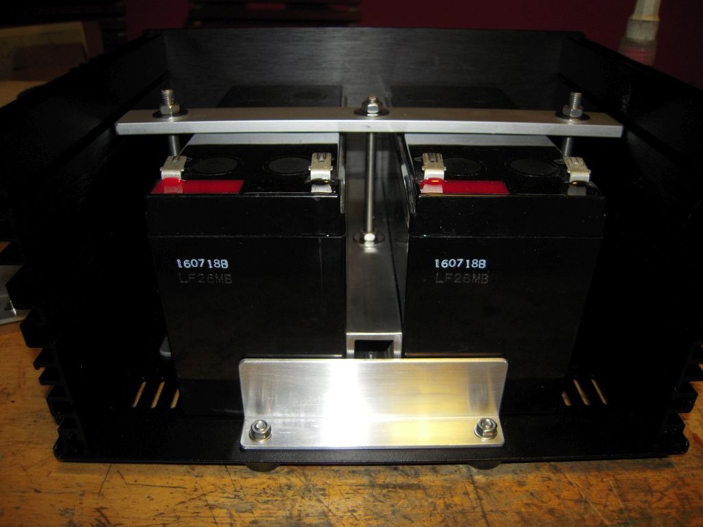

Hello DualTriode,
I have also built a MM-phonopre with battery-PSU (2 x 12 V Panasonic Gelcells). The batteries are in series, so 24 V DC. It is not a Pearl. I've got very good results (noise and sound).
Your measurement in #927 is done with batteries? Where does that 60Hz-peak come from?
Could be from a PSU in the measurement setup? Below -140dB is extremely low noise - I would say.

Hey Dirk, Nice work.
The measurement in post 927 is with 2 12volt batteries in series followed by a KA7815 regulator into a breadboard of the P3 input stage with a 1K resistor in place where the jfets would be. The output to the analyzer input is at the collector of Q5.
This plot is a peak at the noise level of the P3 input stage.
Next is to inject ripple across the BW to measure PSRR.
The spike at 60Hz is likely do to leakage, with the analyzer input shorted the 60Hz "peek" is all but absent.
Thanks DT

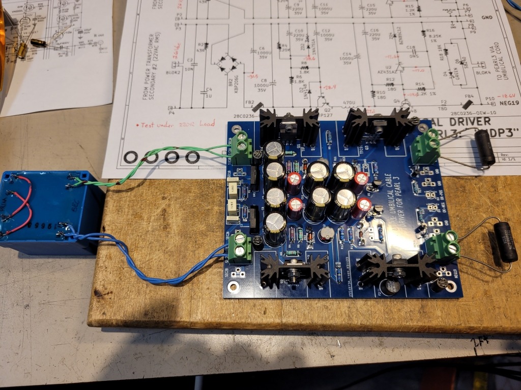

@Mark Johnson seems like @Algar_emi is more brave than me 😉UDP3 Prototype up and running perfectly. Time to complete the othe Pearl3 PCB...
SB
If anyone finds post #937 mystifying, it is an oblique reference to (this post) in which I confessed to extreme caution / lack of bravery, when AC mains connections are not fully insulated.
