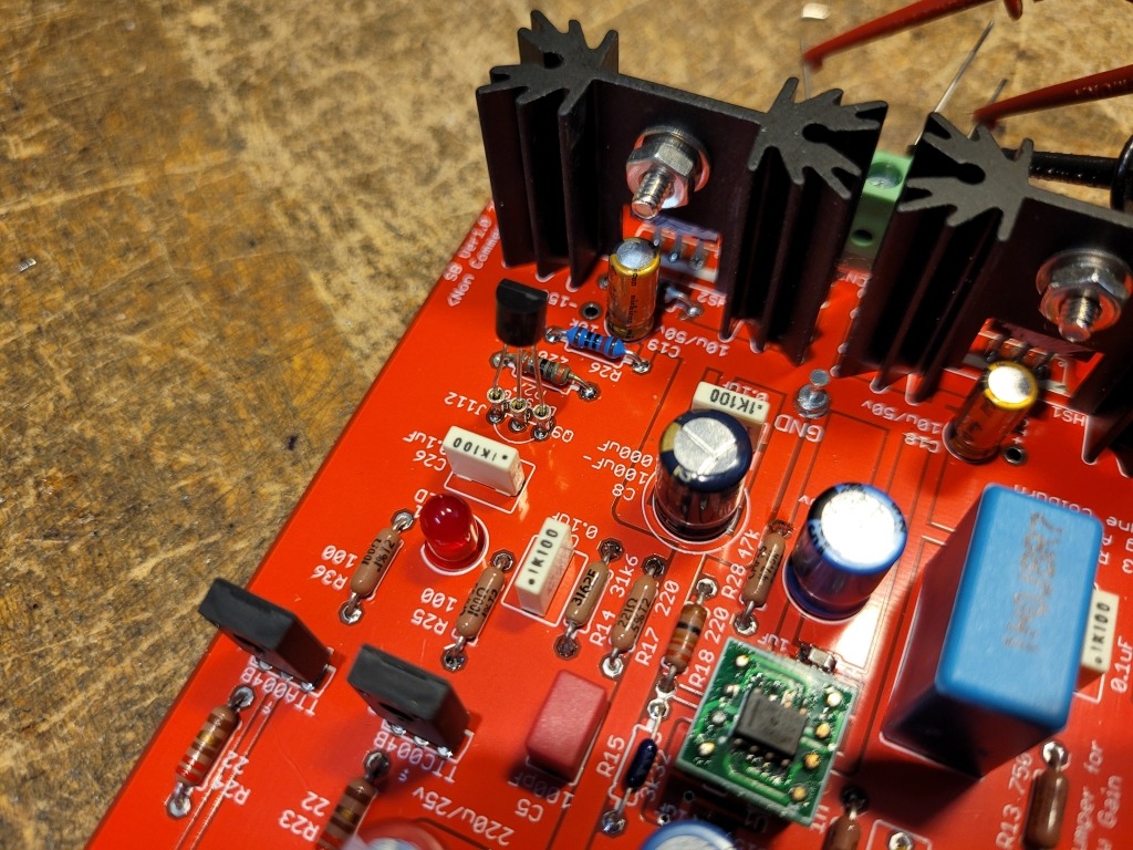

To match the J112 I didn't need any special jig, I matched them in circuit. On one PCB I installed socket pins for J112 (pins from IC socket), I insert the J112, measure the voltage accross R27 (220ohms), and select two JFET with the same voltage drop on R27. Most of the JFET I tested from my bag were pretty close to start with. Solder the other JFET on the PCB, left the pins on the first pcb. Easy
Hello Algar_emi,
this is how I did it too. I have changed my R27 on the boards from 220 Ohm to 470 Ohm to get the value 'into the range'.
I am slightly above 5.5 mA.
Wayne suggests 2 - 5 mA over R27.
Greets
Dirk

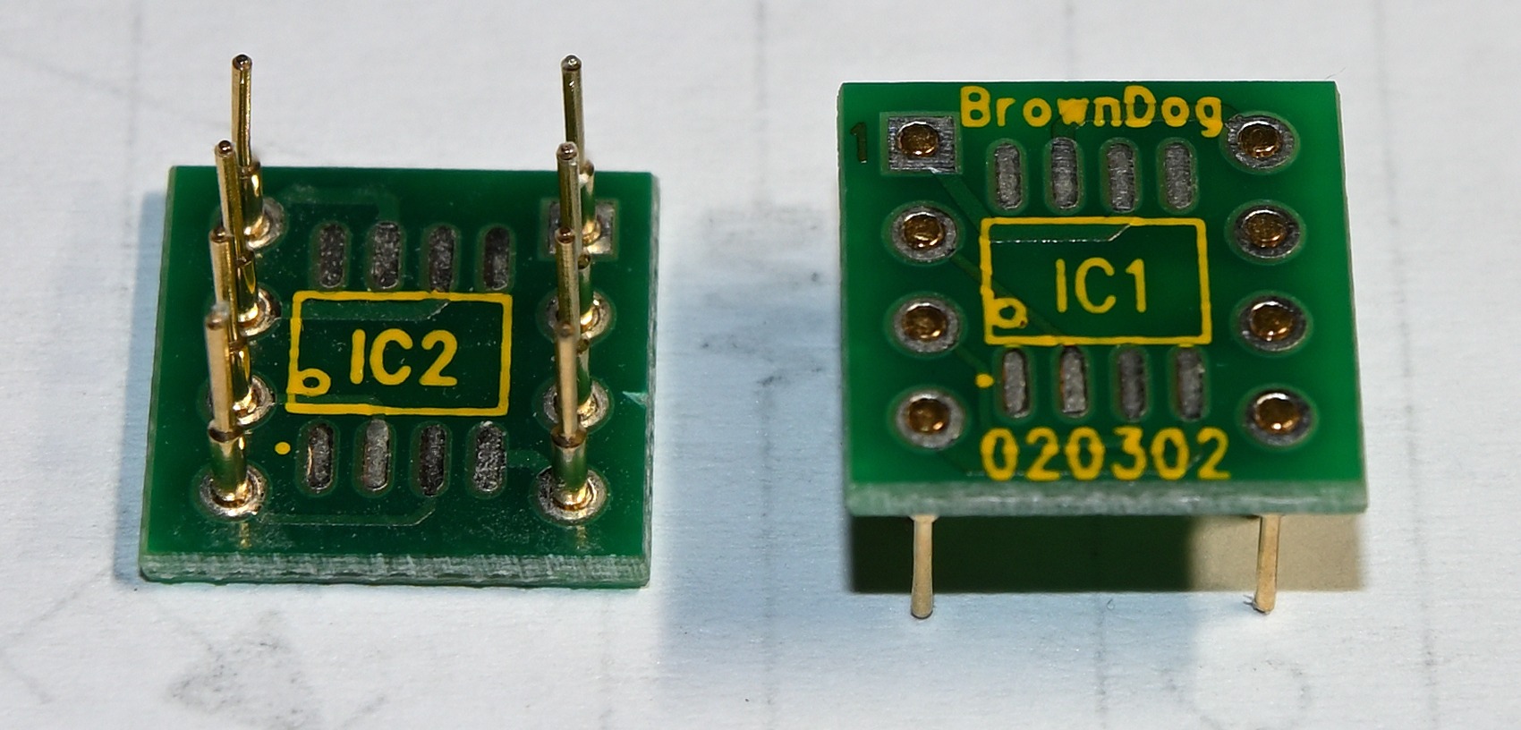

Huh. I might even have a couple OPA1612 in stock. I'll check out both of those - thank you.
I'm a dab hand at mounting SOIC to DIP adapters - did ca. 45 of them for several preamps recently.

There also exists those adapters which makes two single opamps to a dual dip8.I bet you'll enjoy OPA1612 (on SOIC to DIP adapter) and OPA2210 (on SOIC to DIP adapter).
(vendor suggestions)
_
I have some singles so I acquired some of these adapters. Then I found out that 4898-2 has equally good specs as the 4898-1. Then I just go with the dual type. I am not an "opamp rolling" person. I just want the P3 to be quiet with low distortion.
Yes, I'm rather the same. Once I hit the target, I am less interested in constant change. Unless it's making something new... 😉I am not an "opamp rolling" person. I just want the P3 to be quiet with low distortion.
