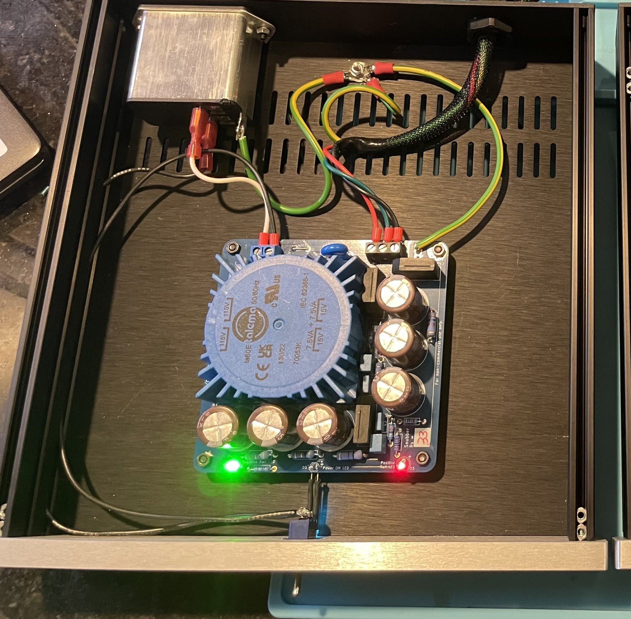

OK, more subjective observations...
The Pearl 3 as configured now sounds a bit better than my re-capped Threshold FET Ten/PE phono preamp and larger power supply I built for it. A bit more detail, a little more emphasis in the bass frequencies, more gain which my cartridge likes.
So, probably not surprising that a new design with new production components might sound better than something 35 years old, but the Threshold is still a pretty special preamp.

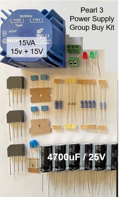

Pearl 3 Power Supply Parts Kit Group Buy Announcement
For those of you planning to order a Pearl 3 kit, I'm offering a group buy for a power supply parts kit to help your build.
I don't know exactly when the Pearl 3 kits will be available in the store, so I took a guess on the date for the Group Buy. See the thread linked below and add your name if interested.
For clarity - the kit you see in Post #985 contains the Pearl 3 PCB's, Power Supply PCB, and Pearl 3 board stuffings. This group buy is for the power supply board stuffings including transformer, resistors, caps, bridges, LEDs, and terminal blocks. This power supply works for 120VAC and 240VAC.
https://www.diyaudio.com/community/threads/gb-pearl-3-phono-crcrc-power-supply-parts-kit.406461/

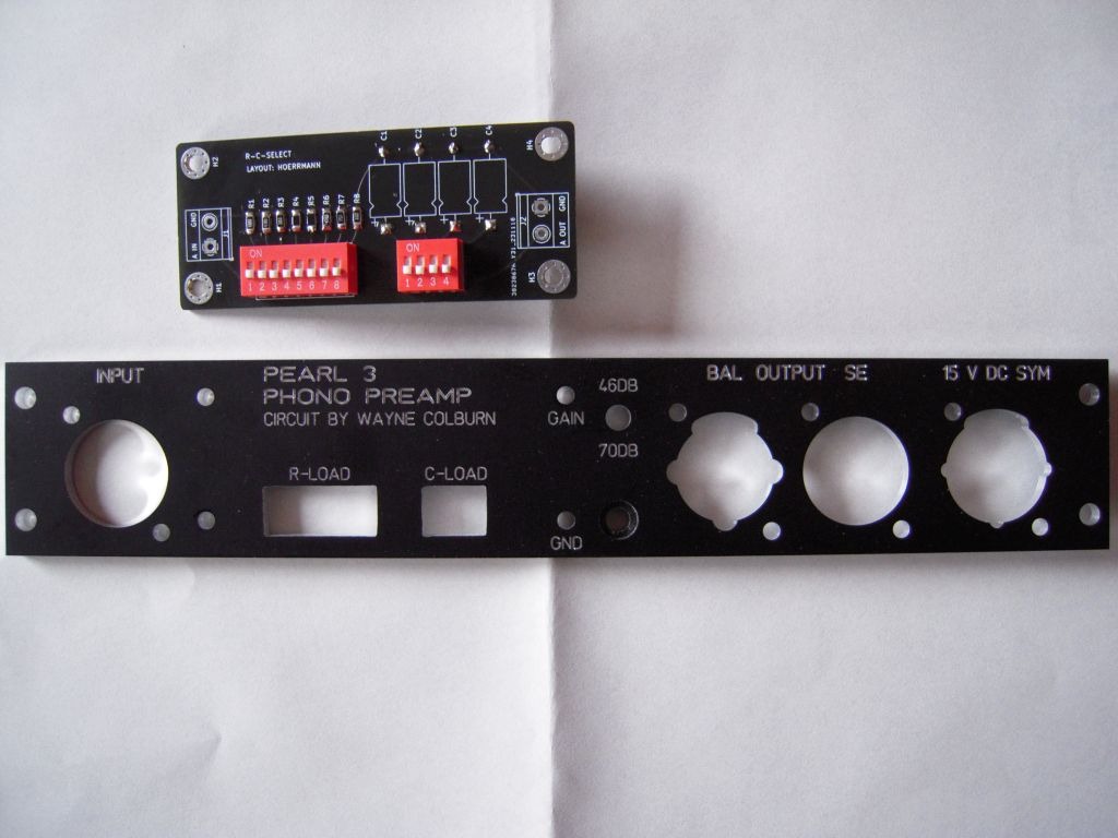

Well,
I have the PCB's from Burning Amp and more than enough parts, including 8 2Sk170 BL's that clock in at 6.7ma Idss each. I am estimating that these jfets will settle in at near 3ma each as installed in the Pearl 3.
The op-amp will be a OPA1656. I do not see much advantage for a socket to roll op-amps.
Warming up the soldering tool to begin stuffing.
Thanks DT
