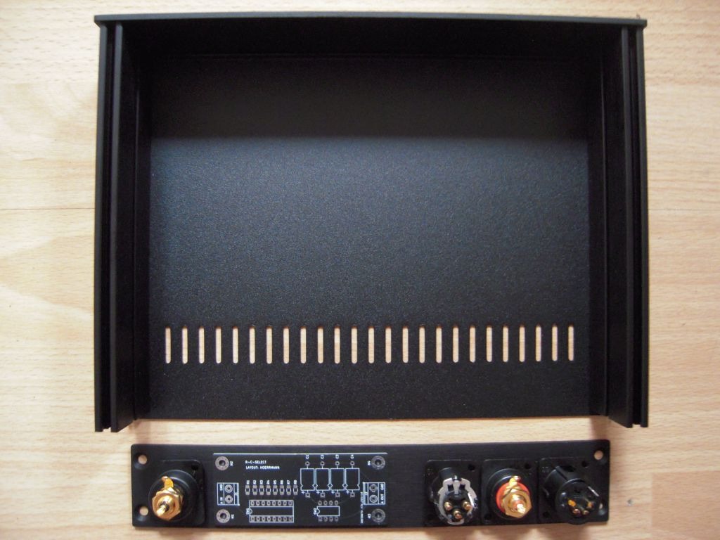

Super! Definitely interested 😃The chassis set will be available, and soon. Not sure if directly from Gianluca only or stocked in the diyAudio store as well, but here's the overall look - (please note these are the prototypes, and these same chassis will be in the build guide. The biggest difference is production will have steel top and bottom panels, as it is better shielding.)
If you have interest in this chassis set, please say so in this thread.
Cost is not finalized and still to be determined, but somewhere in the vicinity of 200EUR, most likely less. Of course this does not include the jacks, plugs, and such.

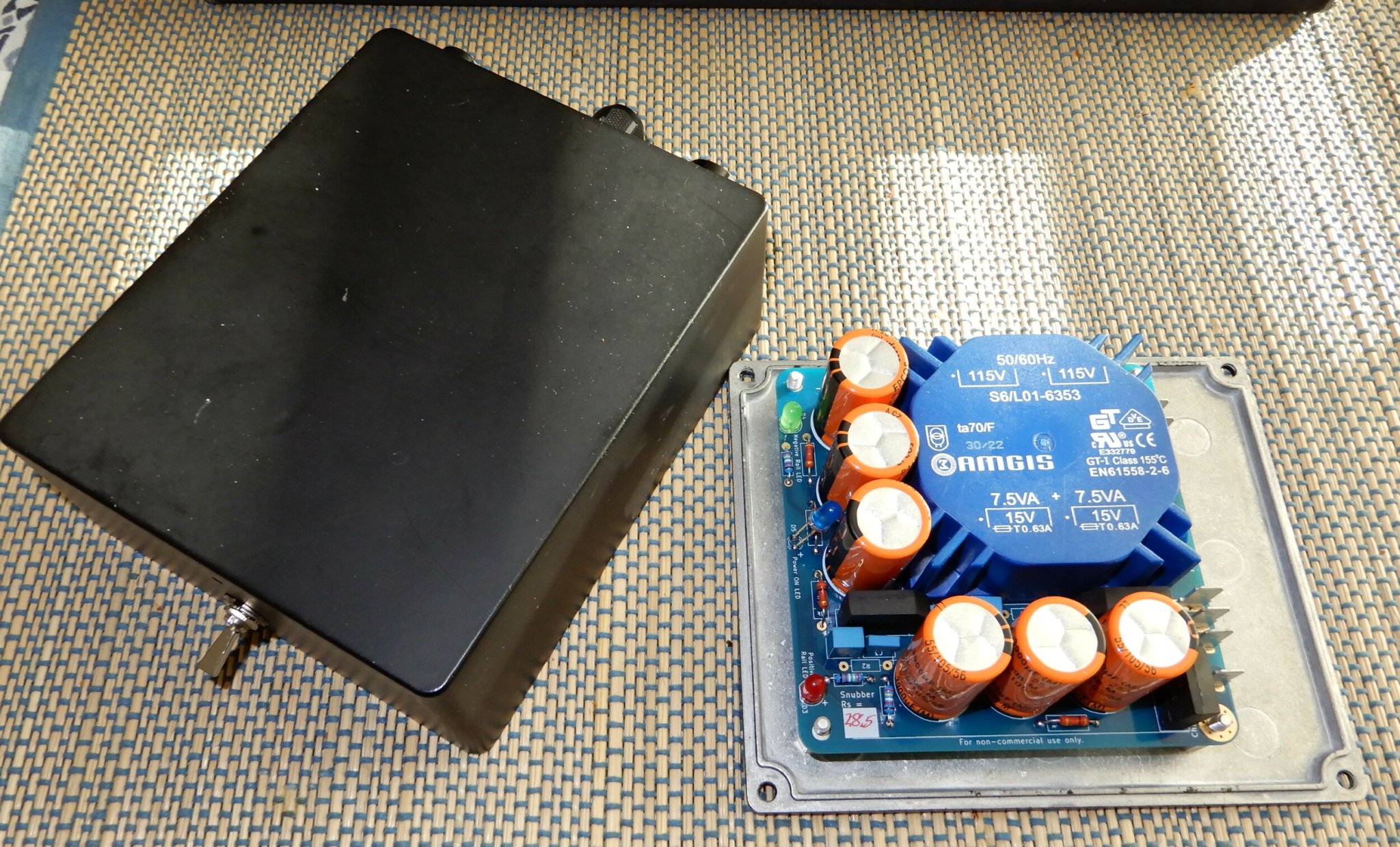

I neglected to express my appreciation to @wayne for his wonderful design, and for making this project available to us all. We're always so fortunate to have skilled professionals creating cool projects for us to build and enjoy. Also, thank you Wayne, for sending me the single board to make up my pair, and for continuing to provide input as this project develops.
What is particularly interesting about this phono preamp is the flexibility - the ability to select among a wide variety of active devices. It's also a really, really nice sounding phono preamp. I've got maybe 8-9 different phono preamps, a couple of head amps, several SUTs, and all have their strengths and some have weaknesses. After using this in its temporary chassis for 5 hours yesterday, even with a non-optimal power supply, I can say it sounds as good as my best phono preamps.
The only modification I made was to install a trimmer in place of R27, since I couldn't get the bias voltage to be identical between both boards with fixed resistors on hand. There is no point in taking any performance measurements until it is installed in its dedicated enclosure, but I will do so if only to get more practice with measurements!
The power supply board is now complete except for adding the snubber resistor as measured with Quasimodo, moving the blue power on LED to the front of the enclosure and completing assembly.

I don't think it's important to match the JFET CCS currents (Q9 / R27) and seemingly, neither does Wayne C. However if you wish to gild the lily, it's your set of boards and you can build them however you want. Nobody else gets a vote.

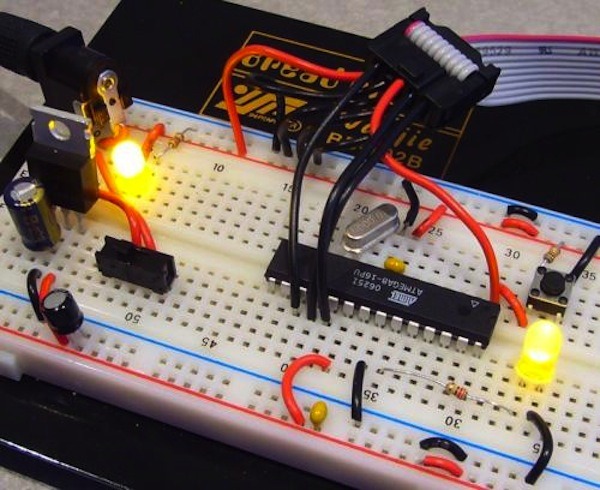

I guess you could use a solderless breadboard and some pluggy wires to make a little homebrew jig. It measures the constant current of a J112 JFET and a 220 ohm source resistor (same CCS circuit as Q9 and R27). Then grab your stash of J112s and measure the CCS value of each one, in your jig. Writing down the measured values of course. When all done, choose two J112s that give the most tightly matched constant current sources. Use those two J112s in your Pearl 3.

Thank you, Mark - that is actually what I had intended to do, after I order some more J112s. Of course, I have a stash of 50 J113s, but any J112s? Ha.🙄
