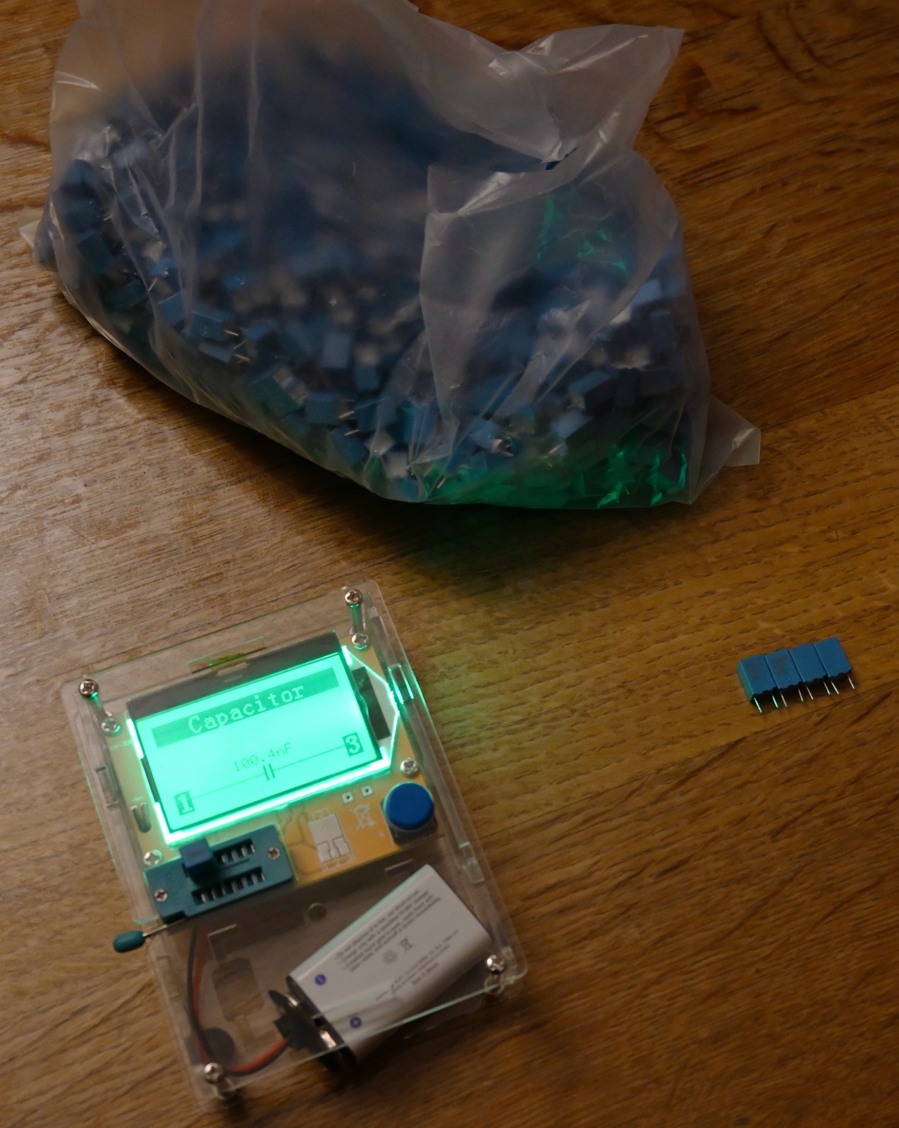

I received my bag of 1000 pcs KEMET 100nF (+- 5% tolerance) and was looking forward to a relaxing evening with screening / measuring a batch of caps for P3 that was within -+1%.
The problem is that they seems to be manufactured too accurate as first 10 measured were all in between 99.5 - 100.5 nF.
So what to do now with rest of caps?
Ok....I could continue and get some within 99.8 - 100.2 nF.
When I do repeated readings (which I do) it can vary a little.
I think with this equipment it will make no sense to try to measure more accurate.

I wonder if the pictured "tool" is what 6L6 call a Mega328 ?

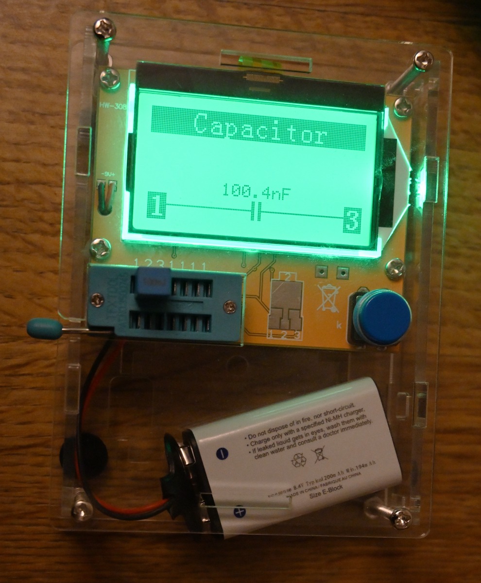

The tester showed only shows capacitance. I have another of the cheap gadgets with also shows ESR, a loss factor etc.

The pictured tester is very easy and fast to use. The 5mm pitch fits perfect in the test socket.

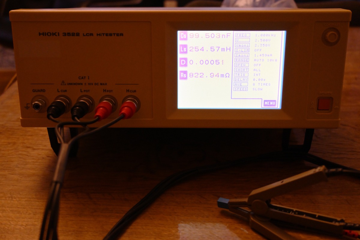

Yes, the HIOKI has only 4 x BNC input and the only probe I have for it is the Kelvin probe.

As the cheap tester shows values just below and just above 100 nF I suspect it to be accurate.

I performed a control measurement using the HIOKI using the famous Kelvin probes.
It showed 99.5 nF where the tester used above showed values from 99.2 - 99.6 nF (this tester measures continuously).
A DMM I have showed just 98 nF on all the caps I have tested so far.
A MK-168 transistor tester showed 97.x nF (this tester also a cheap gadget).
I will use the first one I used with easy test socket and take some reading and use an average.

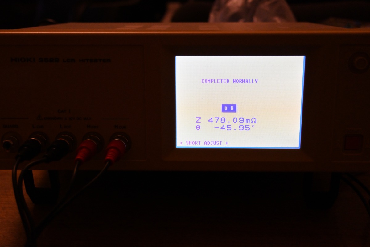

Yes, I did a short circuit calibration but it did not change much. The test freq. above was 1 kHz.

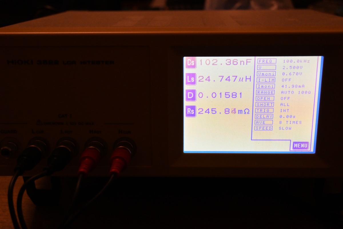

Just to finish this in this thread. Couple of images added (calibration short result, 400 Hz result (Ls = 1.6H, 100 kHz result, Ls = 25uH).
As can be seen the Ls (series inductance) varies a lot with frequency. So it is good I know it is a small cap.
Probably if I read (and understand) the documentation of the unit I will have the answer.
