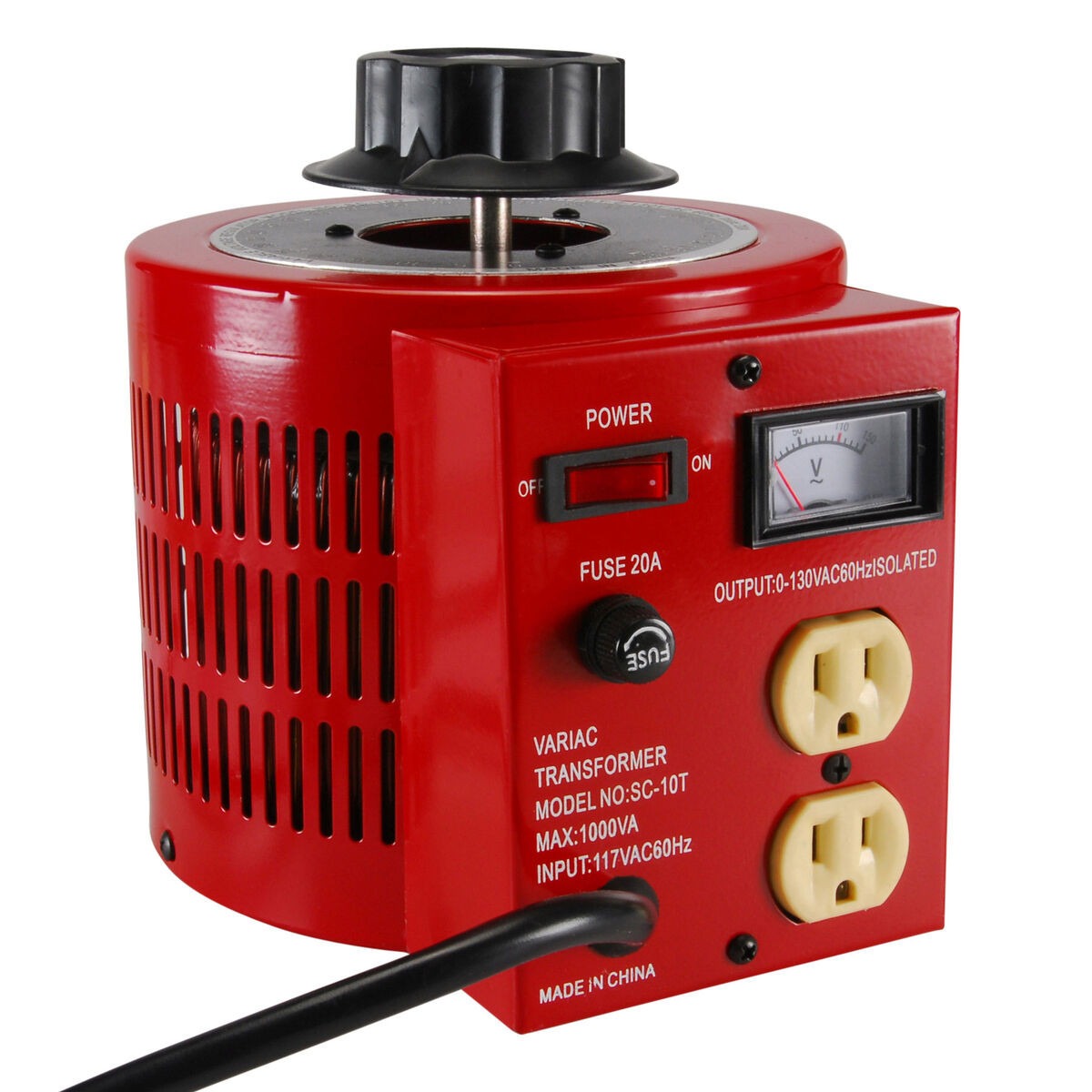

It's a simple and straightforward experiment to set up. Just install a variac between the AC mains and your Pearl 3 power cord. Dial it down until you've got only 17 volts applied to the input of the LM7815 voltage regulator ICs. Then listen or measure, and evaluate Pearl 3 when the regulator's Vin-Vout is 2 volts. Now dial the variac up until you've got 21 volts applied to the input of the LM7815 voltage regulator ICs. Listen and/or measure again, and evaluate Pearl 3 when the regulator's Vin-Vout is 6 volts.
Easy!
