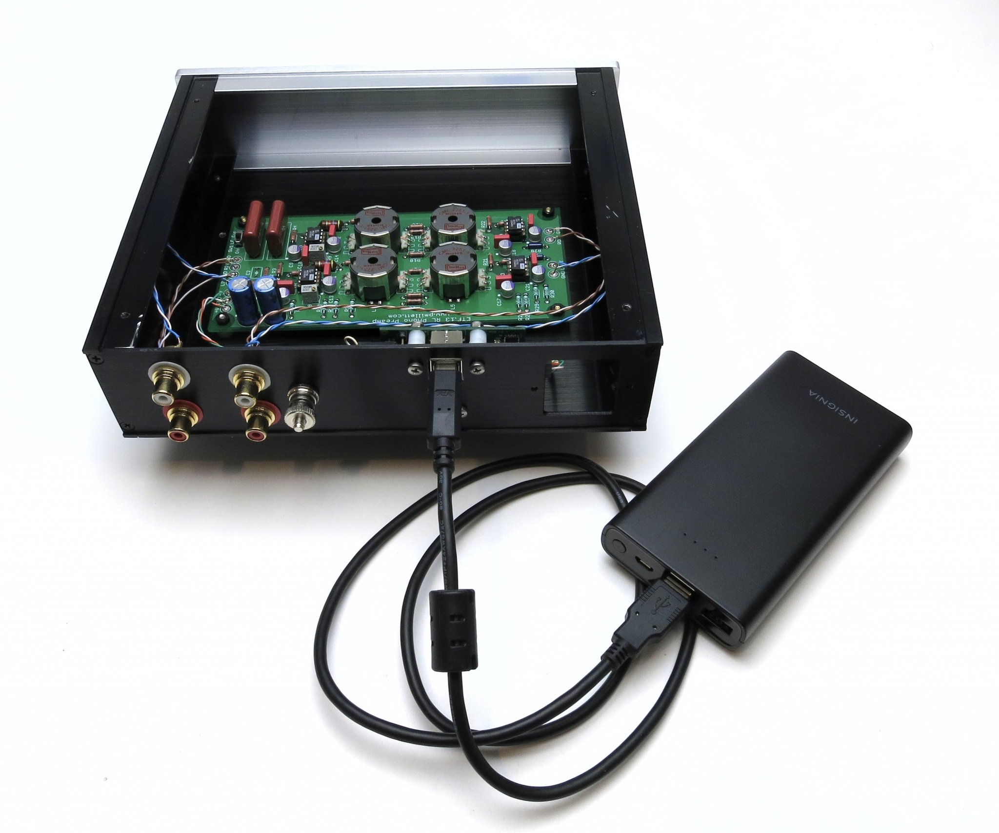

I have not tried Silent Switcher yet with Pearl 3. I have used it with the Pete Millett @pmillett LR phono, http://www.pmillett.com/LR_phono.html and it’s amazingly quiet, the SS is powered from a USB battery pack. Photo attached.
When I build Pearl 3 with Silent Switcher, the plan is to have it all in the same chassis.
If you used a USB brick to supply the SS I’m sure the normal admonition applies of keeping the power supply well away from the RIAA boards to minimize noise.

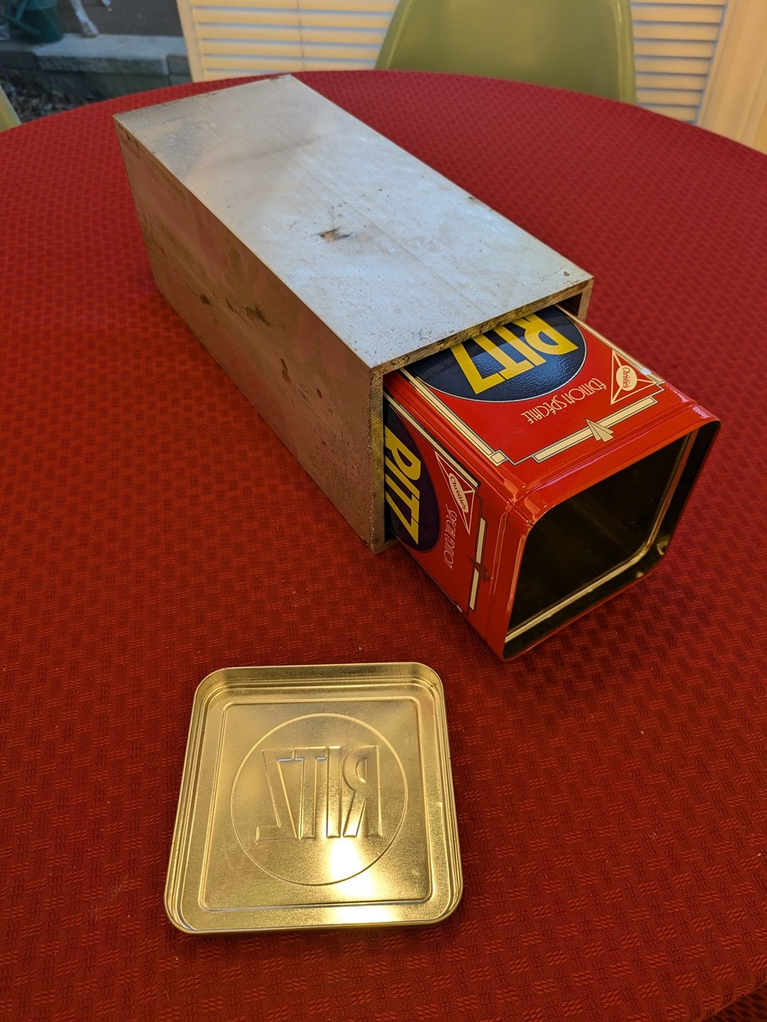

With respect to "Mains" interference (which is not noise, 50 or 60Hz) it's electromagnetic coupling AND all the harmonics of the line frequency. To a large extent you can mitigate this (somewhat) with a steel chassis, better yet, a Danish cookie tin inside a steel chassis. The steel chassis connected to the "Line Ground". I said mitigate, not eliminate!

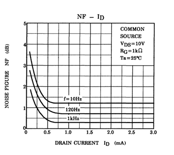

After reading the ApNote, you should be able to calculate Ein from NF using the following graph:
I see.... 2SK209 is actually a better part! I did some more research on LSK389

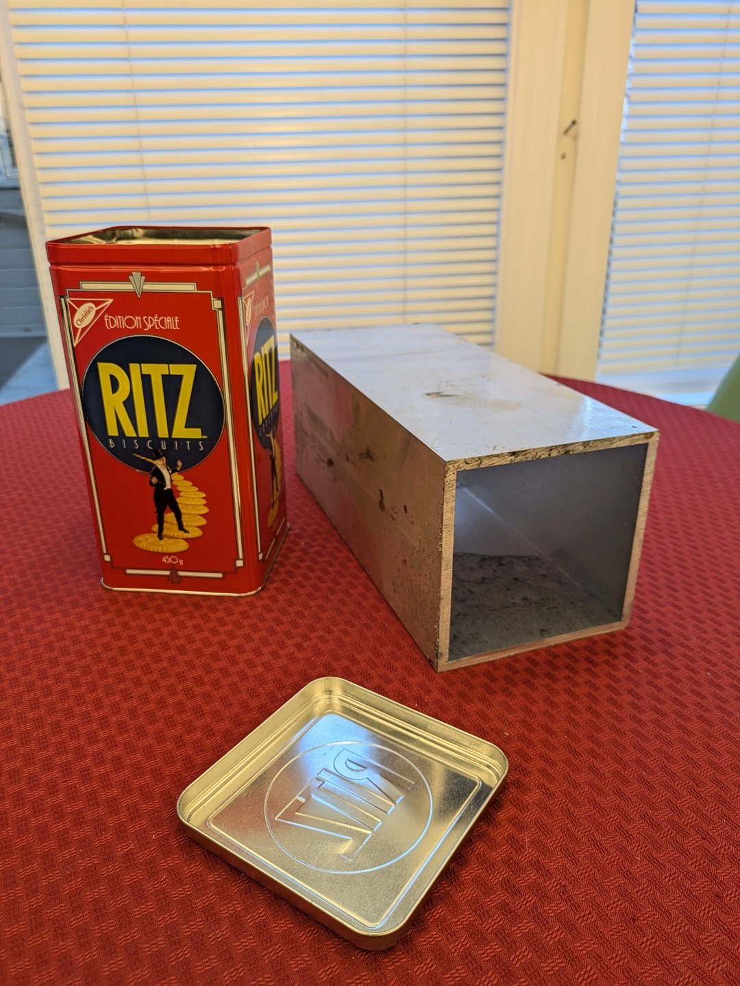

How about a Canadian cookie tin and a 1/4" thick Canadian aluminum extrusion?
While I began this project thinking about using a cookie tin that I had on hand when I happened on the 5" x 5" extrusion I've been leaning to using just the extrusion. Would it be better to stick with the original plan?
As the photo shows I can be flexible.
