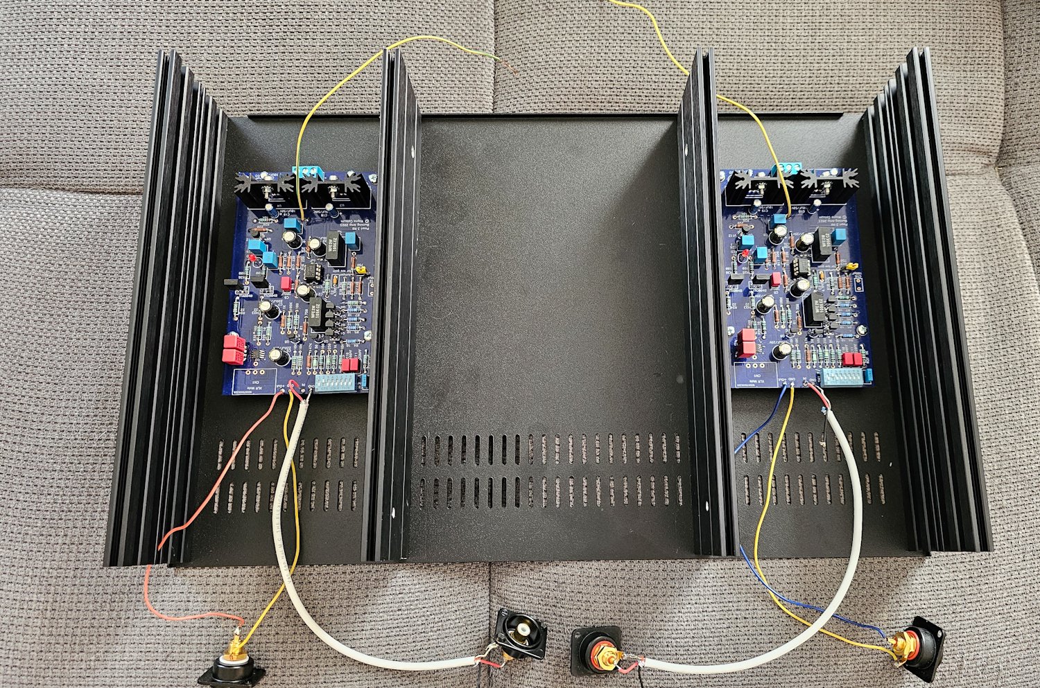

In the meantime, some progress with my Pearl 😀
Yes, PSUs in the middle, but - because I'm crazy - there will be two Toroidy supreme audio donuts...
Aluminum sides and dividers, iron top and bottom, aluminum front and rear plate.
I may cover the dividers and sides with iron plate too.
If you can, put the iron between PSU and RIAA, to contain the magnetics away from the RIAA.
