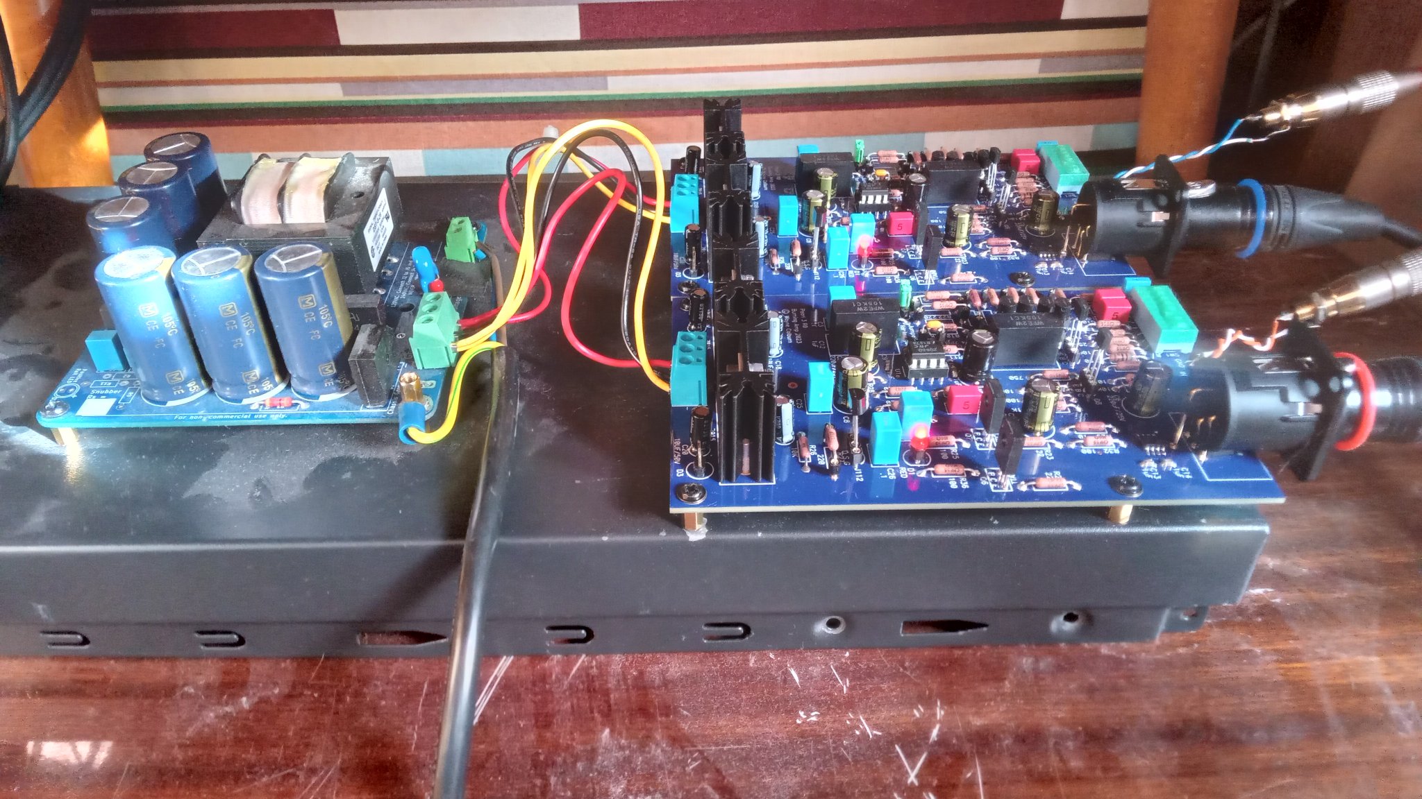

Pearl 3 Burning Amp 2023
Second Pearl 3 singing on the test bed.
Now this is my favourite, connected to ZM's Iron Pre Balanced, driving Aleph JZM.
Of course there are things must to do.
I don't know yet what will be with case.
I need to build another PS.
I need to bulid Mark Johnson's UDP3 Umbilical Cable Driver for Pearl 3 boards.
Without that Carl Zeiss I couldn't work with SMD.
It is just inconvenient to change glasses to it while working.

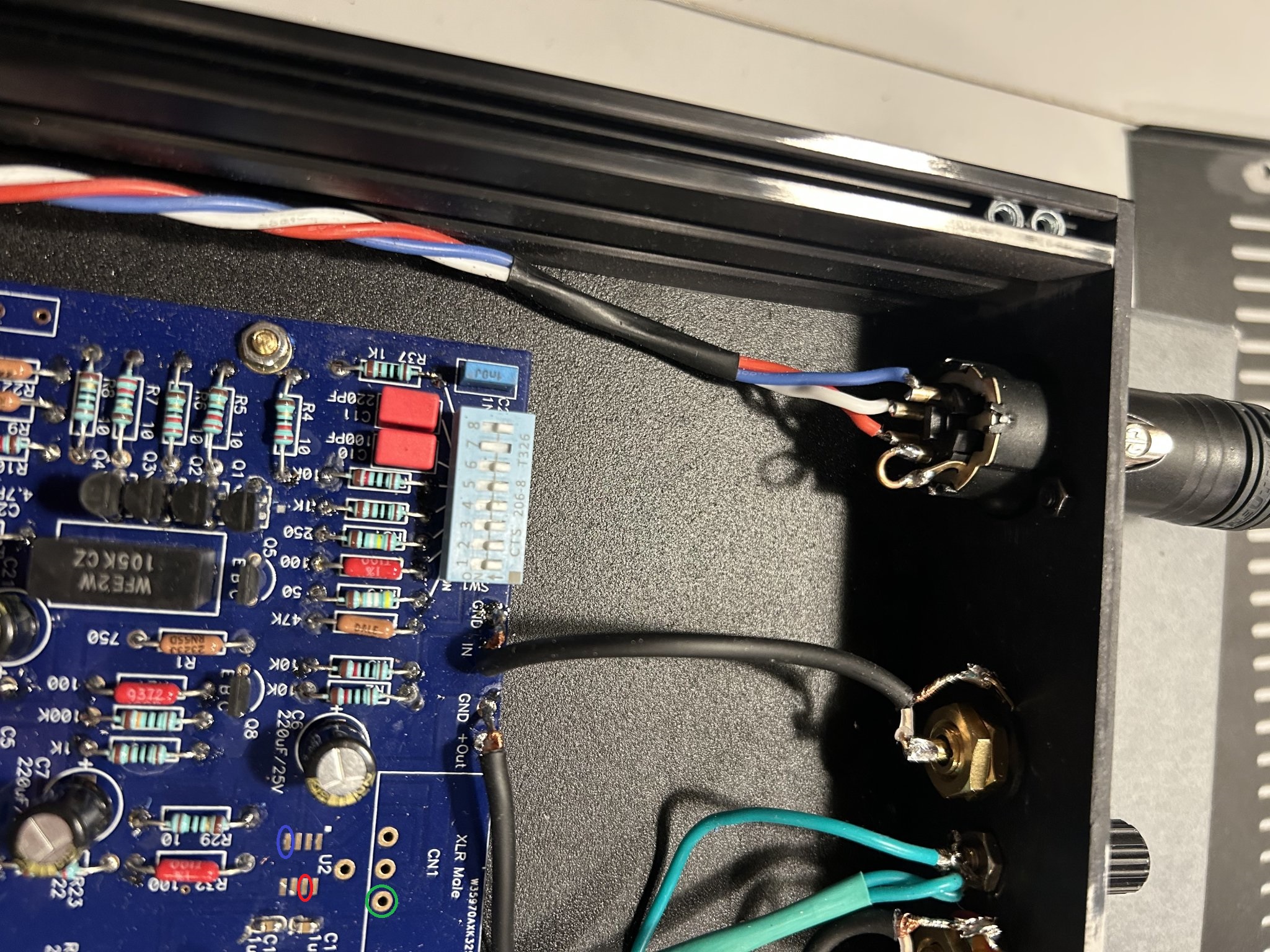

Between one of the legs of R19 (the one goes to the collector of Q8) and gnd you should get 15 volts.
Could you make a measurement?
So that measurement is even weirder: 6.5 on the left board, 6.8 on teh right. And I notice a very slight burning smell that seems to be coming from the phono side.
I'm afraid I've mucked this up substantially, and with this retreating eyesight, it may be hopeless.
Oh, that's bad. Could you make many-many pictures in good resolution, so that we can check every detail of your boards and parts, from both sides of both boards (separate posts for left and right)? This way we may find the issue(s). Further, I don't know how robust the 7815/7915 are, but due to the wrong polarity they may be toasted. But first things first - make many-many good pictures.
As you don't use U2, perhaps the safest way to check PSU voltages between U2-Pin4 -VDC, U2-Pin7 +VDC and XLR ground. see photo.
GyuriView attachment 1449486
Hi Gyuri, I get nada...zeros all the way. I'm going to pull this thing apart, go over every solder joint, and replace the 7815 s and 7915s that i probably frazzled. I do so appreciate the continued help from so many of you all, and I also look forward to hearing the Pearl 3 sometime before next winter.

in the disassembly process discovered yet another screw-up: one one board, I had TTA004B and TTC004B reversed...and backwards as well. So they're now in the trash, and another set on their way. Mouser just loves my ineptitude.
