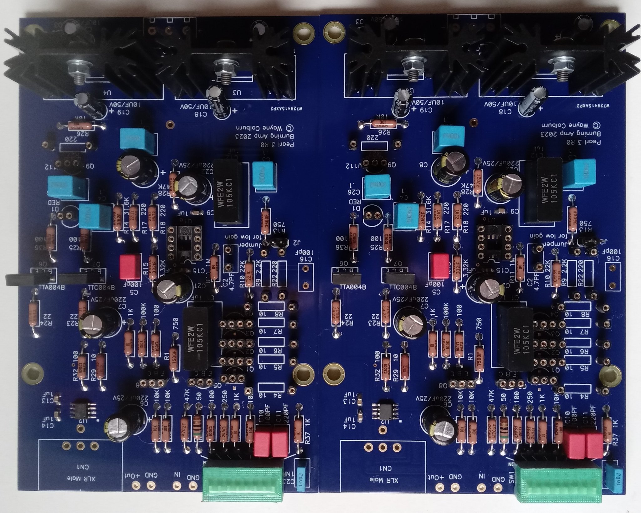

I use these routinely for building.
This way it's easier to repair, if something dies, it's most probably a semiconductor, so in this way no need to disassemble or solder.
But if I want to experiment with the components, that's easy too.
As I see attached photo, there is a mistake.
On right panel R32 is other way around.

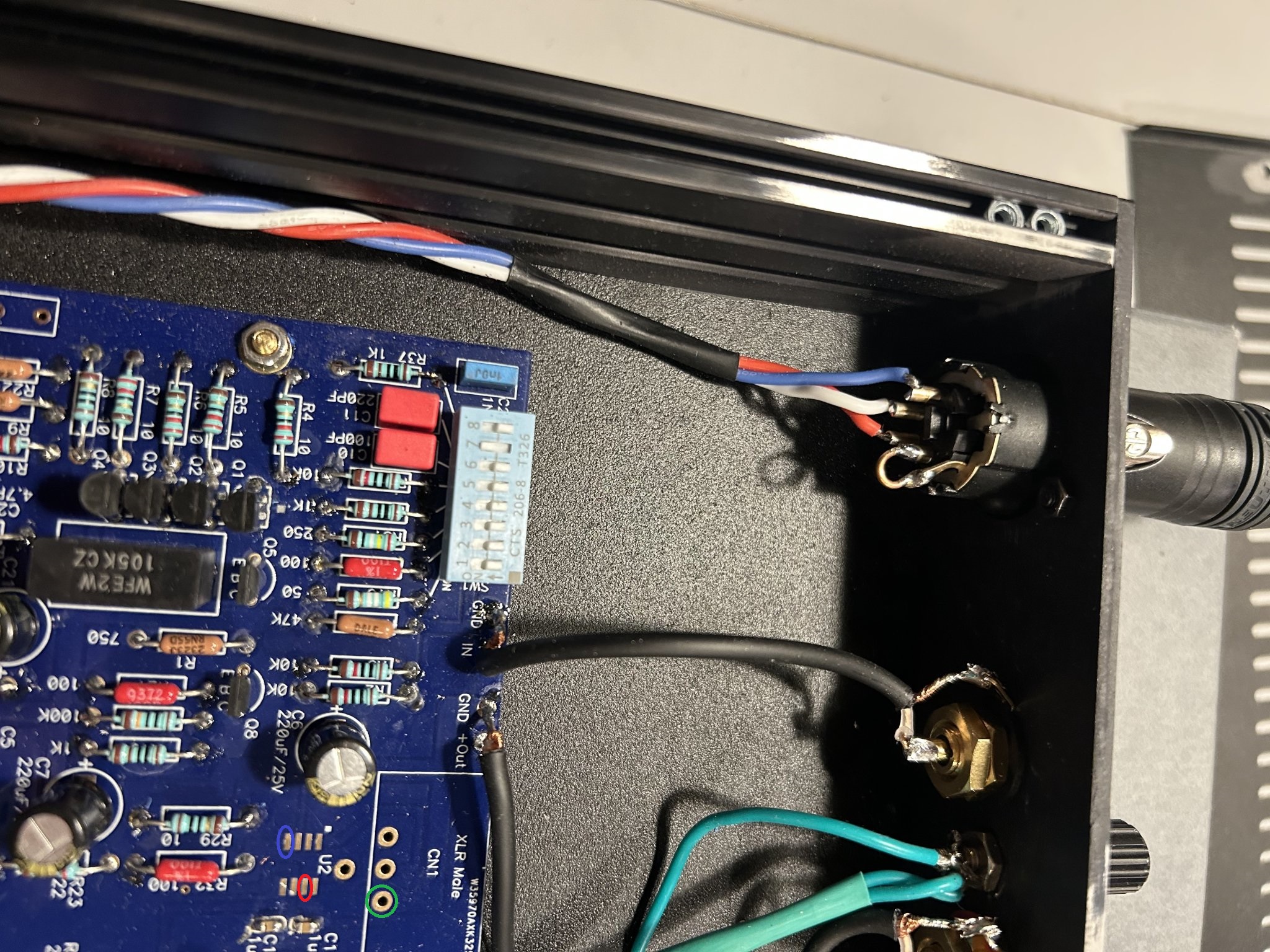

Good news (I think)
Previous measurements:18.6 at the positive, and 12.8 at the negative, both boards.
New measurements after fixing the mix-up between the 7815 and 7195: Left board: + 8.35, - 8.57; Right board +8.31, - 8.57.
R27 is now 2.41 on left, and 2.72 on right.
Thoughts?
Yeahh...... but obviously at the wrong places/measuring points.
Try to measure between pin 2 and pin 3 on the 7815, and between pin 1 and pin 3 on the 7915.
Waiting for the results 😉
Sorry...i was following NP's instructions for values, i think...though i must have misunderstood. Will give this another go tonight. As always, thanks for the support and the patience!
"... I just thought it would be safer not to perform the measurement on two pins that are only 2.5 mm or less apart...better not to risk a short circuit..."
Particularly since i can't even see 2.5 mm. What an S-show life is when vision fades. Still looking for the upside. Maybe it's that i have an excuse for poor spelling.
