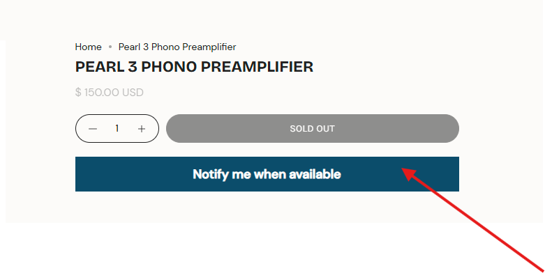

The Store has none. Any idea for how to get this? Ask Store or Wayne?
asked to be notified. The listening test by LeovD and others got me in 🙂 There is life there on the other end. At this moment my LP chain is virtually dead (input 2SK240 cascoded to ECC88// ; passive correction).

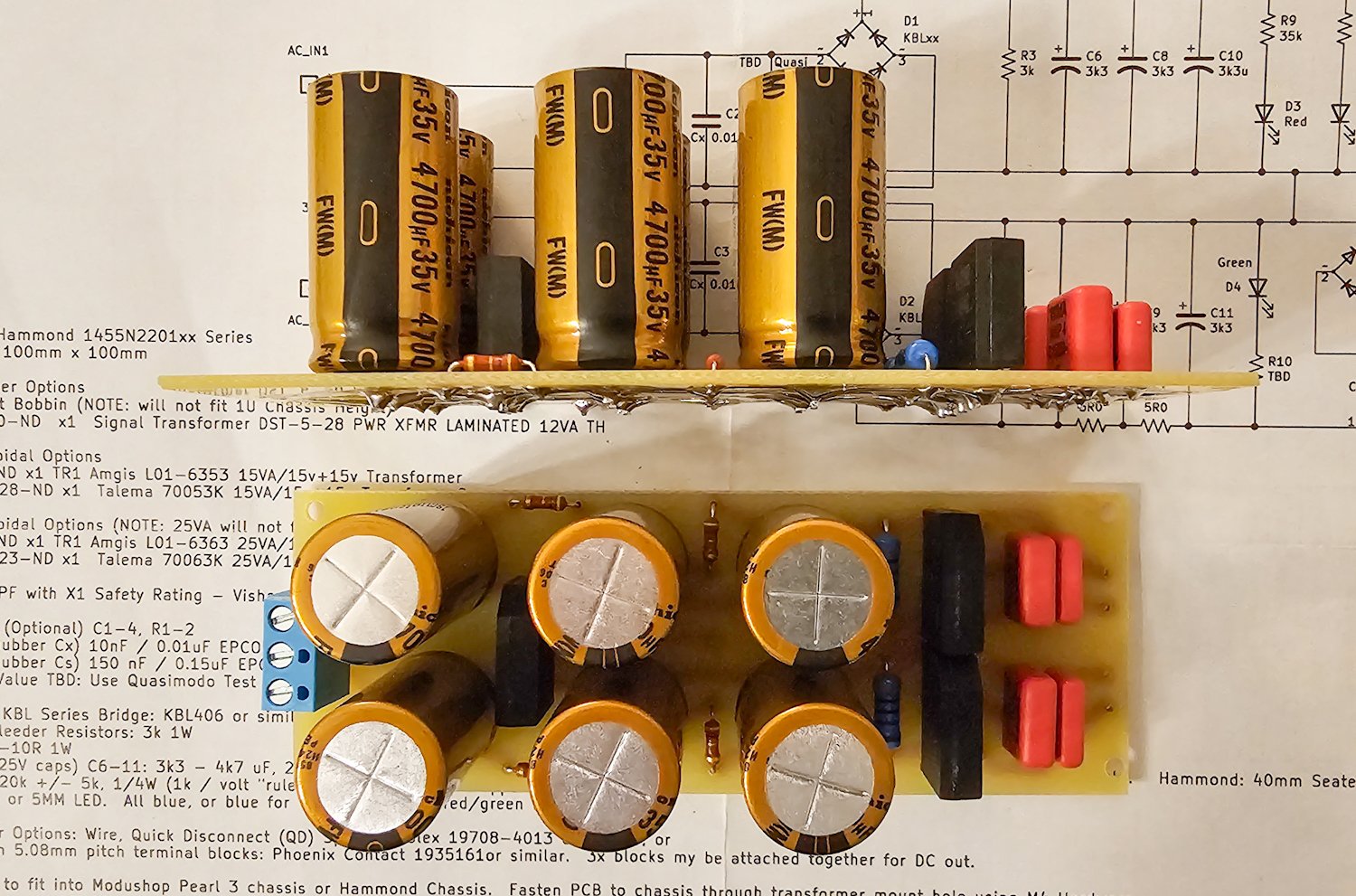

In the meantime, some progress. As I wrote, I will use Toroidy donuts and therefore I can't use the psu boards...
So I have to make my own PCBs 😀 I feel like I've gone back 30 years in time, but it's fun to draw PCBs and etch them with Fe(III)Cl
I know, old school, but hey, it's diy 😀
I know that
you can still wire 'em up to Randy's boards... he says so!
that said there is great satisfaction in designing and manufacturing your own boards. I've no intention of arguing you out of that joy.

It was a soothing finger exercise, PSU boards finished:
- Pearl 3 Burning Amp 2023
