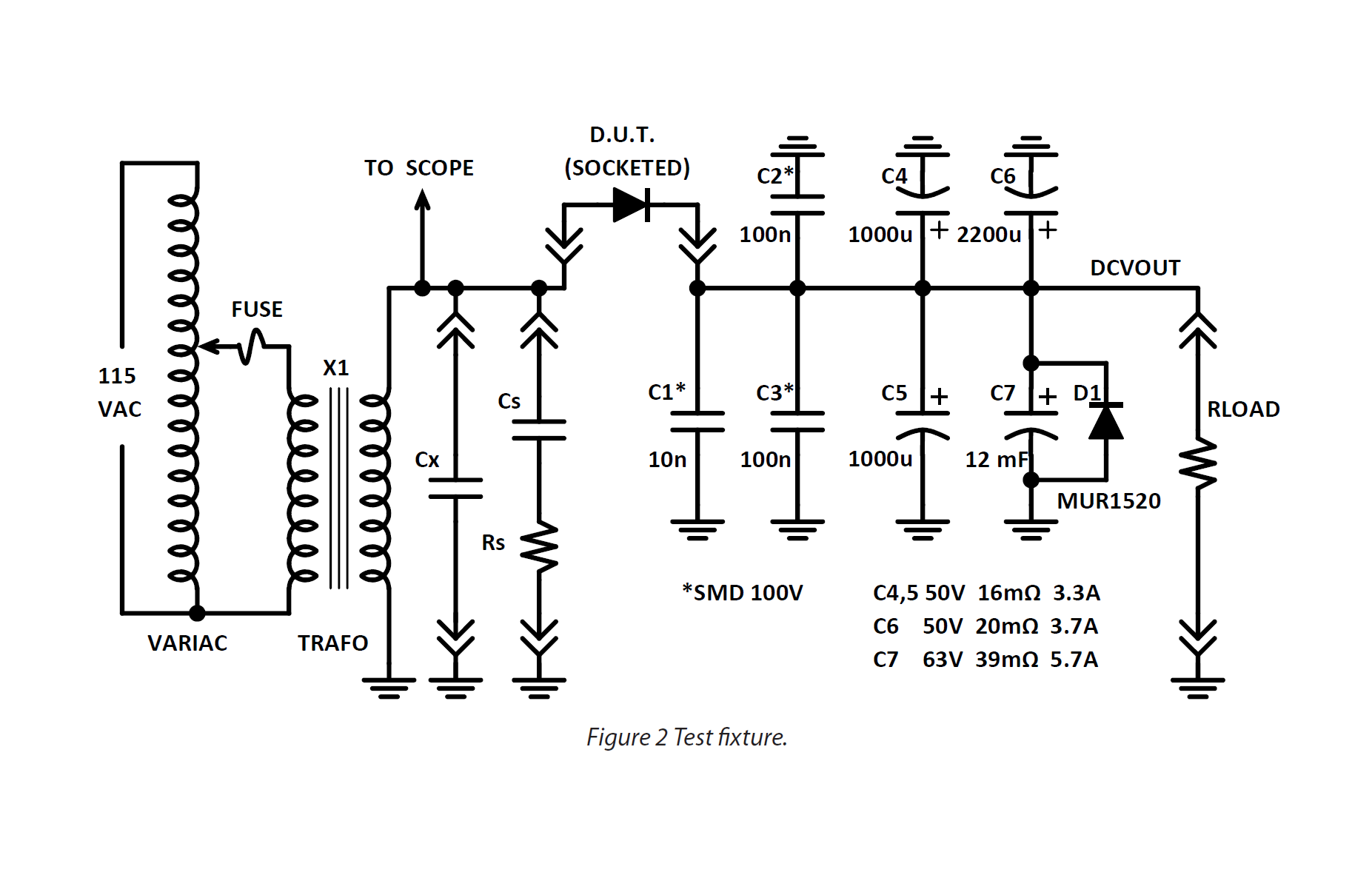

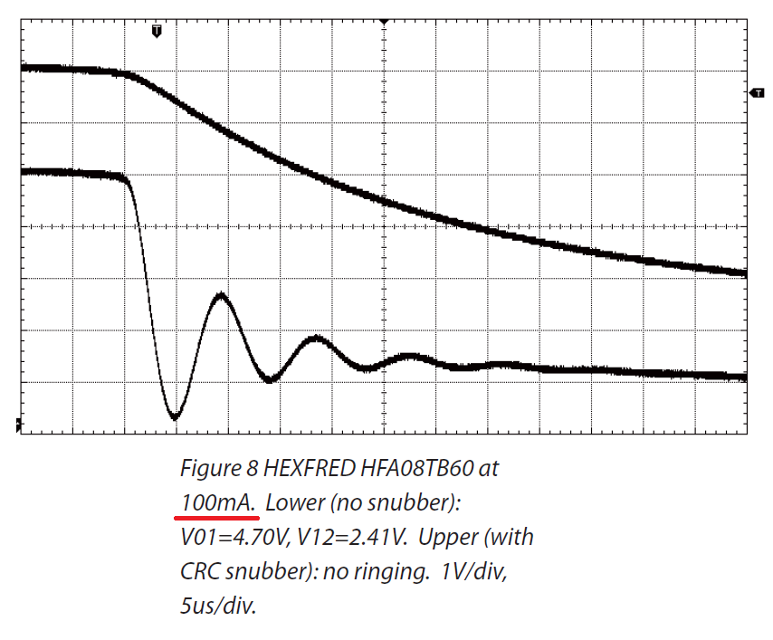

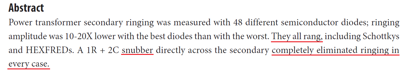

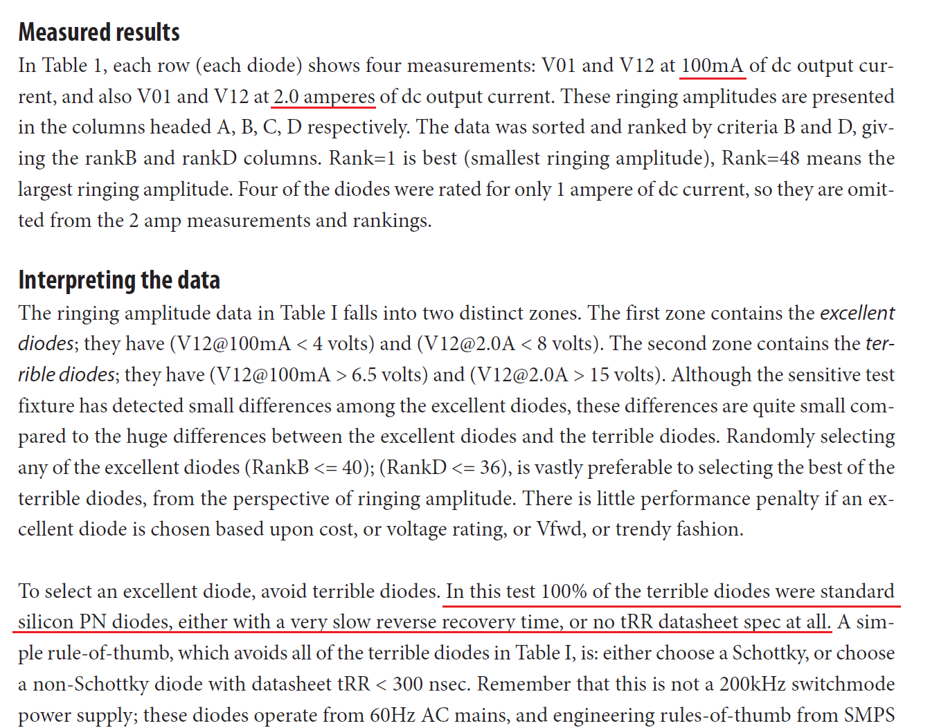

The article in Linear Audio magazine (R.I.P.) showed a lot of measured data with, and without, snubbers at 100mA of DC current -- relatively "low power" in audio equipment.
Four dozen different diodes were tested with the same transformer in the same fixture, and every single one of them stimulated the transformer secondary into oscillatory ringing. Adding a snubber completely eliminated ringing, every single time. I've attached one of the Figures from the article; with no snubber {lower trace} a HEXFRED diode provoked ringing, and the ringing completely disappeared {upper trace} when a snubber was added. This particular diode was ranked "excellent" at both 0.1A and 2.0A of DC current; yet it provoked oscillatory ringing. They all did; every last one of them.

The article I cite appears in Linear Audio volume 10 (pages 97-110) and the author is not Morgan Jones. Way back in volume 5, Jones's article dithers around with equivalent circuit models but makes very few actual time domain measurements on transformer+diode+cap+load, and shows no scope traces. The vol.10 article is full of measurements made on actual hardware -- crucially: with, and without, snubbers.
The advice to "sweep the broadcast band with an AM receiver" came originally from Rick Miller; and unfortunately it is misguided and not correct. Sadly, the AM broadcast band extends only from 565 kHz to 1605 kHz, but an actual real-world transformer secondary plus snubber resonant frequency is a factor of 5 lower, at 100 kHz, as can be seen in the attachment to post 5,604. 2 horizontal divisions per period, at 5 usec per division, equals 10 usec per period. Frequency = 1/1E-5 = 1E+5 = 100 kHz. Nothing for an AM radio to receive. I am surprised it didn't occur to you to make a quick check whether the wiggles were, or were not, within the AM band.
One nice feature of the LA volume 10 test fixture is: it's very easy to trigger an oscilloscope at just the right instant to capture the oscillatory ringing. Indirect measurements using radios or spectrum analyzers are unnecessary; you can capture the bell-ringing event itself, and the subsequent ring a ding ding, in the time domain. And display it on the scope, as exemplified in post 5,604.

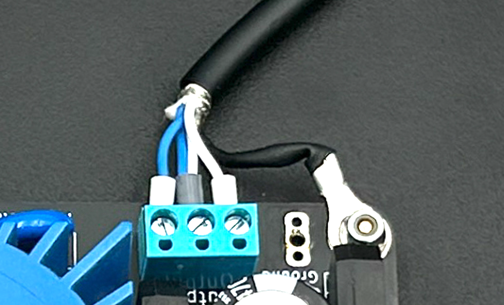

I am gathering parts for the Pearl 3. I have the same question MEPER had in an early post (and I don't see an answer): the umbilical cord between PSU and preamp boards is specified as three conductors + shield. Examples are Mogami W2549 and Carnae L-4E6S. The Mogami wire comes up as a two conductor plus shield. The Canare comes up as 4 conductor plus shield. Exactly what should I be sourcing here?

^ There are a number of options. Personally, I like the thickness / girth / substance of the L-4E6S, so that's what I (think I) used. The smaller 'microphone' cabling I had around didn't feel right to me for a power umbilical. No technical reason for my choice.
I used the shield as intended. I used one conductor each for + and - supplies, and I tied the other two conductors together for a 'lower resistance' GND. Not a lovely photo, but it may help. I'm not in any way implying I made the best choice, just illustrating one example that seems to have worked out OK.
@jminassi - I'm not sure. I'm not terribly picky. I've got a box with various cables, and I'm desperately trying to dwindle it down and not buy more wire / cable. I likely reached in and grabbed what looked like it would work.
IMO, any typical / flexible cable works. I did balanced outs, so I used 1 + shield and 2+ shield. It was most likely something like at Mogami 2552 (or maybe something thinner) and 2330. None of my build pics reveal the marks, and I don't have the P3 at hand.
