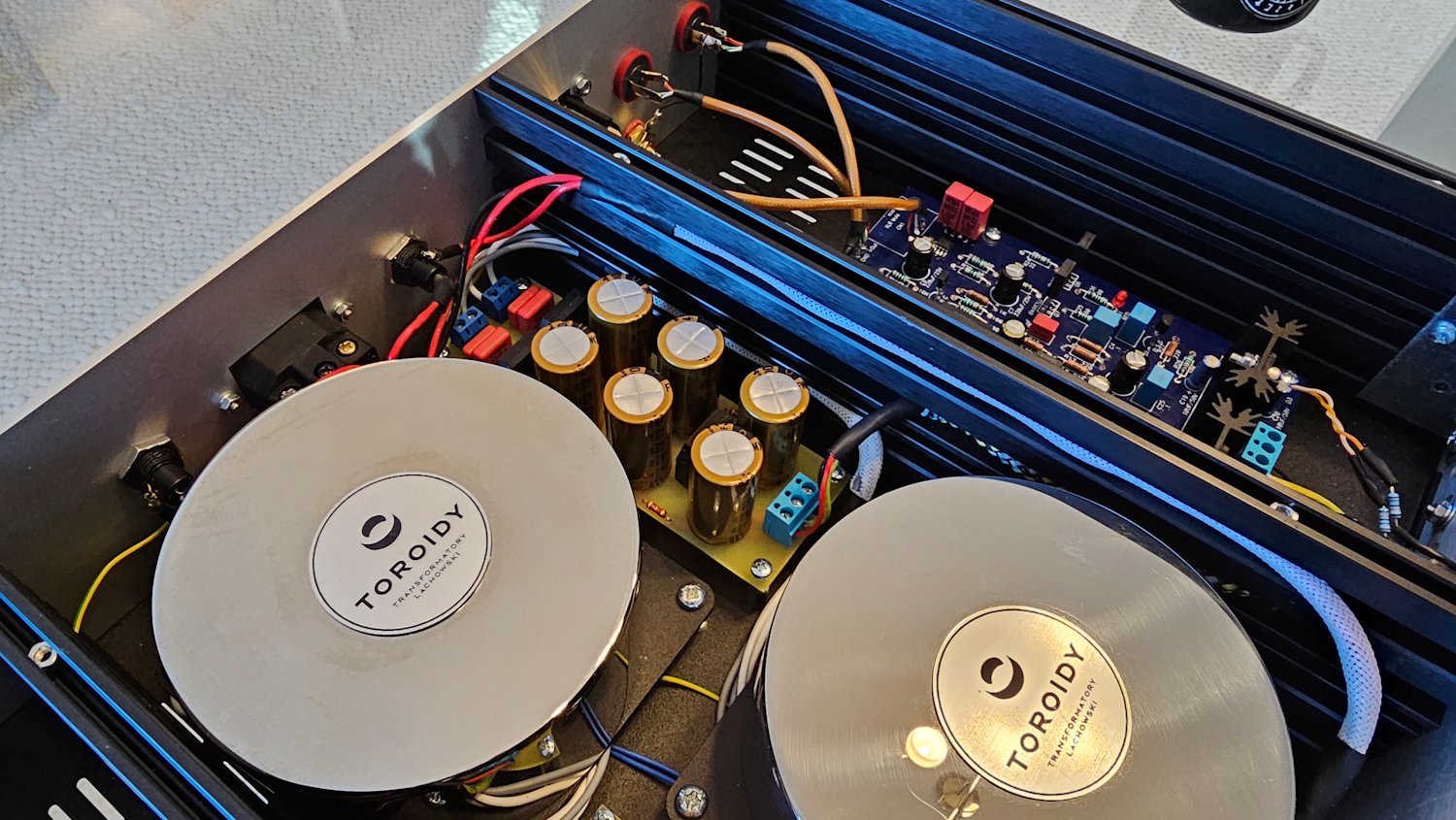

Good point! What's the thinking on galvanised steel enclosures (junction boxes)?the Pearl transformer won't be the only -- or most powerful -- transformer in a system. the closest (perhaps).
if you're going to add shielding perhaps enclosing the signal boards with a mild steel box is a better approach?
FWIW I think EMI rejection is important for these low-level circuits, so I'm looking at some form of Faraday cage for the boards. https://hollandshielding.com supply Mu-copper Faraday cases, but they're custom and expensive. They also have the same material as tape or sheet; maybe that's cheaper. Can anyone else suggest suppliers?
Magnetic shielding for the transformer; distance and either a case or a steel barrier.

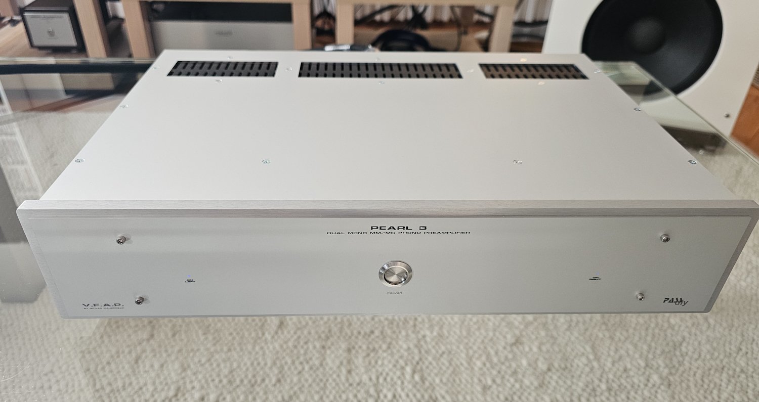

What a pearl!Hi,

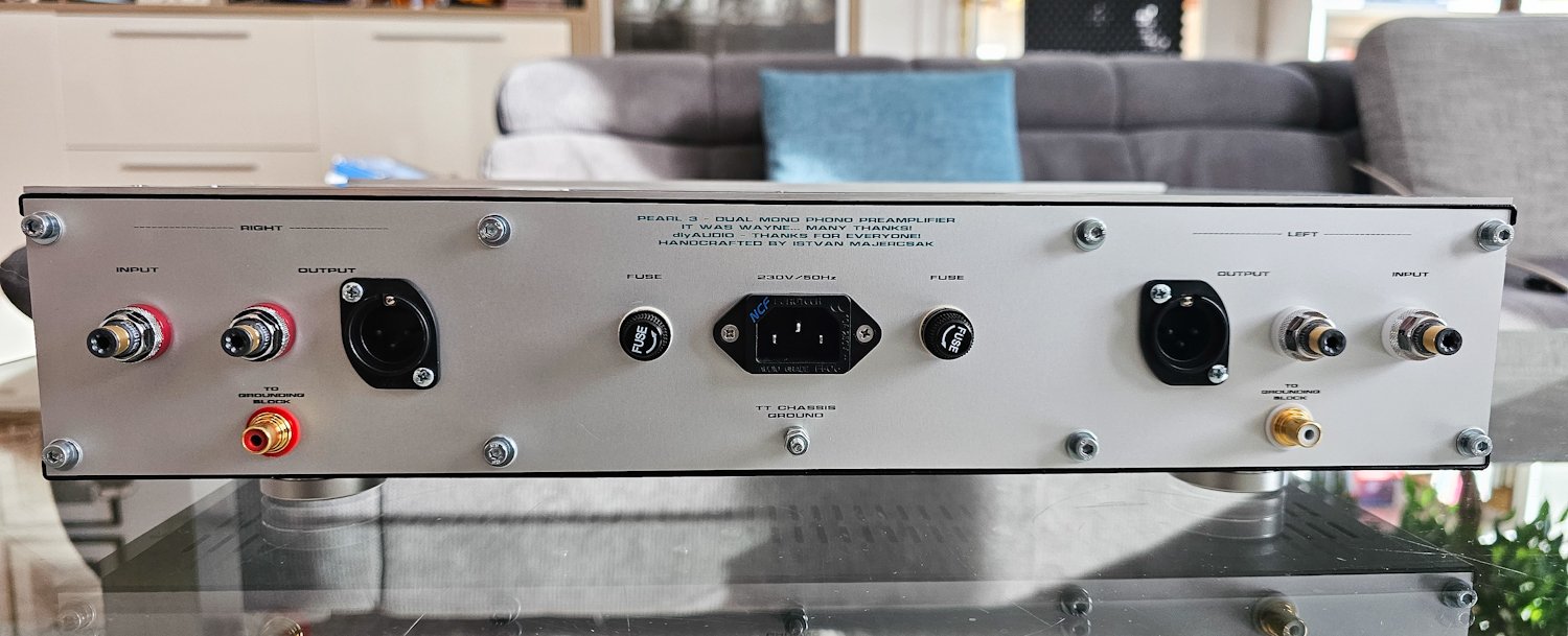

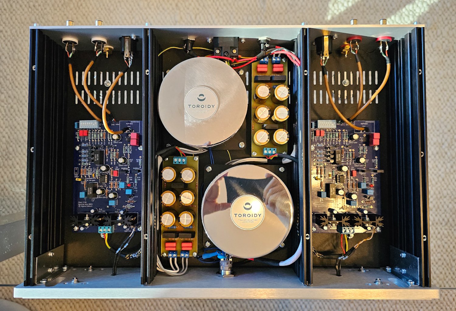

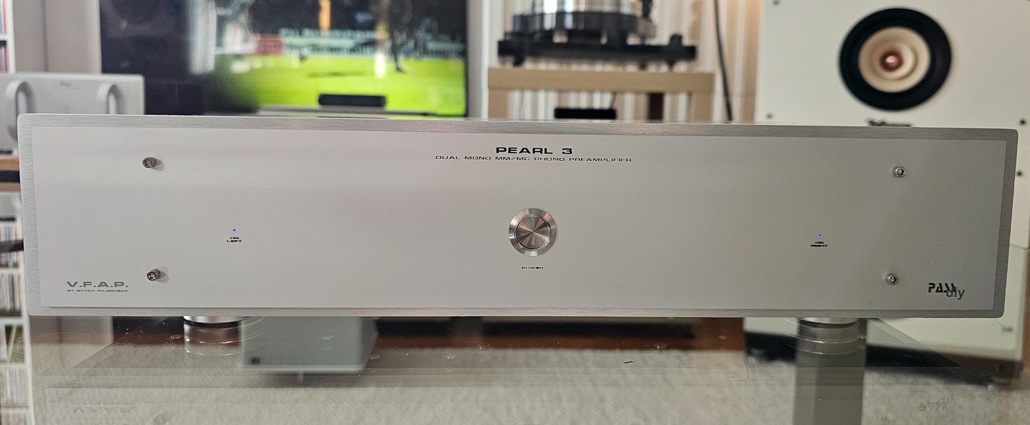

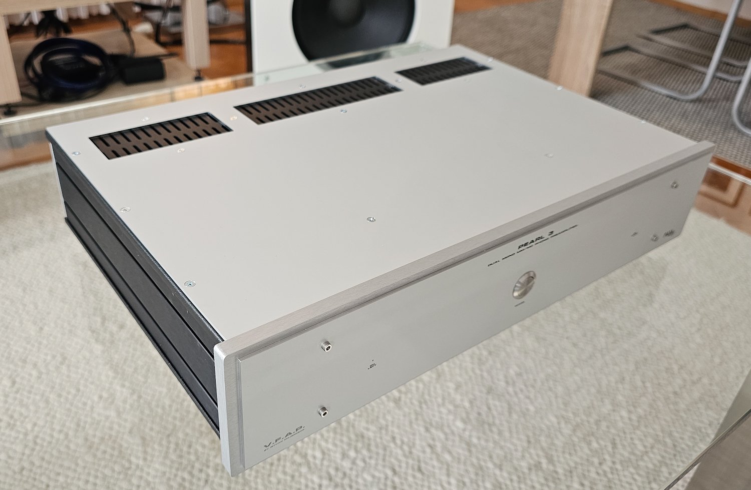

a new Pearl 3 is born, I'm happy 😍
Very nice piece there! Even back panel looks great.Hi,
Enjoy,
Russellc

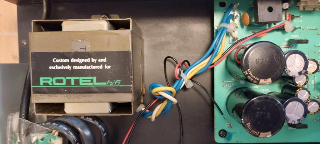

If the 17 volts (dual) you mention, is after the bridge rectifier and without regulation, that dual 17 volts is insufficient forI've now received the boards and putting things in place to begin the build. I realise the recommendaiton is for a separate PSU using the board provided, but I have a Rotel phono case which has a 17vdc supply already in situ (see image). This looks like a basic transformer/bridge rectifier/caps/regulators. I'm considering scrapping the rest of the board (which isn't functioning) and locating the 2 x pearl board within the chassis. The transformer looks like it's surrounded by steel panels and I am considering putting in place additional panels between the transformer and the board to isolate the tranny. Any thoughs on this and what kind of panel would be most effective in isolating the transformer from the boards? View attachment 1464370
the Pearl 3. If you want the 7815/7915 on the Pearl3 to work/regulate properly, you need at least 3 volts above their stated
15 volts = dual 18 volts into Pearl3 is the absolute minimum to get a ripple free regulated supply.
Btw..... The Rotel RQ-970BX is actually a decent phono-stage, and even better with a few mod´s.
IMO it would be a real pity to scrap it just for the power supply 😉
The 7815/7915 datasheets say max dropout is 1.1 to 1.3V, depending on which manufacturer you read. 17V will be fine.
As for hacking up the Rotel to use as a case for pearl, I hope the Rotel is not working... it's a nice little unit all by itself. (Pearl 3 is better though, no doubt...) More to the point, is there really room in the chassis? if using the existing PSU, looking at photos online it looks as if you'll need to remove a large portion of the Rotel PCB to get things to fit.

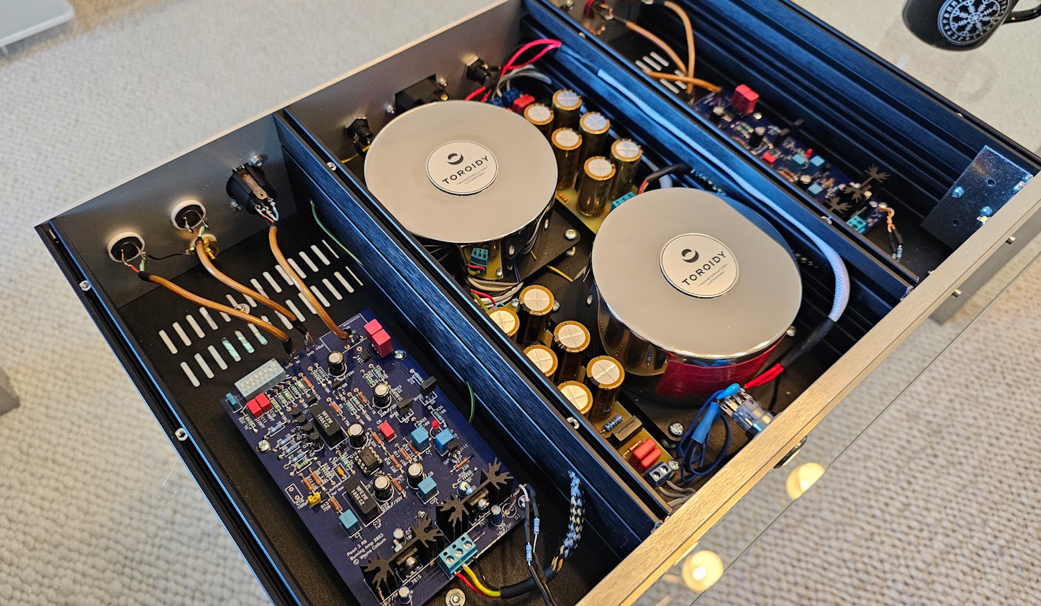

Forgot to post some internal pics.
At this point: thanks to everyone for the great support and to @wayne for this amp 👍

The Rotel stopped working some time back and I don't have the expertise to diagnose and fix it, hence the plan to remove the section of board beyond the psu and use the power supply and enclosure for the Pearl boards. The chassis is big enough to accommodate this and I'm inserting a steel partition to isolate the transformer. If there is interference then I will relocate the PSU to a separate enclosure. I'm finding that chassis costs are quite high so it seems like a good solution....The 7815/7915 datasheets say max dropout is 1.1 to 1.3V, depending on which manufacturer you read. 17V will be fine.

so... the Pearl 3 sounds gorgeous, it's the best phono preamp for me in the last 40 years, period 😍
Stage, dynamics (DYNAMICS!!!) are great, the whole spectrum is perfect, and there is so much liveliness, unbelievable.
It gives a higher than usual output level, so I have to turn down the volume on my Iron Pumpkin 6-7 clicks, but it's not an issue.
Hum? - very-very slight hum at listening volume in a distance of 20 cm from the speaker, and absolutely no hum audible at my listening position. But I know it's there, so I will make some trials. But again, it's not an issue.
Congrats on an awesome looking build.Hum? - very-very slight hum at listening volume in a distance of 20 cm from the speaker, and absolutely no hum audible at my listening position. But I know it's there, so I will make some trials. But again, it's not an issue.
But seems, there´s room for improvement.
My P-3 on 600w monoblocks, tube pre and 97dB sensitive speakers.......... absolutely no hum at all on MC/64dB.
Volume to max = a very slight hiss, that´s all.

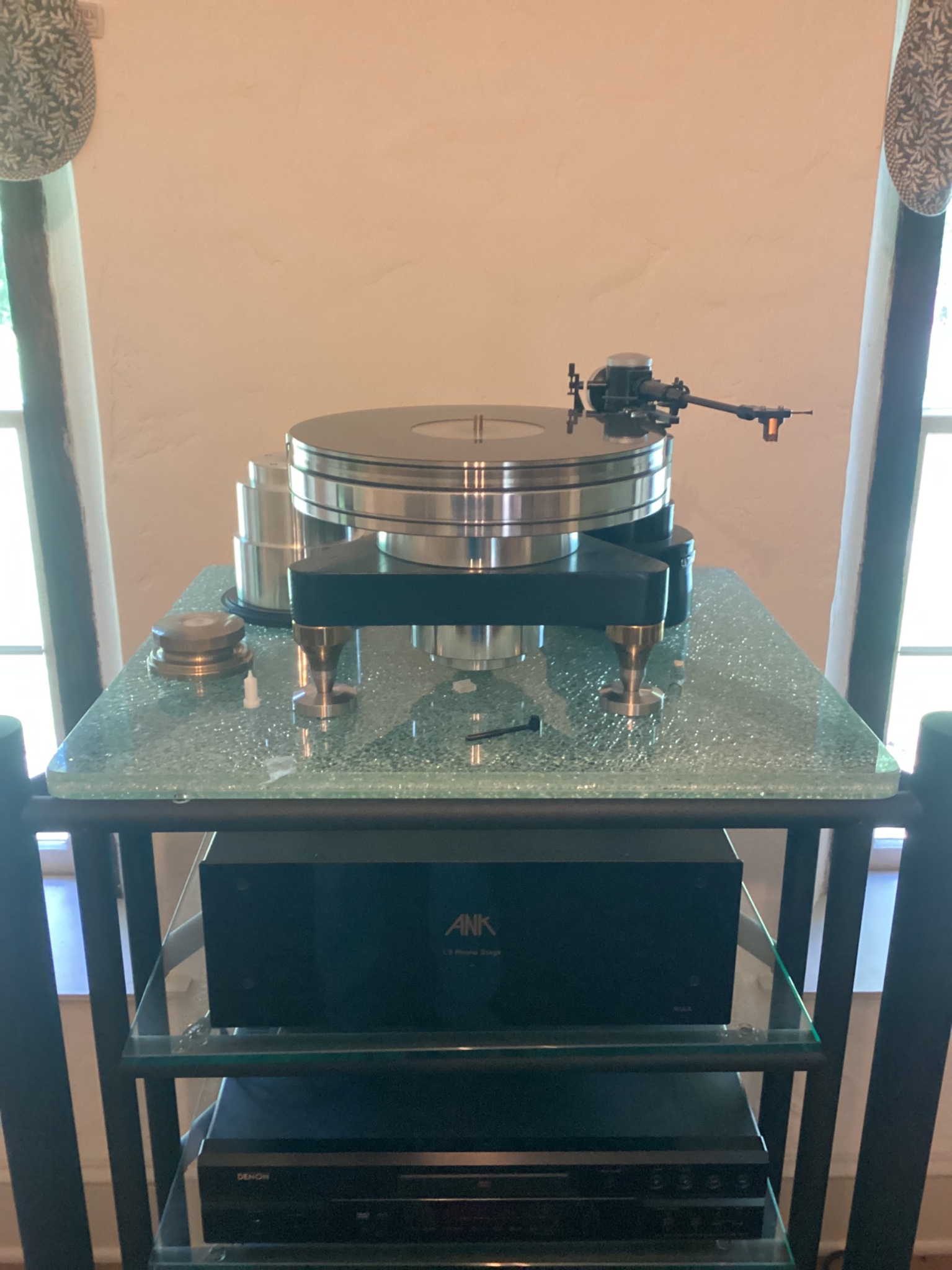

Picture below of my ANK Signature phono pre with my TTWeights GEM modified turntable.
PS: I passed the Forte preamp on to a friend and it's still playing music. Are Wayne and Nelson amazing or what?

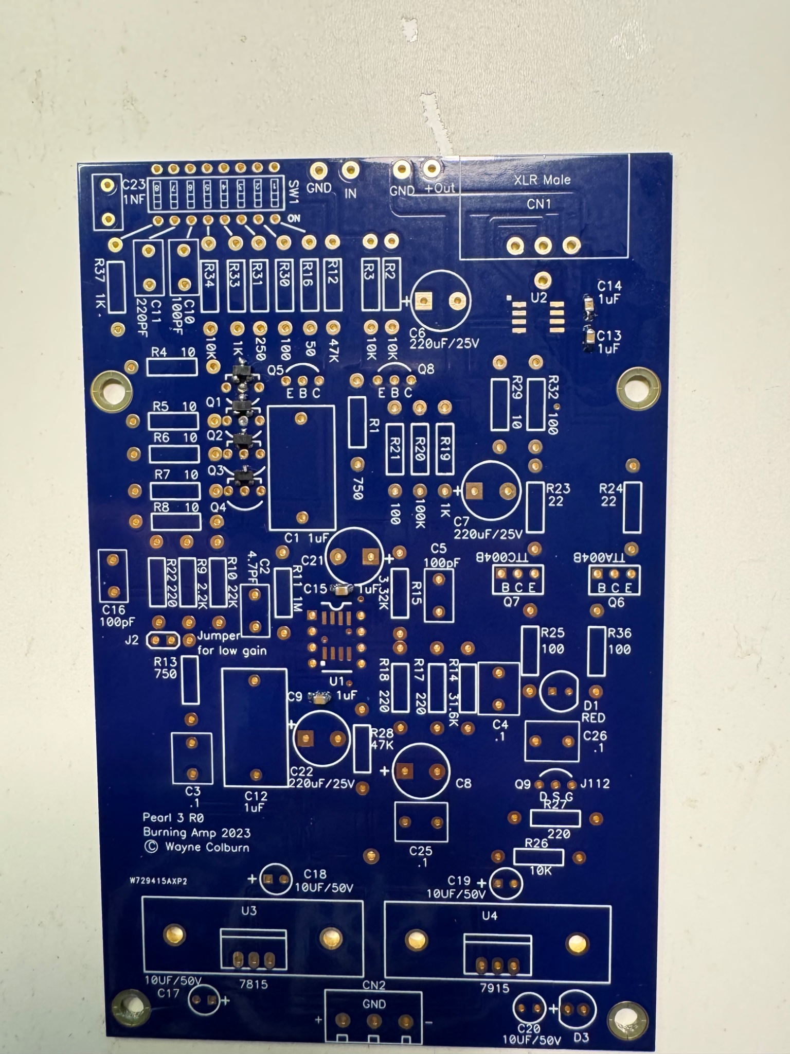

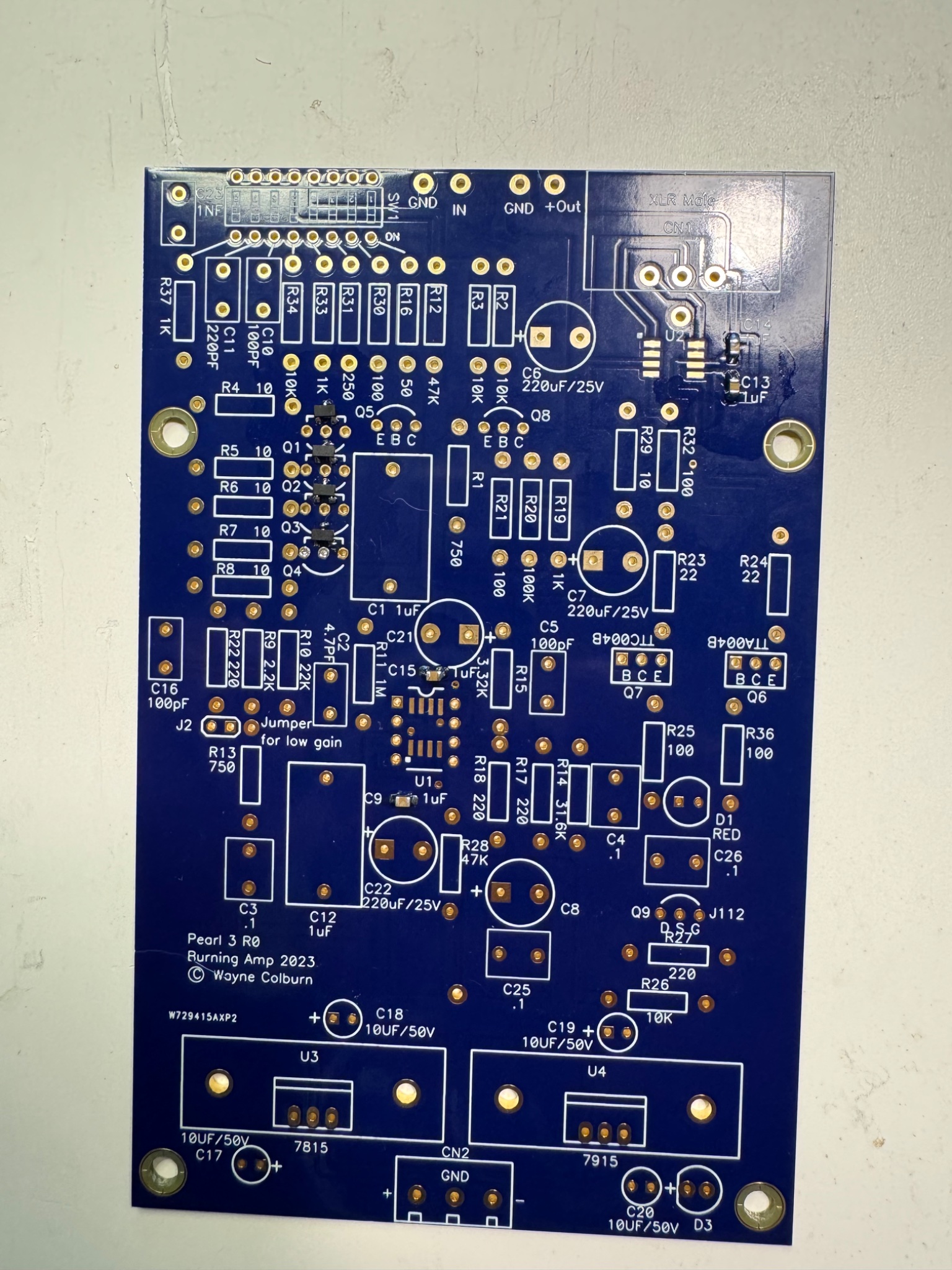

Ok, starting on the next DIY adventure with the P3.
Major concern was the SMD parts, which after a little practice, seemed to go ok (Q1-Q4 passed testing).
If anyone sees a need to touching up soldering pls let me know. I assume the spillage in the through holes are ok.
What i cant find/dont know how to do is to test the SMD capacitors. Given advice to go no further without testing, that’s my next step.
Thanks in advance!
