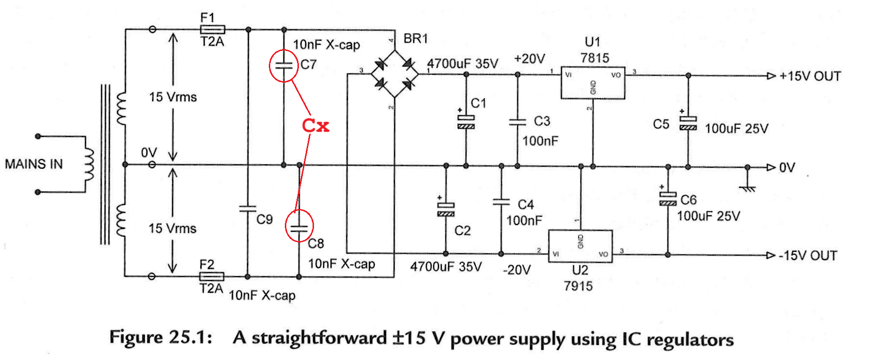

Yep, with Cx = 0 ("No Snubber" at the top of his scope trace) TomC measured 877 kHz. And with Cx != 0, I measured 100 kHz. The ringing frequency will vary with transformer type, rectifier type, and presence or absence of Cx.
Lots of equipment includes Cx without Rs (Figures 6-8 of the QM design note show three examples) and that will lower the ringing frequency, often below the bottom of the AM band (565 kHz). To name an influential example, Douglas Self continues to recommend Cx without Rs for preamps, line stages etc, even in the Second Edition of his book Small Signal Audio Design.
Self's Figure 25.1 from page 709, is attached below. DougS's 10nF, when placed in parallel with TomC's 1.9nF of trafo+rectifier capacitance, lowers the ringing frequency by a factor of sqrt(11.9 / 1.9) = 2.5X , i.e. from 877 kHz to 350 kHz. Out of the AM broadcast band. The different physical size and VA ratings of the transformers used (one's a power amp, the other's a preamp) will affect the results as well.

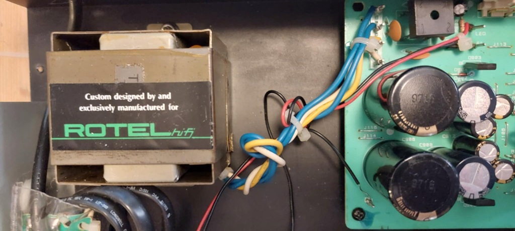

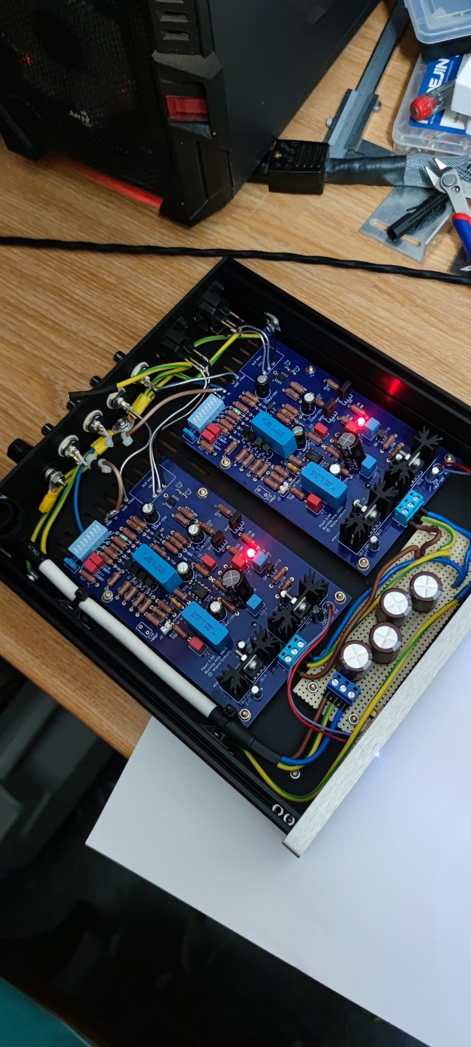

I've now received the boards and putting things in place to begin the build. I realise the recommendaiton is for a separate PSU using the board provided, but I have a Rotel phono case which has a 17vdc supply already in situ (see image). This looks like a basic transformer/bridge rectifier/caps/regulators. I'm considering scrapping the rest of the board (which isn't functioning) and locating the 2 x pearl board within the chassis. The transformer looks like it's surrounded by steel panels and I am considering putting in place additional panels between the transformer and the board to isolate the tranny. Any thoughs on this and what kind of panel would be most effective in isolating the transformer from the boards?
Mild steel works well when you're trying to attenuate the 50 Hz magnetic fields which transformers radiate. I'd recommend making a solid mechanical connection and also a solid electrical connection to chassis earth. Mild steel is a ferromagnetic material, while aluminum and copper are not.
Reactions: 6L6
Do you mean both? If the panel is bolted to the chassis and the chassis earthed to mains then does it also need an additional electrical connection to earth?
