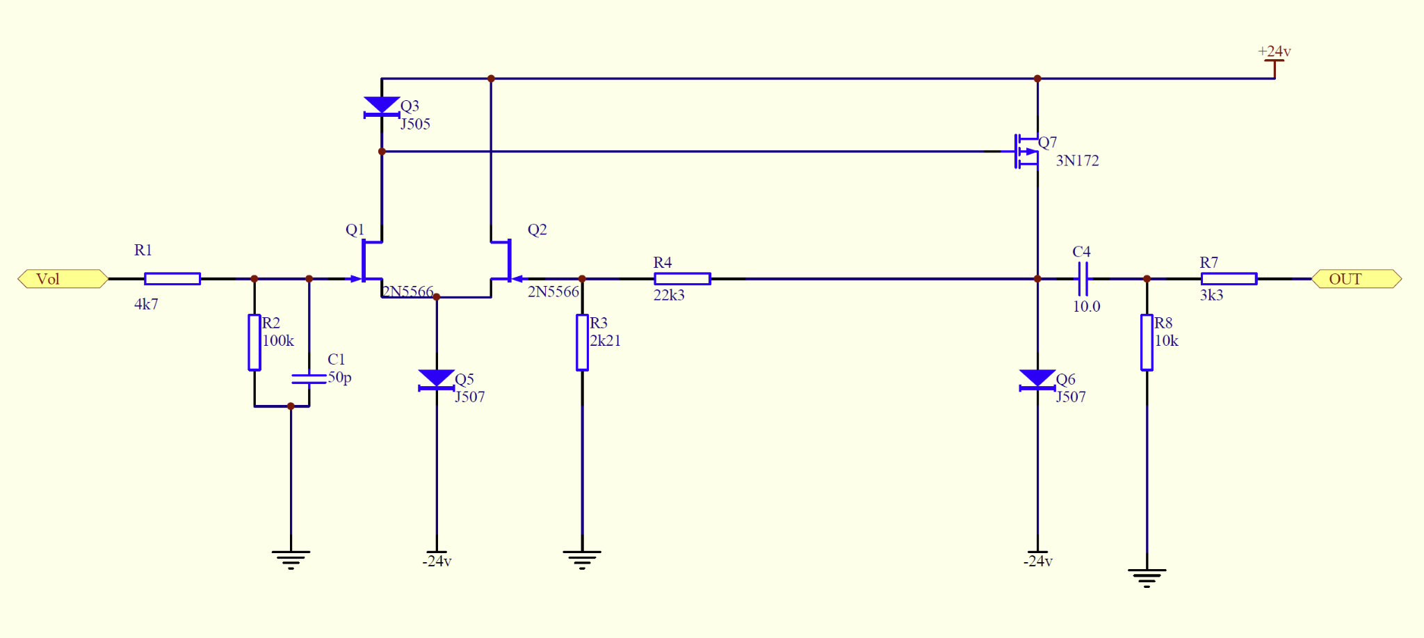

Linear Systems has recreated the entire Siliconix product line of two terminal current source devices. Here they are.
Today the worldwide semiconductor industry has chosen to name these kinds of products "Current Regulating Diodes". Mouser.com sells over a thousand different CRDs, this is a link to their sales page.
I have attached a schematic which purports to be the line stage of the Threshold FET2 preamp, designed by Nelson Pass in the early 1980s. You can see it uses three of the Siliconix current regulating diodes.
