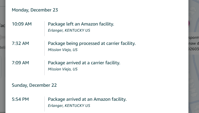

I'd be very interested in how the delivery goes (i.e. if you get cables or twine...)
They claim it's gonna get here today.
This is the current, at 11AM PST, status. It shows that the package somehow ping'd pong'd from KY (Erlanger) to CA (Mission Viejo) and back... broke the speed of sound or at least managed to be in two places at once: 7:09 AM PST is 10:09 AM EST.
This stupidity has to be intentional. Is someone actively sabotaging their data from the inside?
Are they sure the package didn't leave Erlanger last night at 10:09 PM and someone tagged it as AM?

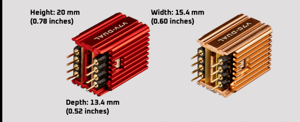

Pictures, colors...@grataku: I assure you -- you won't be disappointed. This is "slam dunk" territory. BTW checked again on height and the V7Vs sit below the height of the heatsinks, so it will fit. Feedback and noise with the high output MM will be a test. Look forward to your estimation. Am using the Hana ML and it is a superb MC cartridge only diminished by its price and its 1000 hour lifespan. And your listening assessment of the opamps above indicates you've got a serious ear...
https://diyaudiostore.com/search?options[prefix]=last&q=burson
https://www.bursonaudio.com/products/supreme-sound-opamp-v7/
BTW, I just bought a pair of each of them... and I'm looking at a Topping D90LE I just bought used... that one too can be op amp rolled if I install sockets,
This hobby gets expensive fast, huh?
