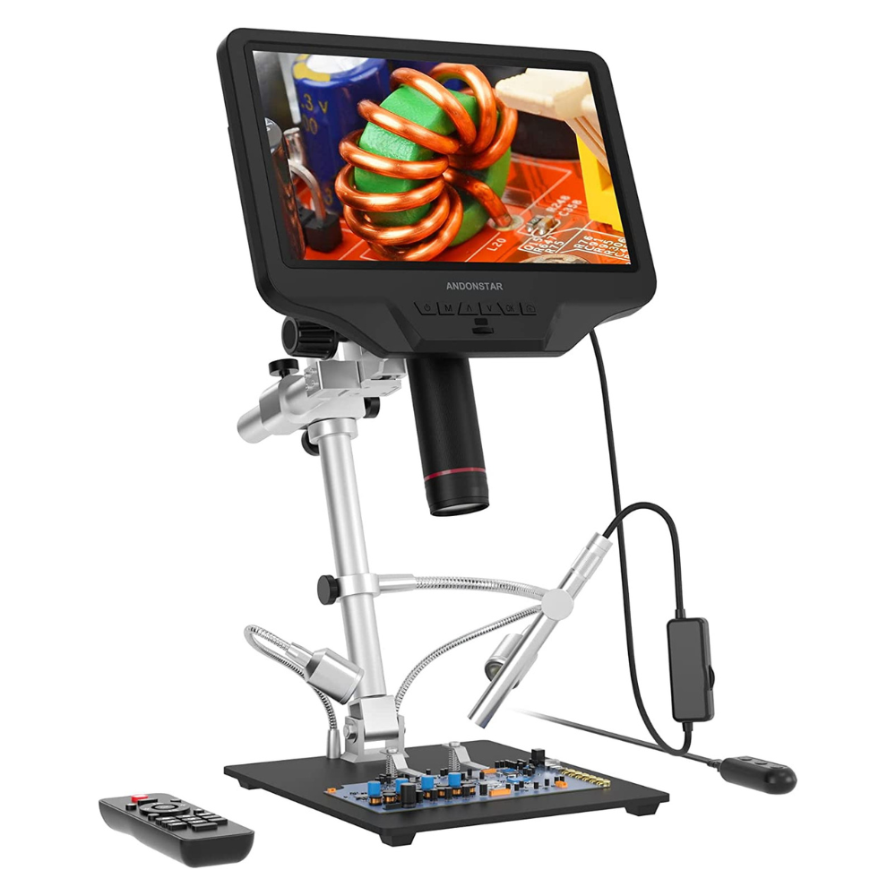

Here's another potential option, and what I'm using when needed. Adonstar AD409 Pro-ES with 10" screen, but they make many models.

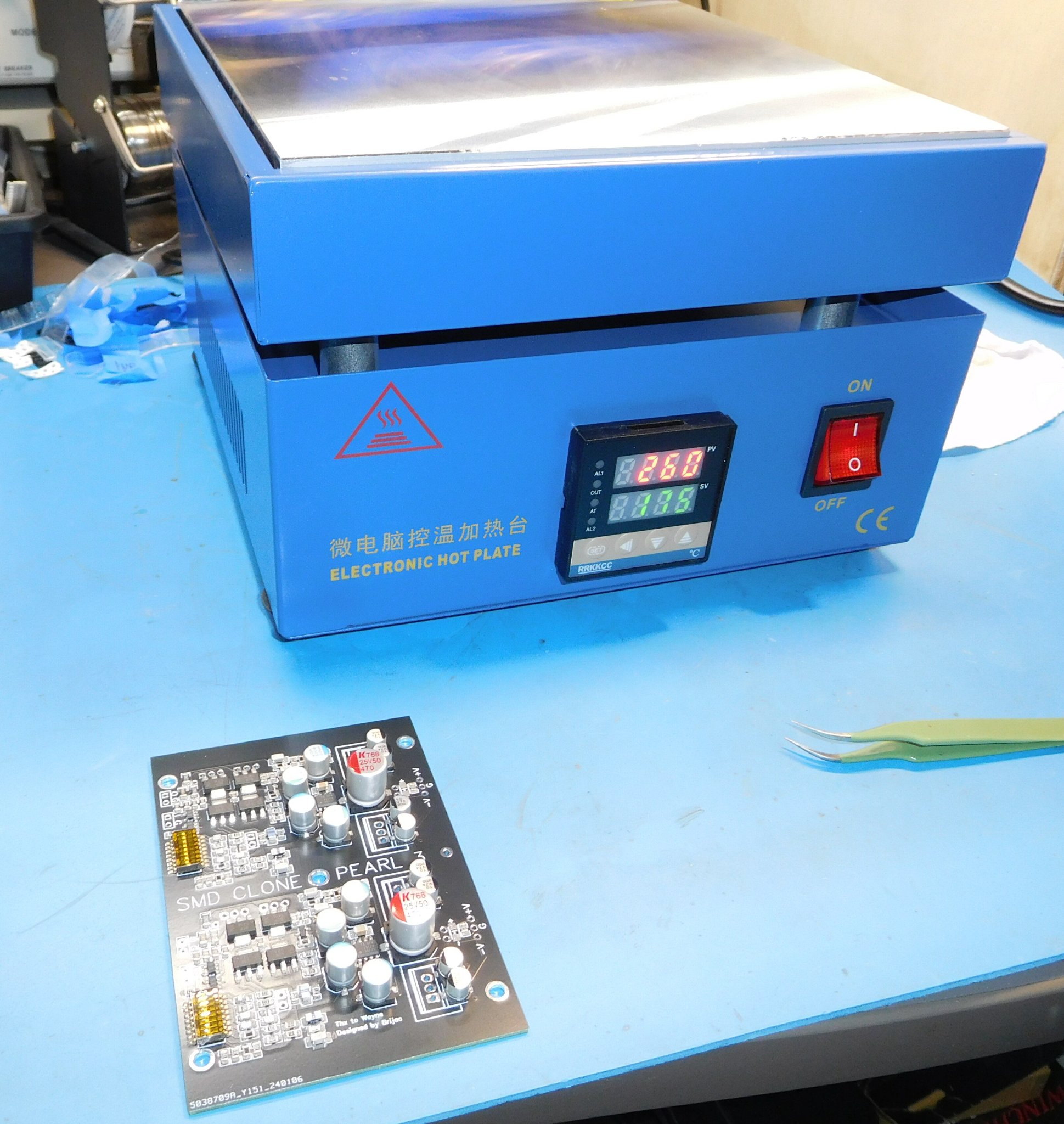

Here's the hot plate. I use easy cleanup SMD low(er) temp paste solder. A mask is not needed for just a few parts as are on the P3, but very useful for full-SMD boards.
However, for the P3, the methods already discussed are suitable for most builders.

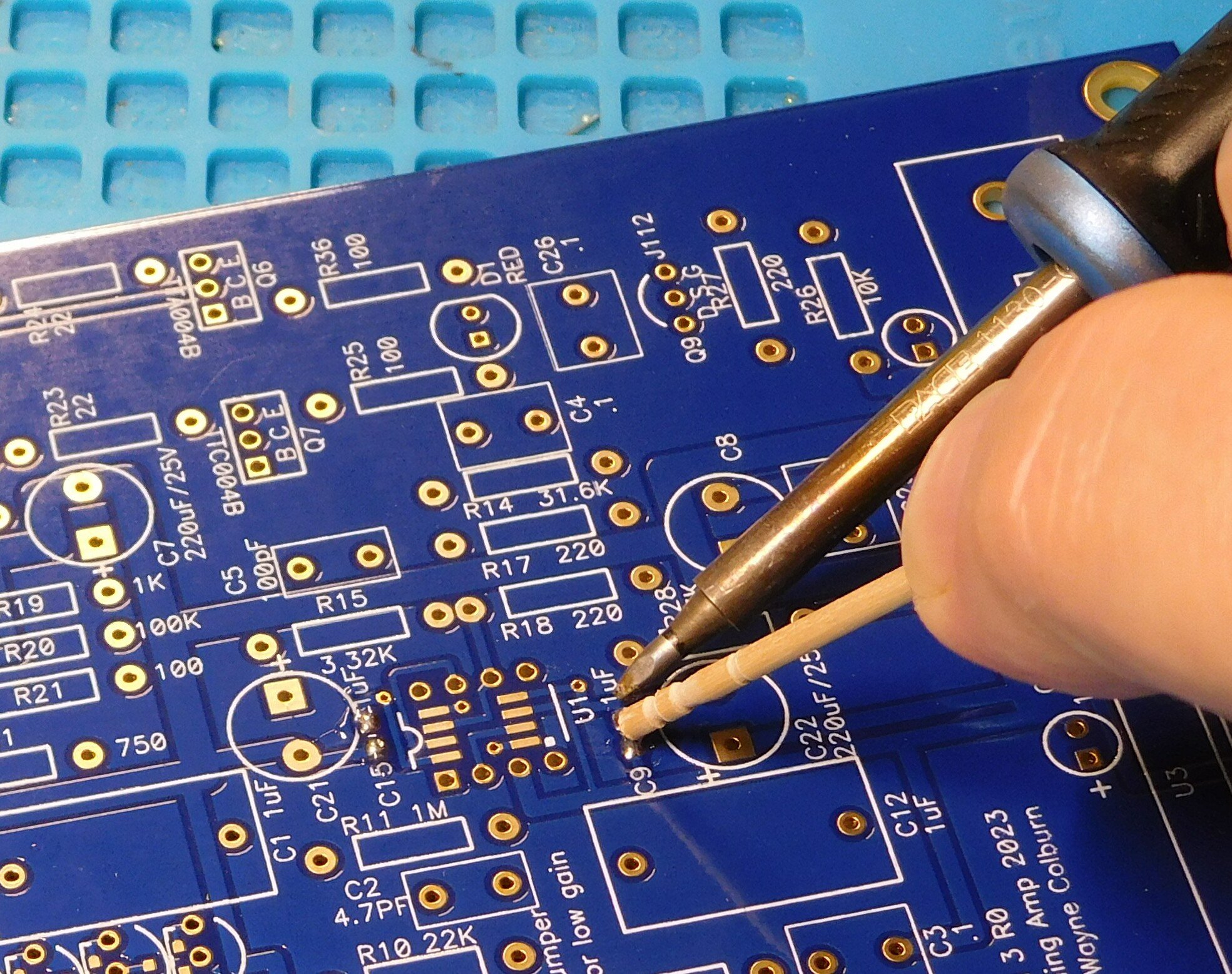

I said chopstick earlier but meant to say "toothpick", per this example. For the TH P3 SMD parts, I used Chipquik SMDSW 0.20 (really thin) no-clean water washable solder after applying Chipquik paste solder.
Same approach for installing the optional U2 and associated caps in my TH build.
That screen thingie looks great. I may not go that way as this will probably be my last build, either because i can’t do it any more or because the egg nog and a power supply were not a happy mix, but it seems like for those doing lots of this stuff it would be a superb investment.

I was just looking at a magnifier light to buy. Is this one adequate?
https://www.leevalley.com/en-ca/sho.../76037-led-magnifying-bench-lamp?item=17J3030
(my problem is floaters, the result of detached vitreous humors... lovely patterns of black shapes dancing across my field of vision)
That lamp is fine, but the focal distance is likely about 12". If you're comfortable with that much space between the magnifier and your work, you're probably good to go. I just went through this same idea before the holidays. From what I read working with swing arm lamps can be challenging. There can be some additional disorientation depending on where the magnifier is and the angle it is at which can cause you to possibly have your fingers maybe not in the right place. What did I come up with? The Donegan DA-4 Optivisor. 10" focal distance, allows you to move your head quite a bit more and has an option for a clip-on LED light. Apparently you can also use it over your regular eyeglasses and for me that's a bonus.

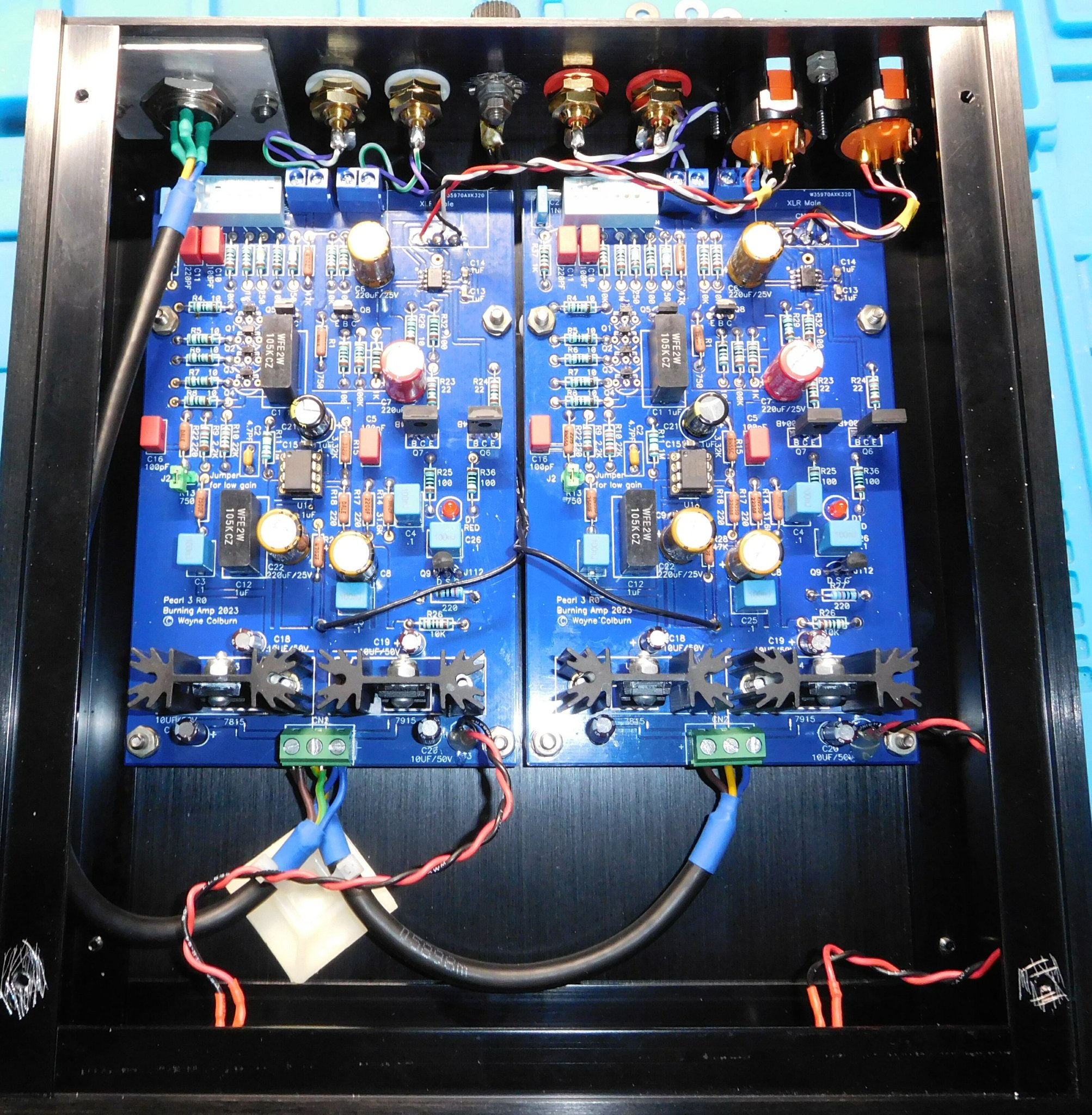

On your power supply upgrade, does it all still fit in the custom modushop chassis, or are you using a different chassis? I would like to do this upgrade ( although my P3 works perfect and is dead silent) but want to keep original P3 power supply chassis if possible.@grataku: Sounds good. Would suggest that one additional advantage to using Randy's PSU is that it offers pre-regulation -- that improves the overall noise floor significantly. The thread devoted to Mend It Mark's rebuild of Evan's MasterGroove shows the multiple regulators Evans uses in this $31k device and there is clearly an advantage to pre-regulation. I used the stock PSU for a month before switching over to dual PSUs with pre-reg (Randy's) and noted the noise improvement immediately. Both methods are very quiet, however, and your system has got to be noiseless to hear the change.
Am waiting to hear your audio assessment of the P3. Have you got it up and running yet?
Now, PLEASE, don't tell Randy about the $31k phono pre with its multiple regulators or he might jack up his price (LOL). As with 6L6, they charge way too little for their generous efforts...
