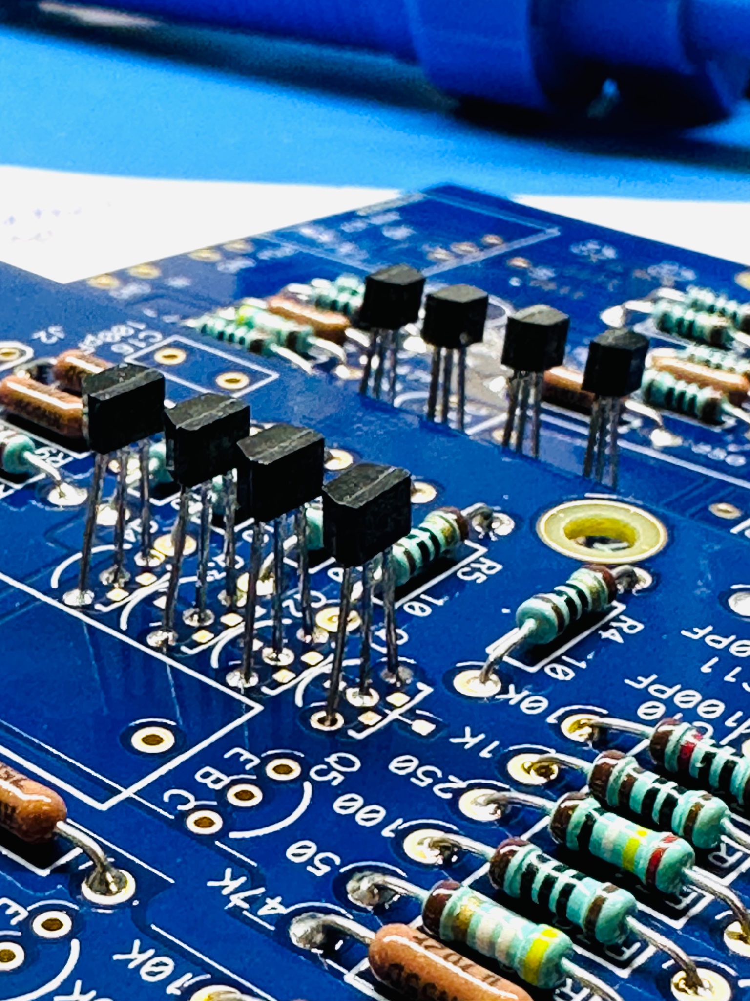

Toshiba 2SK170s
Yes I did, and it's no problem. You can see the orientation on the solder mask layout (if you put your big boy glasses on 😉 )

You can absolutely use the K170s, but as the Idss of them is almost certainly more than the included K209s, the 10R source resistors should be increased to 22R. Aside that it’s going to work beautifully.
You can also omit the teeny SMD capacitors with no degradation in performance, there is plenty of local decoupling without them.

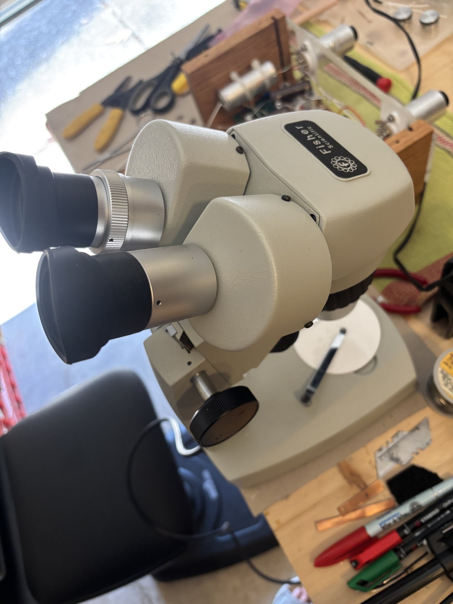

I just got my hands on an cell culture microscope (low mag) they were tossing at work, I must say soldering smd is incredibly satisfying using that.
I use small strip of mask tape to hold the thing down on one side until one terminal is attached.
I would not dare do that with magnifying lens or glasses.

Thanks Jim!! I think I have a few 22R around here somewhere as well. If not, that's an easy order from Mouser. ANy guidance for orientation? I need to feel the flat side of the 2SK170s cuz I can't really see it well. If the flat side is on the left, woukd the two outer legs go back to the right? Or is that backwards?

This is what l use for smd (and masking tape to grab the part). The mag lens would not work for me. I use reading glasses for the resistors and reg components.
Nice.
I find taping down a bit difficult for me compared to holding down with curved fine-tip tweezers, or even a wood chopstick.
And probably goes without saying, @spoiler, but paste flux is your friend. Also, apply solder to one pad only first, then tack part, then solder other pad(s).
I got the shakes, so holding it straight for any length of time is out for me. I tape it with a thin strip, I leave the lead I want to do first exposed, once that is soldered, I can rip the tape off, come back and finish all the other leads with ease.
