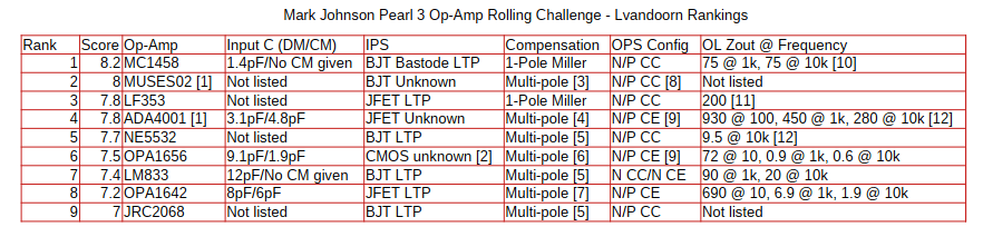

My small set of op amp ranking. BTW I didn't care to like one or the other more and approached this with an open mind. I started from the JRC and returned to it at the end.
My rank
1 JRC2068
2 NE5532
3 LF353
4 MC1458
Comparison with the below ranking from the other Mark Johnson's thread is perplexing..
Should I flip the sign in the Excel ranking formula or get the right decryption code to get the true ranking?!?
In detail from lowest ranking to highest:
4 - MC1458 high freq are rolled off, dark and dull sound - all LF and only LF seem to present. Imaging very poor, sound seems to come from the individual speakers. Maybe HF roll off robs all the imaging definition somehow. Maybe with ear-drilling ribbon tweeter speakers like Piega or something like that this could work?
Overall unplayable in my system.
3-LF353 brings back HF and imgaging substantially from the brink of the MC1458. The sound is decent but still rather thin, uninvolving and lacking midrange body. There is some sibilance in the highs that I found detracted the experience. The best characteristic of this chip is imaging.
2- NE5532 very balanced chip does everything pretty well but excels in nothing. A reliable 'middle manager' sound-wise, where the boss can go on vacation knowing the shop is not burning down. At the same time, only 85% of all promised jobs get done. 😛 I think the best characteristic is some unexpectedly pleasant high freq nuance and tone.
1-JRC2068 I'd call the sound 'bodacious' in most facets of the freq spectrum with the best definition of the group. All mids - all the time - sound that may not have the best imaging of the lot but remains very involving and enjoyable throughout. I think the chip provides enough revealing power to evaluate pickups without fear of missing out. I don't think other chips can do that.

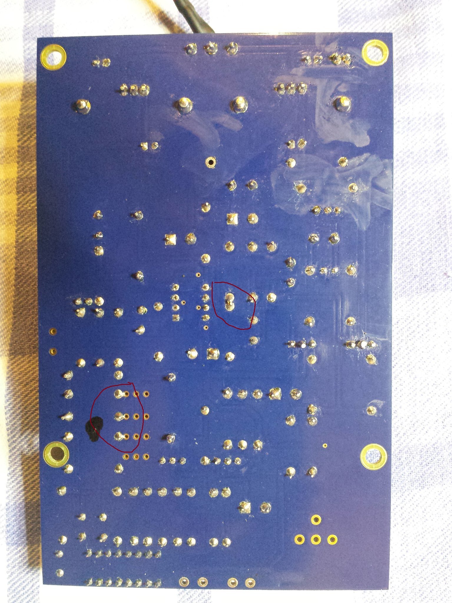

@Craigl59:When you have a chance, check the orientation of all the transistors on the left channel and, especially, TTA004B and TTC004B (and that the latter two are in the correct slot -- they are easy to interchange)
Tested de SMD jfets: all O.K. Checked orientation of all transistors: all correct and identical for left and right boards. Desoldered the left in -and output wire and could not find anything wrong with it. All solder joints of the left board also seem O.K. (see picture). Couldn't it be the SMD decoupling caps of the opamp? Have no idea how to check these.
@stereonutty: disappointing that the problem has not been identified. The dip8 base soldering looks good to me -- others on this thread might find some other issues here. Others will have to help you with your question concerning decoupling caps.
How did you test the smd soldering? Is it possible to do a "jiggle test" on the wires when the P3 is operating and see if there is any change? Have had intermittent breaks in solid copper wires that caused no end of problems.
Keep us apprised as we are interesting in your problem and its solution.
Tested the SMD fets as in the video of the build guide, mutiple times approaching the joints from different sides with the DMM probes. Also tried if I could wiggle them with a tooth pick, with power off (seemed all very solid) and power on (no effect). Measuring the resistance of the wires gives 0 Ohm. Maybe I will replace them with stranded, but I have to order that. I think it wise to do that after the holydays. And I checked the dip8 base for continuity: all fine.
@stereonutty: You have been very careful in covering all of the bases I have had troubles with and think it's time for someone else to jump in. Have had success with topping off the smd legs using a fine tip iron with flux and careful soldering (headband magnifier helps). But this can cause problems as resoldering sometimes does.
Might help others to have you describe again the nature of the distortion/volume problem with the left channel. Also, you might try pressing the opamp when the channel is on and seeing if this affects the LED light (does it flicker?). Also, did you try using another opamp on this channel?
Otherwise, have a go DIY gurus; let's get stereonutty up and running.

there have been several reports over the course of this project where difficulties have been resolved by careful cleaning of PCBs especially of flux around solder pads and leads.
