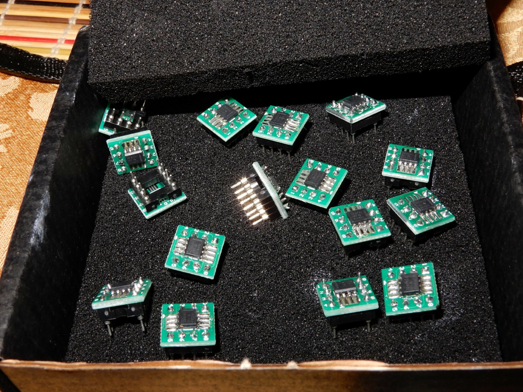

I make a lot of SOIC-8 to DIP-8 adapters, and to eliminate the extra contact points between the adapter board and the socket (which is then plugged into a socket on the board), I make sure to flow solder from the pins through the board into the contacts of the socket. If this is then soldered into the main board, there are no friction points, but if plugged into another DIP-8 socket, the high-quality round pins make good contact with the round-pin sockets soldered into the main board.

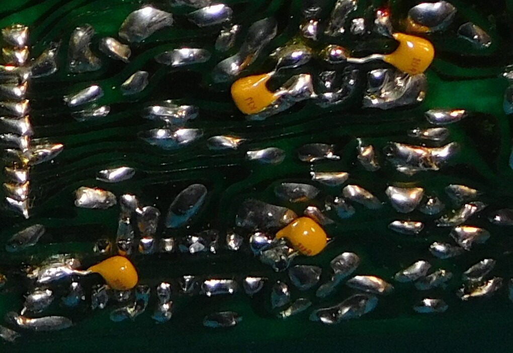

No, it's a good question, IAIMH. Local rail bypass caps are recommended by the manufacturers for many/most high-speed op amps. In the vintage preamps I've worked on and updated, I just add those caps to the bottom of the main PCB, because they originally came with TL072 and had no bypass caps. Unfortunately, in most positions, there is barely enough room for the adapter board, so making it larger for the bypass caps won't work, but that surely isn't the case with other situations.
I've made really tiny adapter boards for mounting SMD JFETs to through-hole PCBs, so I might see if I can come up with something you have envisioned.

Edited to add - Going right to the end of the pier (or plank) ... maybe using an SMD cap on the adapter board is an option vs. a (relatively speaking) big through hole film cap. Again... I truly haven't the foggiest of clues. However, it is fun to see that some aspects of design can carry across "themes".

Thanks for adding this @rhthatcher. I was answering the question generically, though it doesn't apply to the Pearl 3. Or, for that matter, most circuits designed for high-speed op amps, since bypass caps are generally already designed in. Op amp rolling is much more straightforward with this phono preamp!
@ItsAllInMyHead - most local rail bypass caps for fast op amps for stability are around 0.1 - 0.01uF, generally ceramic. Small, even with TH, but much easier to design for SMD if making a new adaptor board for other situations.
