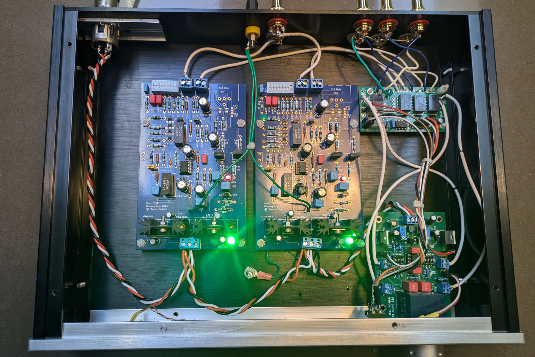

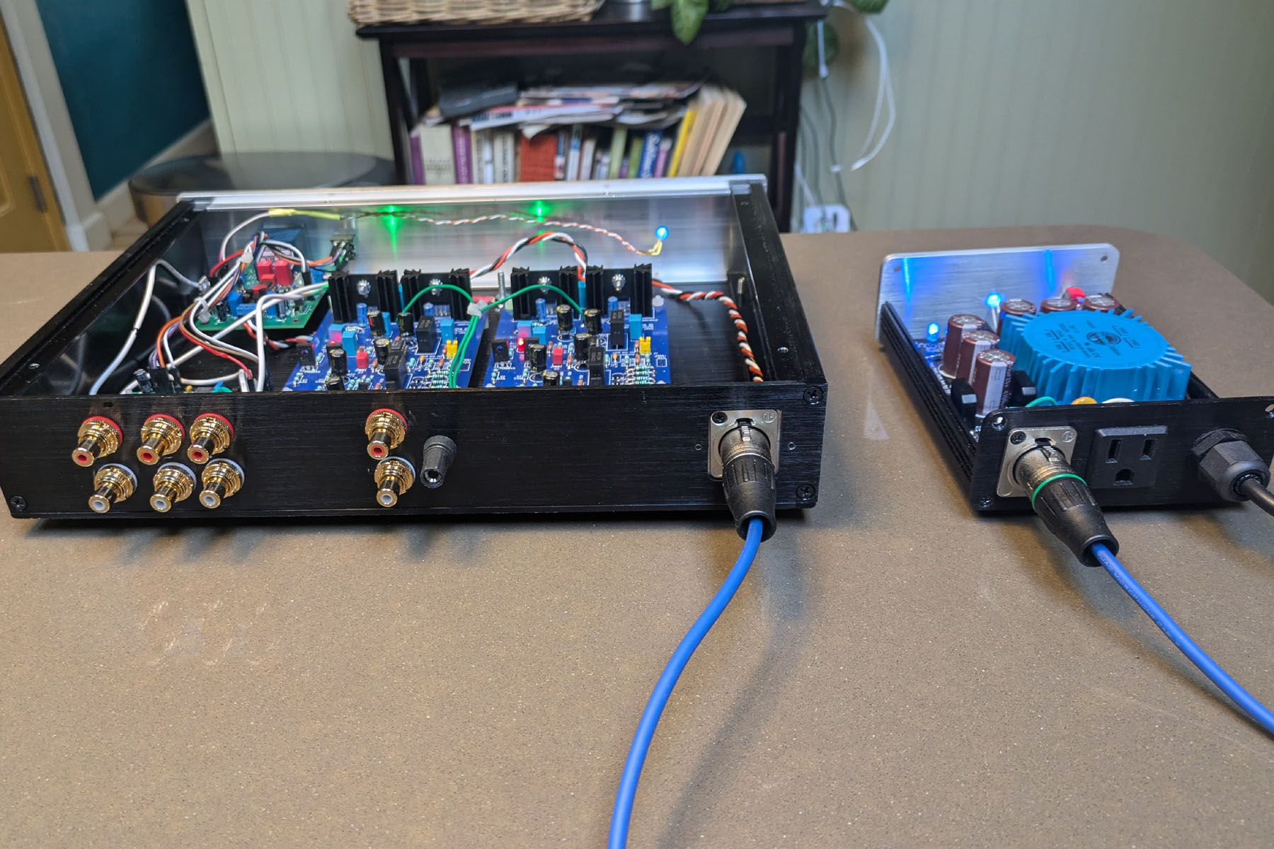

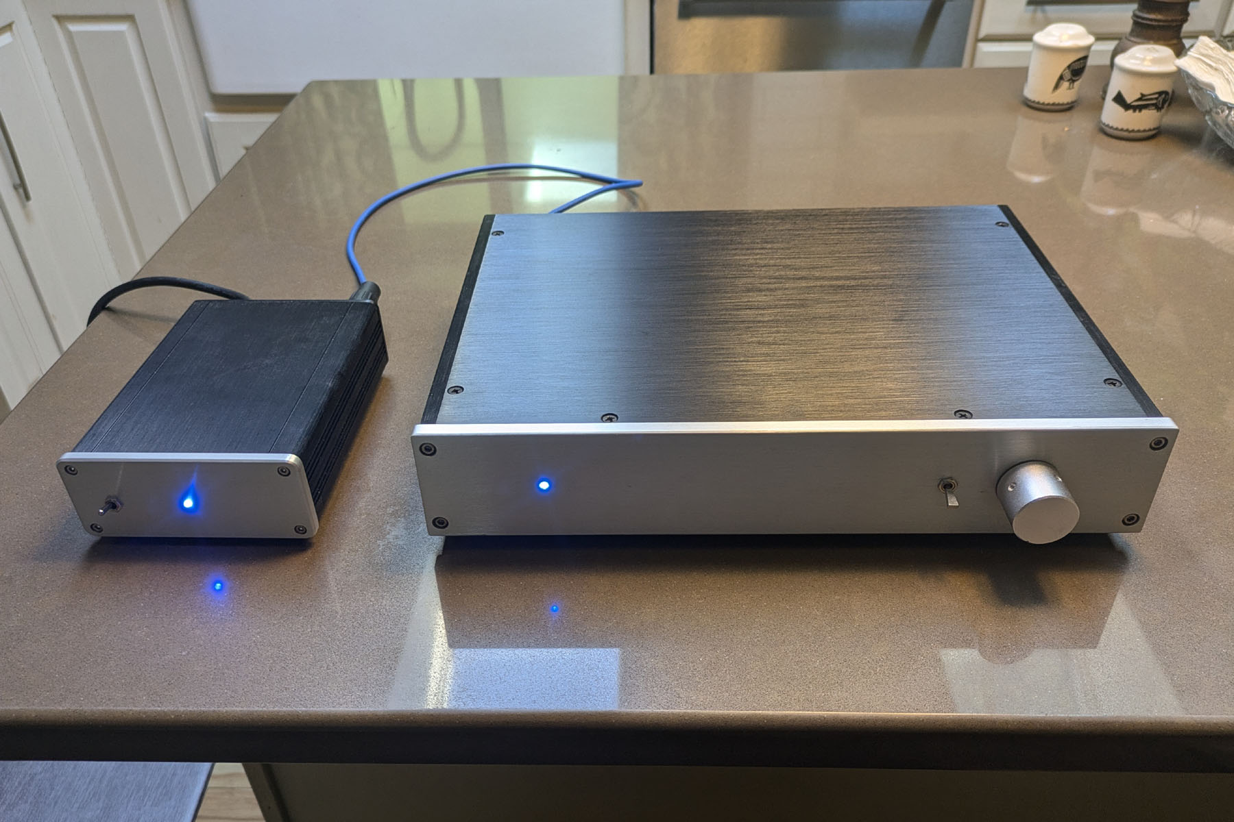

It's alive! And sounding very, very good indded. This is my iteration with some chassis I had on hand. I call it a B1P3. It's a B1R2 pre variant I whipped up with a four selector relay board (only 3 used), with power on connect delay. It uses an SP3T switch for relay selection. Using all four relays would require a rotary switch or multiple toggles.
And of course it includes the killer Pearl 3 phone preamp. What a gem that is! It sounds so good! Big thanks to Papa and Wayne for their incredibly generous sharing that makes projects like this possible!

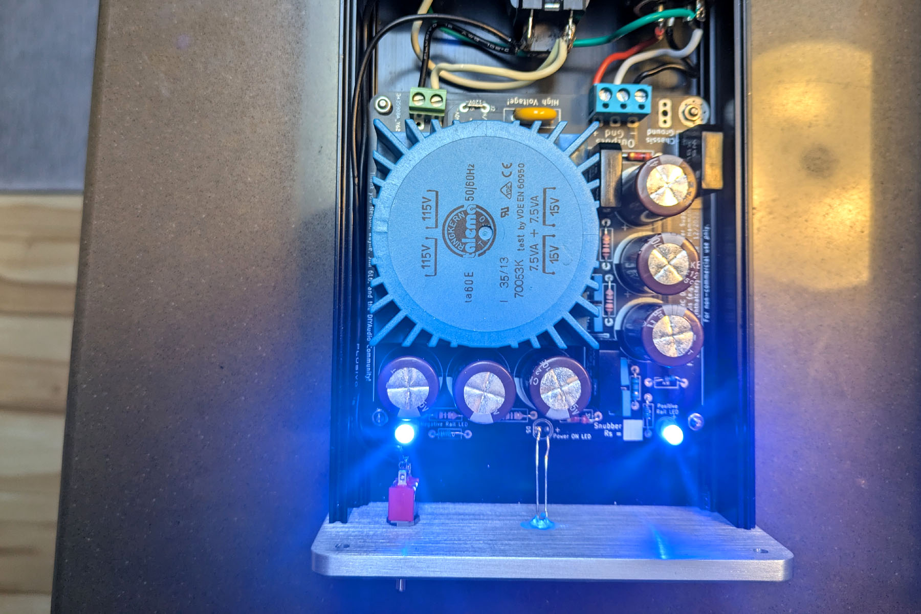

I am going to test the P3 with a high quality linear supply, a Silent Switcher V2, Super-Reg, and a simple Murata DC-DC converter and see if my "golden ears" can detect a difference.
Don't forget that Pearl3 has MC7n15 voltage regulator ICs onboard -- whatever ripple, hash, noise, ick-matter, and yuck-o-rama you provide to Pearl3 on the raw-DC-inputs, is further attenuated by these ICs on the Pearl3 board itself. Pearl3 filters what you give it.
Naturally I recommend using the UDP3 (found here on diyAudio) upstream of Pearl3, for greatest precision. But not everyone can afford the top end of the top end.
