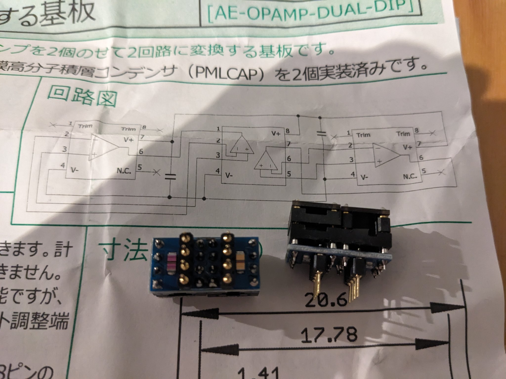

Did you get the same ones as here: https://akizukidenshi.com/catalog/g/g117651/
took me about about an hour. Didn't remove C1 as recommended. Taking it out would have made things easier but I decided to pay for my crime. Managed to get them in place with the masking tape using a spudger and a toothpick. Got continuity at all the legs. All that is left is the balanced driver then to wire them up in the chassis. But first, a break.

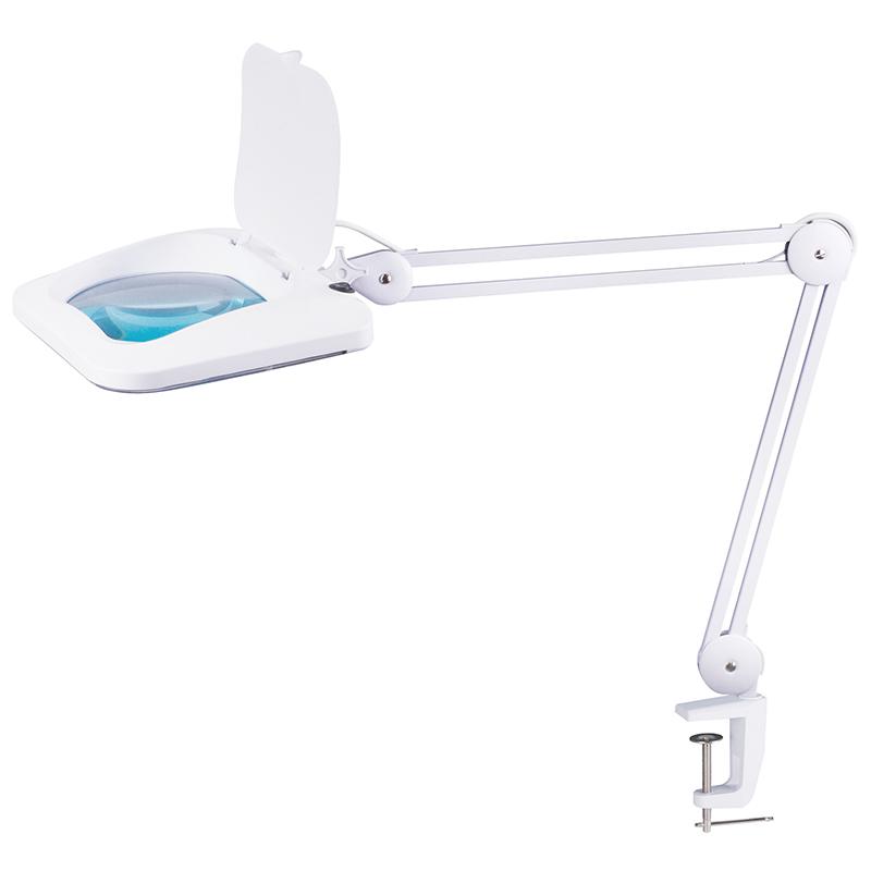

If SMD is the future of things, I need to get one of those magnifying work light thingies.
I use the magnifying light affixed to a pcb stand with tension holders; couldn't do these kinds of boards without them:

I'm finding head lenses more handy/heady than magnifying desk lamp
Whenever I tried head lamp and no matter how long I tried, I just kept banging my head on, and everything else
light ones, *2 to *3, I tried all form variations....... linked cheapo ones, these are best for me, though - to make them proper - I made holes on back ends and tied sort of elastic, so I can set them on head without falling but also without invoking headache from too much pressure

I've got both the head mount lens system and a couple different desk mount lamps. I agree with ZM, that the head mount comes in really handy for soldering (particularly with SMD). I find I use the desktop mount magnifying lenses very helpful when trying to read part labels.

I have both and the headband ones are more useful for me, these are the ones that I currently use.I'm finding head lenses more handy/heady than magnifying desk lamp.
I went the "cheap route"I have both and the headband ones are more useful for me, these are the ones that I currently use.
I used to work with something like this at my former job:
but since retiring (71 now) and not having access to it anymore, I just went on AliExpress and bought some cheap reading glasses.
Proper light at the working table, and +1, +2, +3 and +4 glasses fit every distance and component size.
And a set of these 4 glasses you can get for less than $20
Absolute priority. Sufficient illumination with no shadows or veiling reflections.Proper light at the working table
