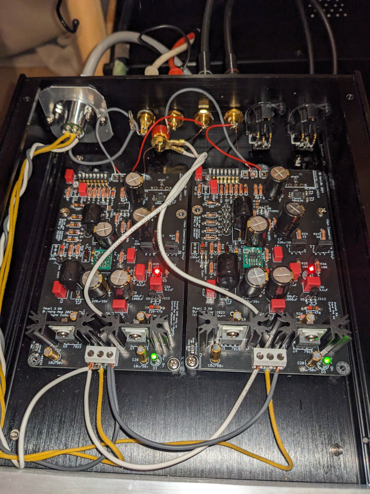

I started this project in May, had a few issues which got fixed. In testing, however, there is a stubborn problem: When the P3 is in the sound system, both D1 LEDs flash continuously; the only sound is a steady series of shorts (like Morse code). I had to put the project aside in early June and am only now getting back to it.
Observations.
Advice appreciated
Observations.
- DC voltages, PSU and RIAA, appear to be correct and DC voltages on both RIAA boards match.
- Various dip switch and J2 settings produce different flashing rates (same on both boards), but don’t fix the problem.
- Bias readings (R27=500 ohms) are identical at .3.1 mA.
- The PSU is stand-alone in a separate chassis and is connected to the P3 chassis by a four- wire cable with XLR connectors at each end. At both ends Pin#1 is connected to the jack tab. I have two cables, one where both Pin #1s are connected by wire and a second where Pin #1s are not connected. Both cables provide the same result.
- Cart is AT Art 9 MC (0.5 mV output). Currently using a DIY Salas phono stage (working properly for years).
Advice appreciated
Some checks that come to mind:
Are the opamps installed in the right way?
TTA and TTC transistors not swapped or the wrong way around?
idem 7815 and 7915
idem 7815 and 7915

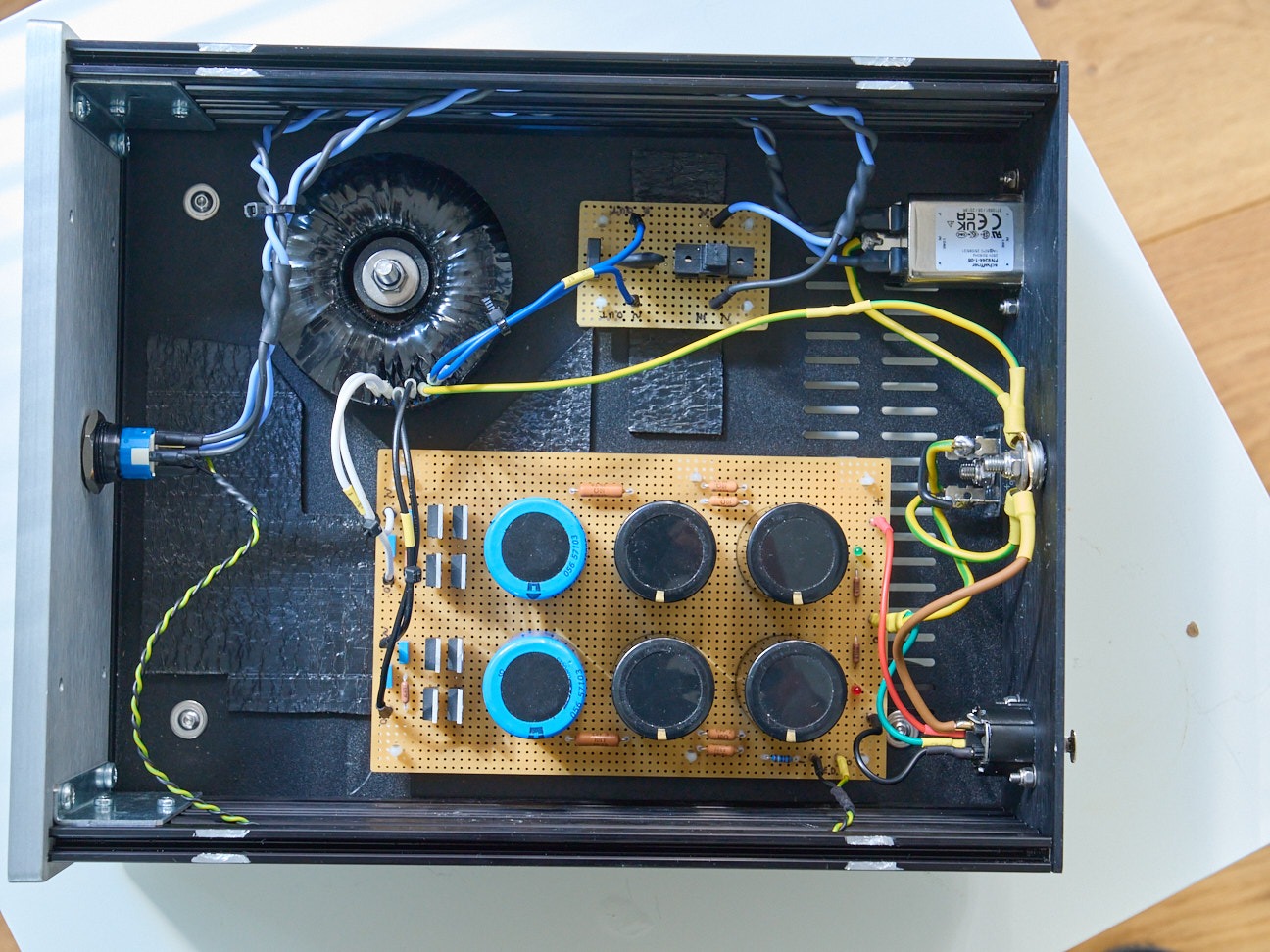

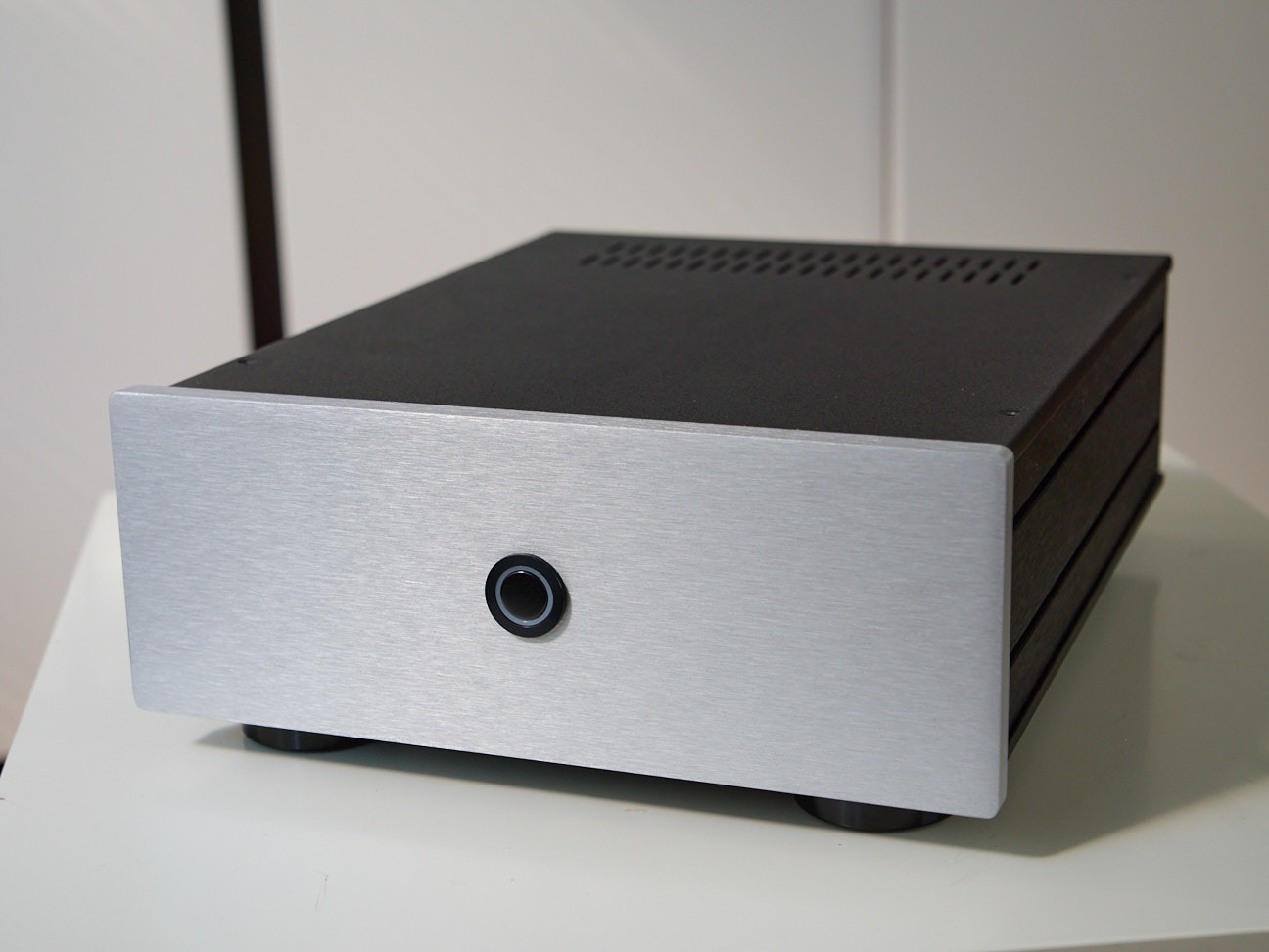

soon, soon. Currently building PSU en amp into their enclosures. But lots of other occupations, so sometimes no progress for weeks.
PSU is ready btw...
Just the usual CRCRC, inlet filter (Schaffner), snubber with Quasimode. Toroidy Audio Grade transformer 2x22V 40VA.
Thanks for the ideas. As mentioned, dc voltages on both boards are the same.and match voltages printed. It's unlikely, but not impossible) that the same error would occur on both RIAA boards.. Cases in point: U4 (7915) on both boards showed incorrect voltage. Installed a new set and correct voltages snapped into place. Similarily, I damaged one of the original opamps, bough a package of five replacements and installed two. Voltages wouldn't match. Turns out of the new opamps was faulty; once replaced everything was OK..Some checks that come to mind:
idem 7815 and 7915
I suspect this issue is related to grounding or shielding (maybe the cart is an issue). Hopefully someone witll focus,on, and perhaps eliminate, that.
If it was only grounding or shielding I would expect noise and/or hum, but still music to come through. If you hear nothing but short clicks and have flashing leds I would think something more serious would be wrong like components the wrong way round, faulty parts etc. Please post a few pics, maybe we can spot something from those.
What is the transformer secondary voltage? Was are the unloaded and loaded voltage readings at the power supply output?
loading settings for your cartridge?
can't tell... you've installed the balanced line drivers but not the XLRs??
@tamra
What cartridge are you using? I see the gain jumper open for MC gain but no loading switches selected that would be appropriate for MC cartridge.
