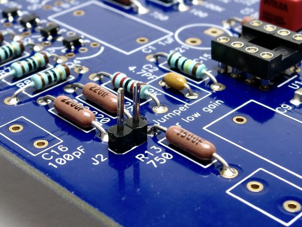

MM gain - jumper installed
MC gain - jumper open
This photos shows MC gain
The AT-VM95ml should be very loud and overloading the circuit with the gain in MC.
What opamp are you using?
I tried several opamps Muses01,Muses8920 etc.
When I closed jumper,there was no sound for too less gain.
I think I will buy from store that It's available now.
49 dB gain would be 1 Volt output with the VM95 ml so plenty loud enough (not as loud as digital sources though, but this is normal for phono). AT cartridges favor low capacitance, so try 100 pF or no capacitive loading at all. With higher capacitance they might sound bright.

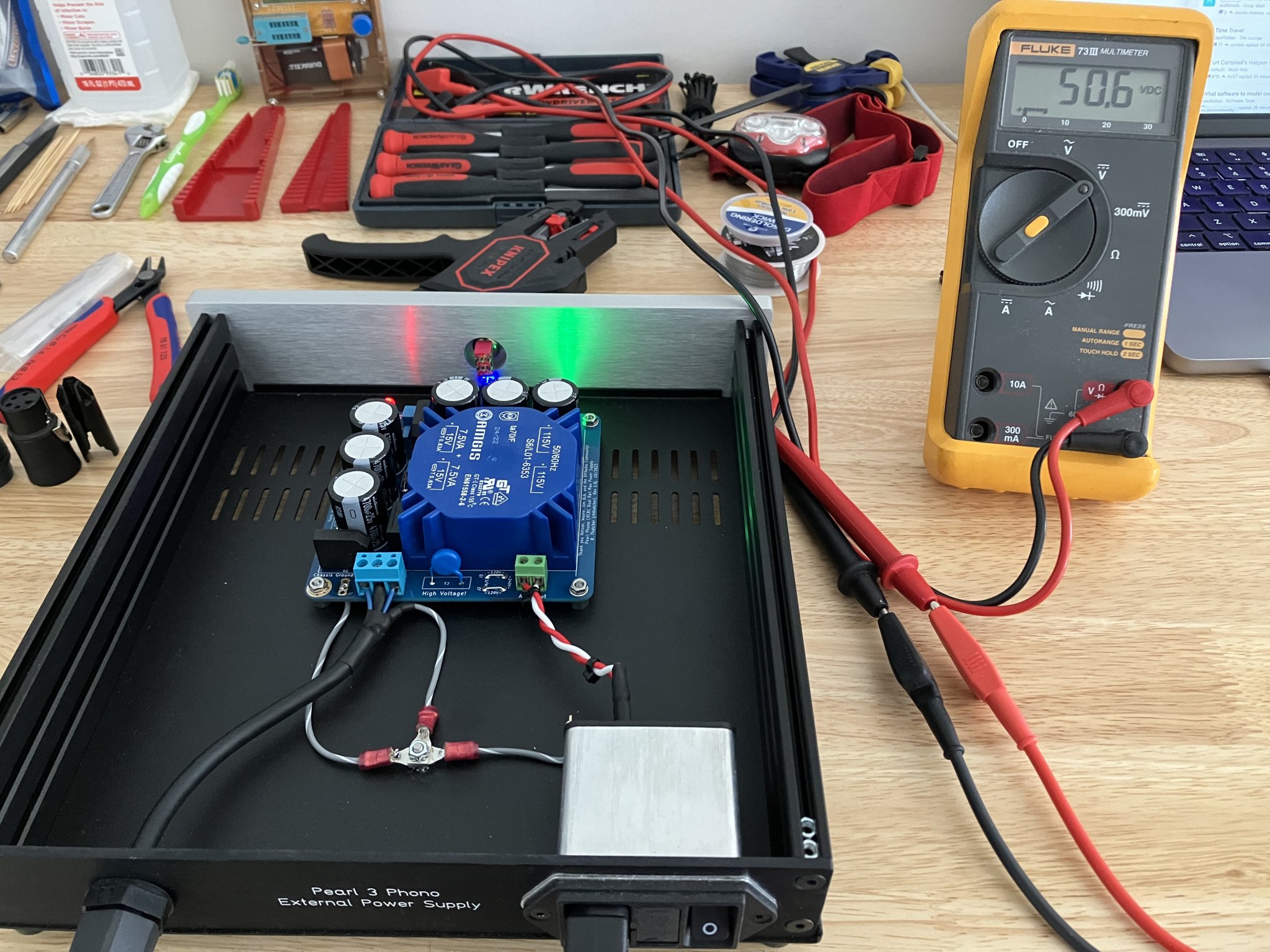

Anyone?The suggested SPST switch for the PSU in the build doc is the 100SP1T1B1M1QEH rated at 120V AC.
Is it safe to use it also in 230V countries?
Thanks! 🙏The spec rating is 120V.
I would go with that.
i.e. the answer to your question is "no".
And thanks Jim to make this even simpler. 😀
I would suggest to add a note to the build doc for the fellows across the pond. 👍
Finally got off my butt and got back to getting this phono preamp done. Working the umbilical today. XLR connector left then calling it a day. Next weekend will be getting the actual preamp circuit up and running.

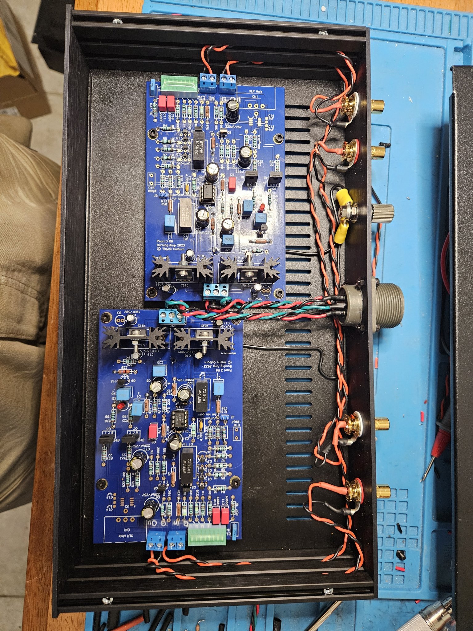

My Pearl 3 working well.
Clean,detailed and good bass.

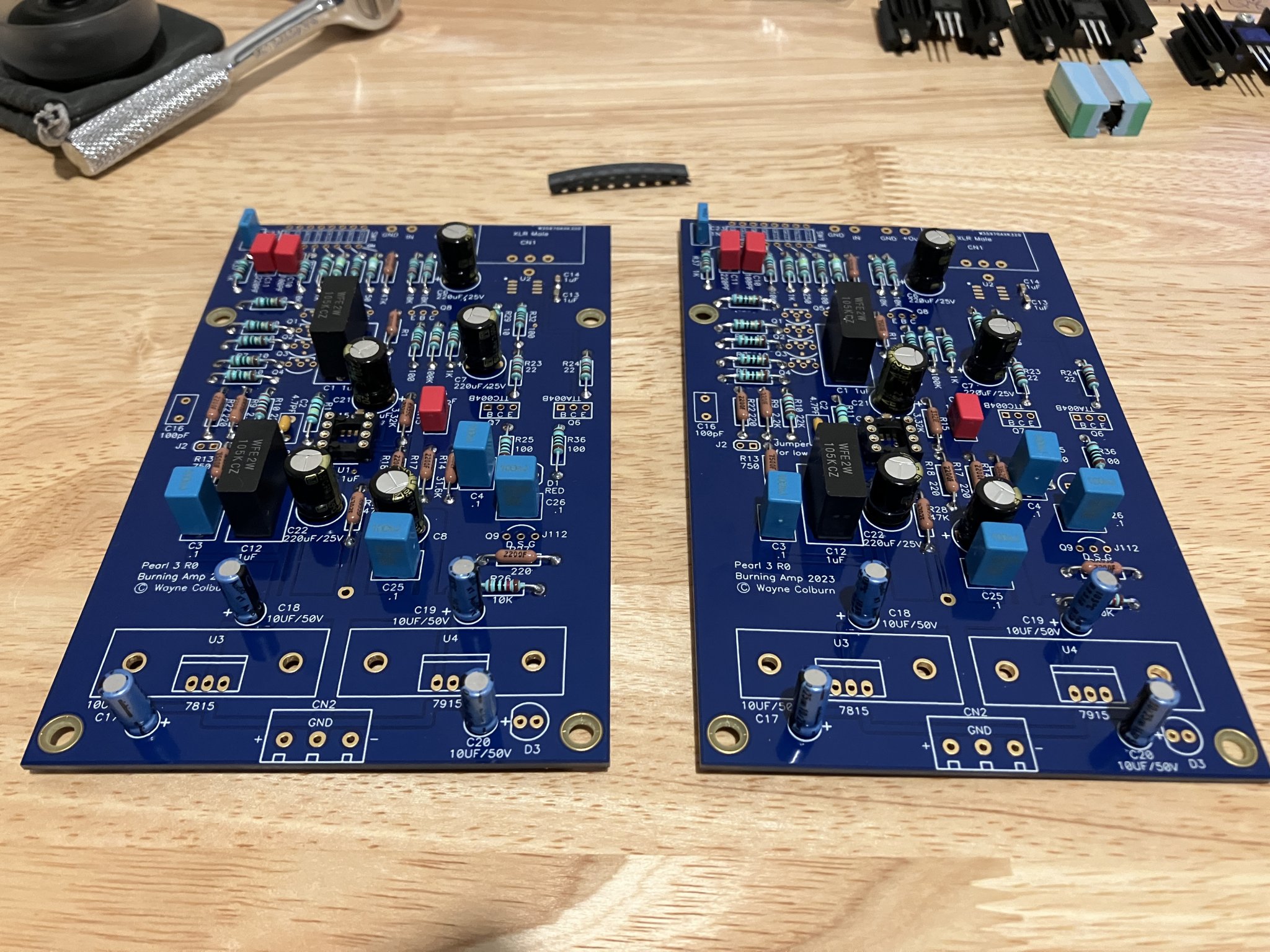

Have finally finished the third build of P3 -- was delayed because of a rebuild of my equipment racks.
Besides positionning and cosmetic changes, there was only one other alteration -- R27 was adjusted on the bench so that both channels had the same current: 4.9mA for the right and 4.87mA for the left (close enough for government work, right?). This required 560R and 600R parts.
Initial listening tests suggest two minor improvements in the soundstage. Soloists panned dead center are placed more accurately between the two speakers and orchestral instruments panned to the rear have a bit more sense of accurate depth. Of course, YMMV, and this is only the case for my equipment -- a VPI turntable with Hana ML (MC) cartridge feeding the P3 to a 2018 Colburn linestage, Aleph monoblocks, then to Tekton Double Impact speakers. The room is well tuned and this makes a great deal of improvement in the soundstage imaging.
Because of the good results (however minor) am going to redo the first two builds to achieve this same mA matching.
One fine piece of audio equipment and have now completed my PhonoStage needs for the forseeable future.
