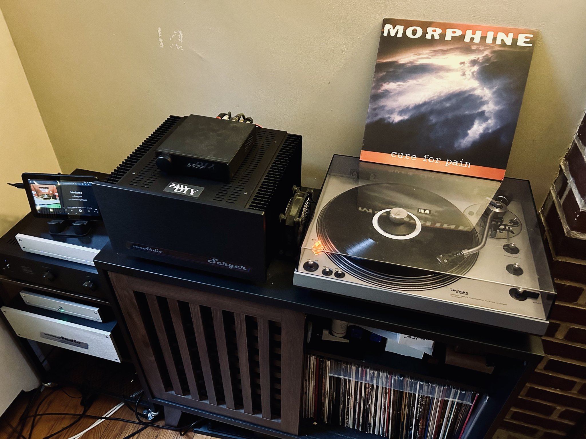

Cure for pain... How appropriate 😜Enjoying the Pearl 3 very much. Spinning contentment.![]()
The newer vinyl releases I have bought recently sound amazing. There are still really great engineers that know how get the best out of this medium.
The RSD issue of 4 of the Ronstadt Asylum releases is superb -- very quiet and clean. With the P3 you do note the timbral superiority of original analog releases (prior to 1983 or so). Was fortunate to acquire a classical collection of 3k old records several years ago and the analog orchestral items are a powerful listening experience.
