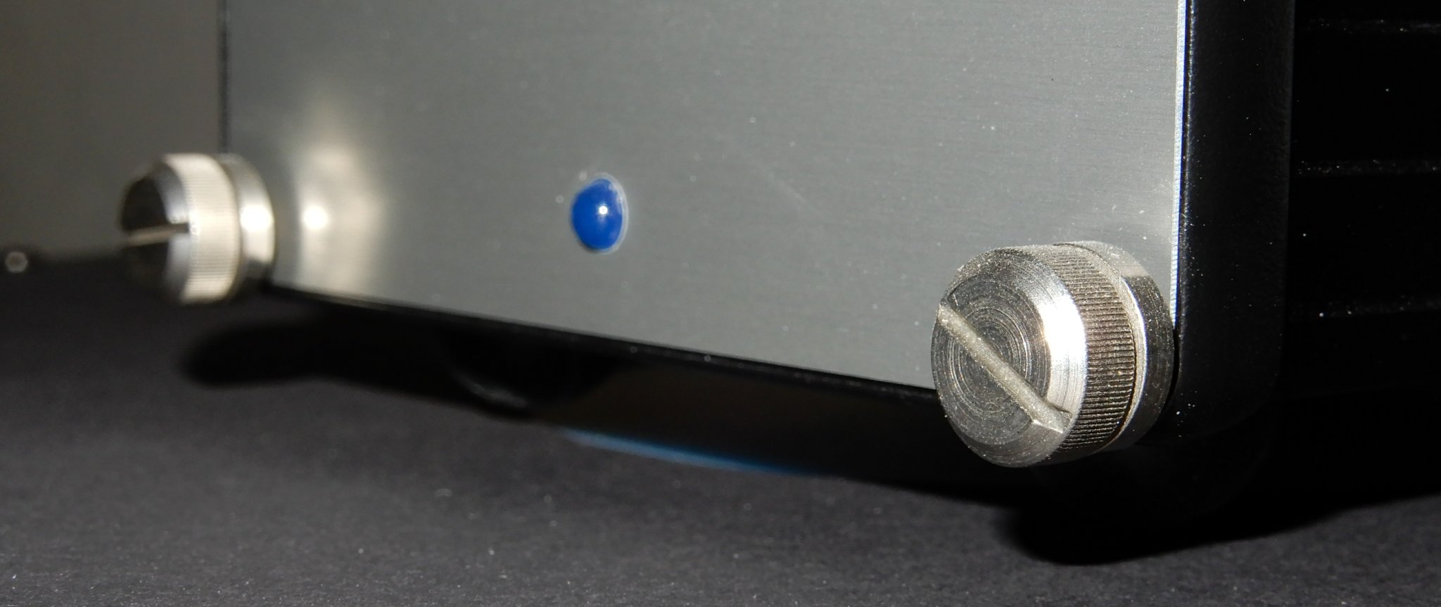

I've also used thumbscrews on a several phono preamp builds. These are actually captive, with press-collars and springs - they stay in the lid/panel.
Did you get the entire captive screw as a kit, or in parts?
Yes. The scary screw driver. It's just four screws in the special chassis. But, if it is stuffed in a rack or other difficult area, there would be that.That would be dependent on any difficulties a user has (or not) with operating a screwdriver…
The phono board chassis is just an open box. Board right there, part in question is exposed and easy to get to. Pluck it out, install another.
I was driving the prototype P3 with the lid unscrewed so I could lift it... and yes, it's on a seven inch shelf, so I don't necessarily want to reach to the back with the screwdriver every time. It's unnecessary wear and tear. That's the whole point of thumbscrews.
IMHO, the whole point of using an op amp is, well.. to roll the op amp... and that means opening the box often enough.
Yes, I did think "outside the box" and figured I could keep it open but then it'll accumulate some dust and when we get the Big One it might get damaged.
And then there's the domestic tranquility thing... in my home office I pretty much do as I fit, but my audio salon is in reality "The Living Room"... so I already got like three racks, two pairs of speakers, woofers, plus three feet wide for records -in rotation (*)- and we don't have a coffee table... the last thing I want to have in there is bare electronic boards.
I think I'll go with thumbscrews.... now the next question... will red ones sound better than orange ones? Do they make Pass Blue thumbscrews?
