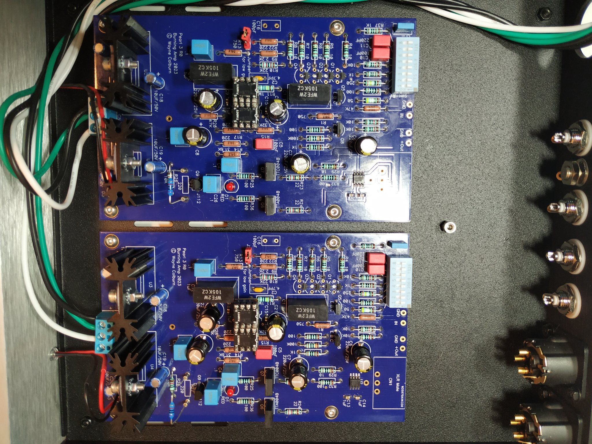

Same value R27 (820 ohm) gives in one channel 3.626mV and in the other 3.371mV. Should I try to match both channels or stop obsessing? 😁
MEPER....don't know if anyone has answered this to date but I was getting a slight hum when the preamps volumes were turned to max which was bothersome, similar to your situation. Couldn't hear anything at normal preamp levels for playing music but it bothered me anyway. It was independent of turntable being connected, preamp, amp, PS driving the P3, any grounding schema, or opamp. I'm using a Grado Green 3 cartridge (moving iron?). I just tried changing R22 to a ~47R resistor (had them in my stash; bringing the total gain down to ~ 37dB). One channel is now completely silent and the other's hum was decreased dramatically. I'll drop R22 to 40R as soon as my order gets here from Mouser. I'll then do opamp rolling to see which I prefer although the standard 2068 is perfectly fine&dandy.If someone can report less hiss-noise when volumen set to max (MJ-method) by changing a resistor to another brand or value I will be happy to know.

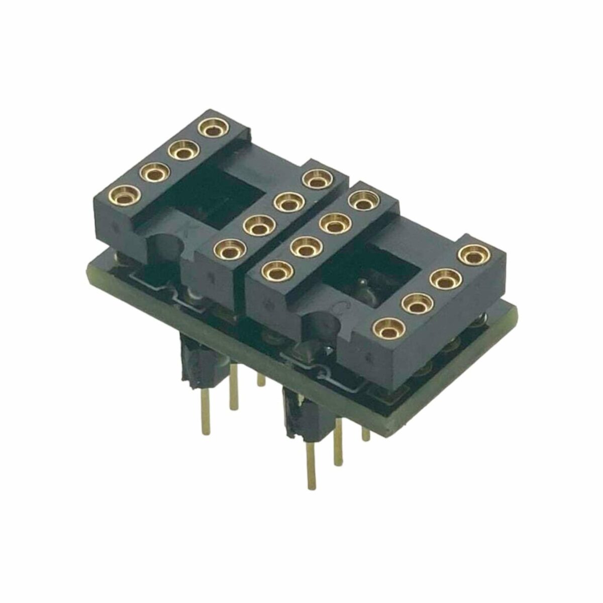

What opamp(s) are you using? That looks to be a single to dual, SMD to DIP adaptor…? Very interesting!
You mean, you can mount two single DIP devices then?
Actually, that's an interesting idea.. setting it up so I can try both single and dual opAmps. I have some single Burson opamps too.
I mean, perhaps single opamps sound better than dual?
Why would they?I mean, perhaps single opamps sound better than dual?
Anyway, get something like this and report back.
^ OK, I'll bite. I can definitely use those. I'm sitting on some single Bursons, why not play with them too? I mean, this should increase the separation between channels and deepen the soundstage, right?
I mean, who knows?
I'm game.
Where do I get them? what are they called?
