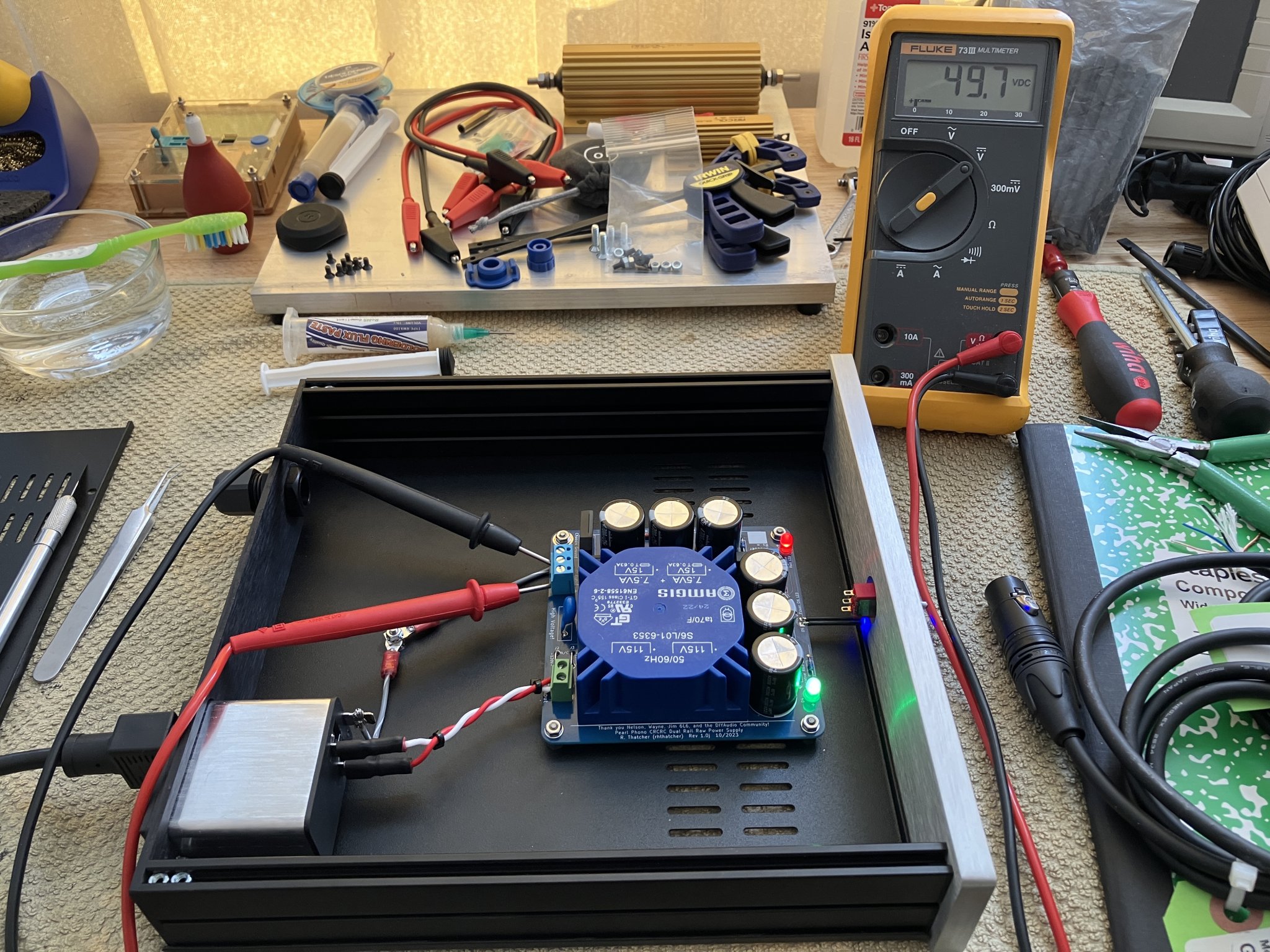

Got the PS running. Next up is the umbilical then finishing out the actual preamp part.
Nice bench full of Tools / Toys especially the note book to document your adventures.
Thanks DT
The GF is a keeper. When we moved to the new rental she flat out stated I was to go to Home Depot, buy some workbenches and set up shop in the extra bedroom. I think she knew I needed to be working on something even though we hadn't bought our settle-in home yet.
