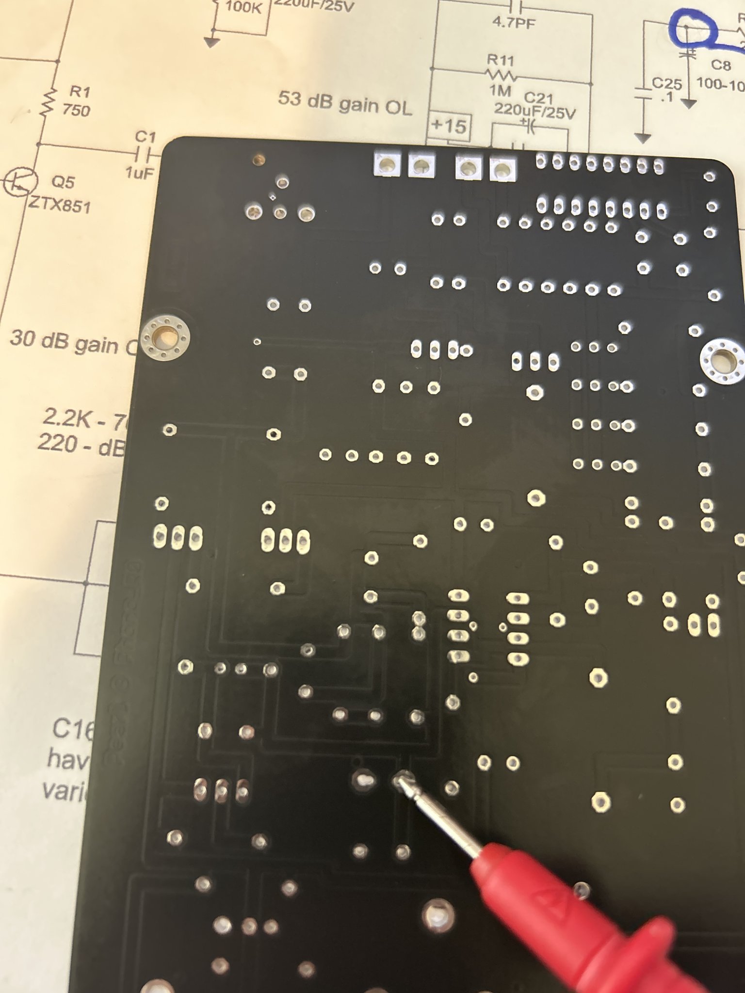

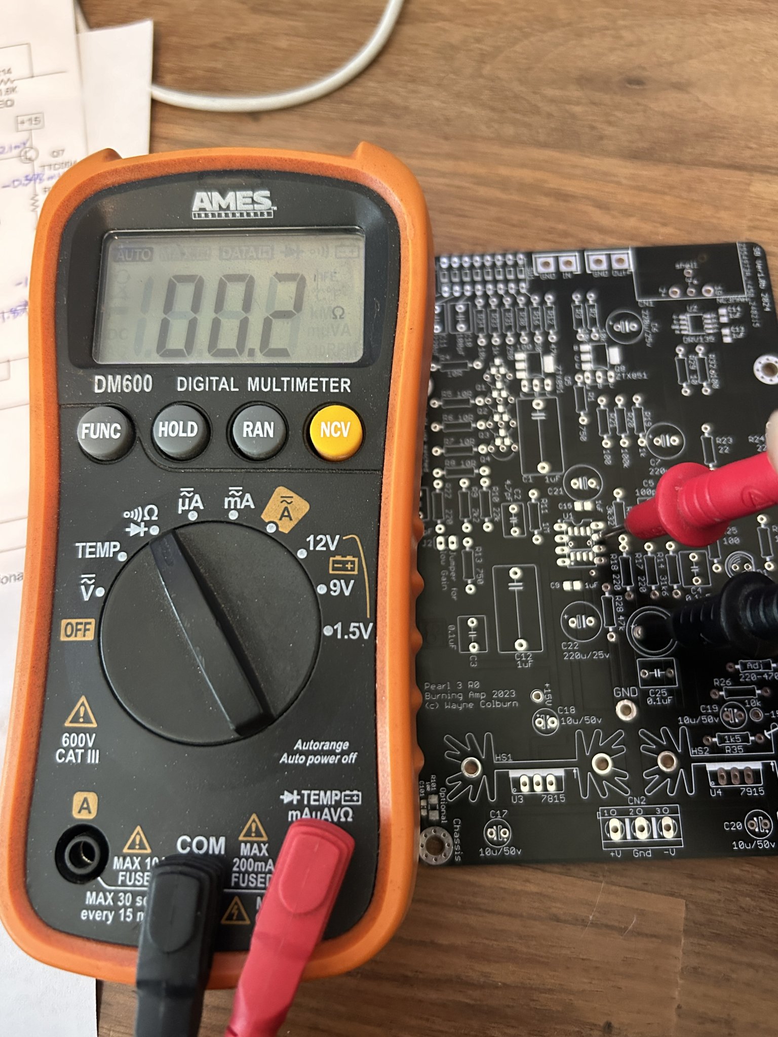

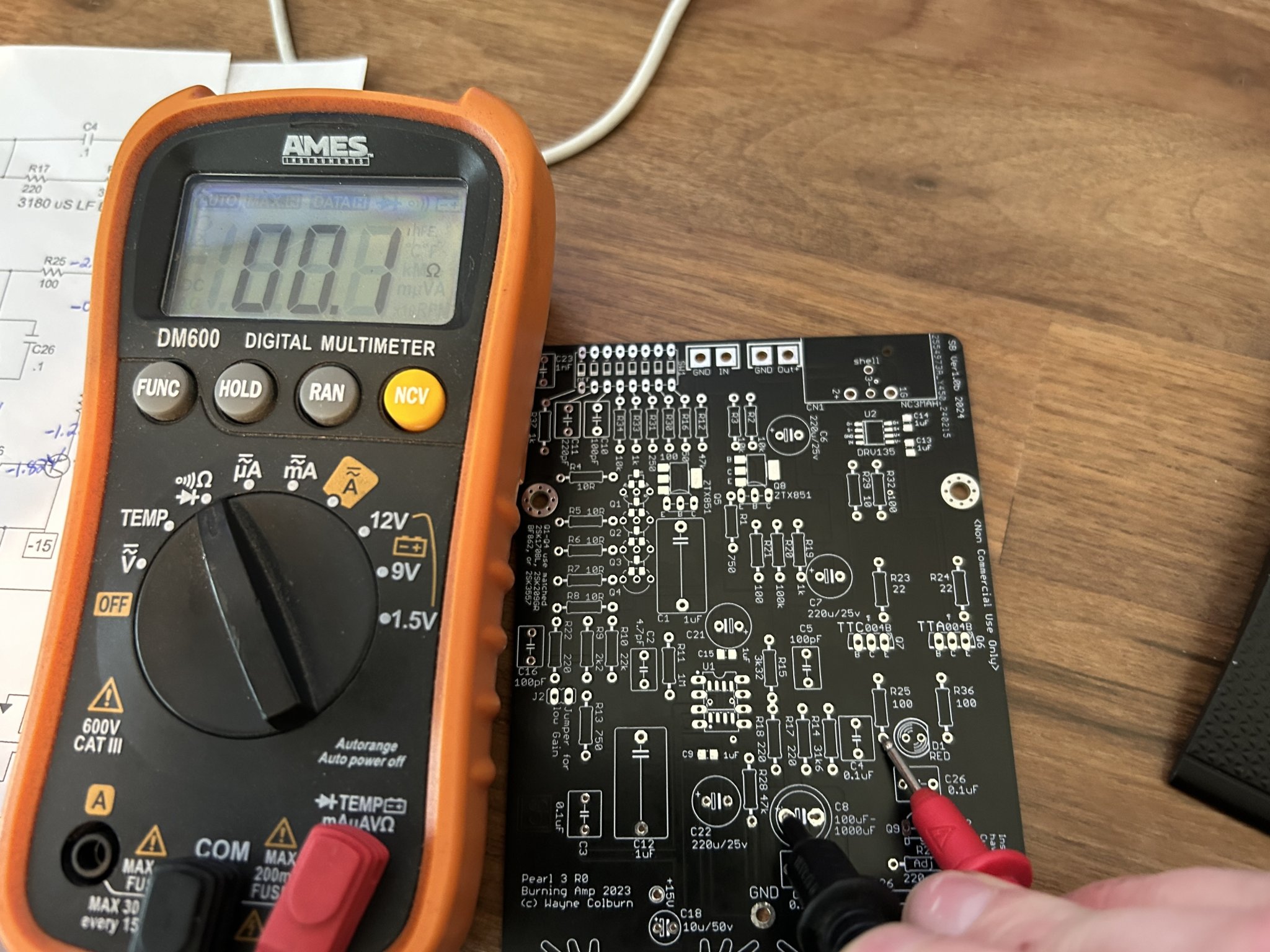

Is C8 positive supposed to be connected directly to Pin 7?
I’m seeing continuity between C8 + and Pin 7.
The board shows a trace that connects them but the schematic shows C8 connecting only to R18 and C25 only.
I just checked Pin 6 to Phono out and have approx 35k ohms.Your feedback loop has an issue here. Between + phono out and the - input of op amp pin 6 should read about 36K Ohms. C8 may have some effect over time so try meter in both directions and let settle.

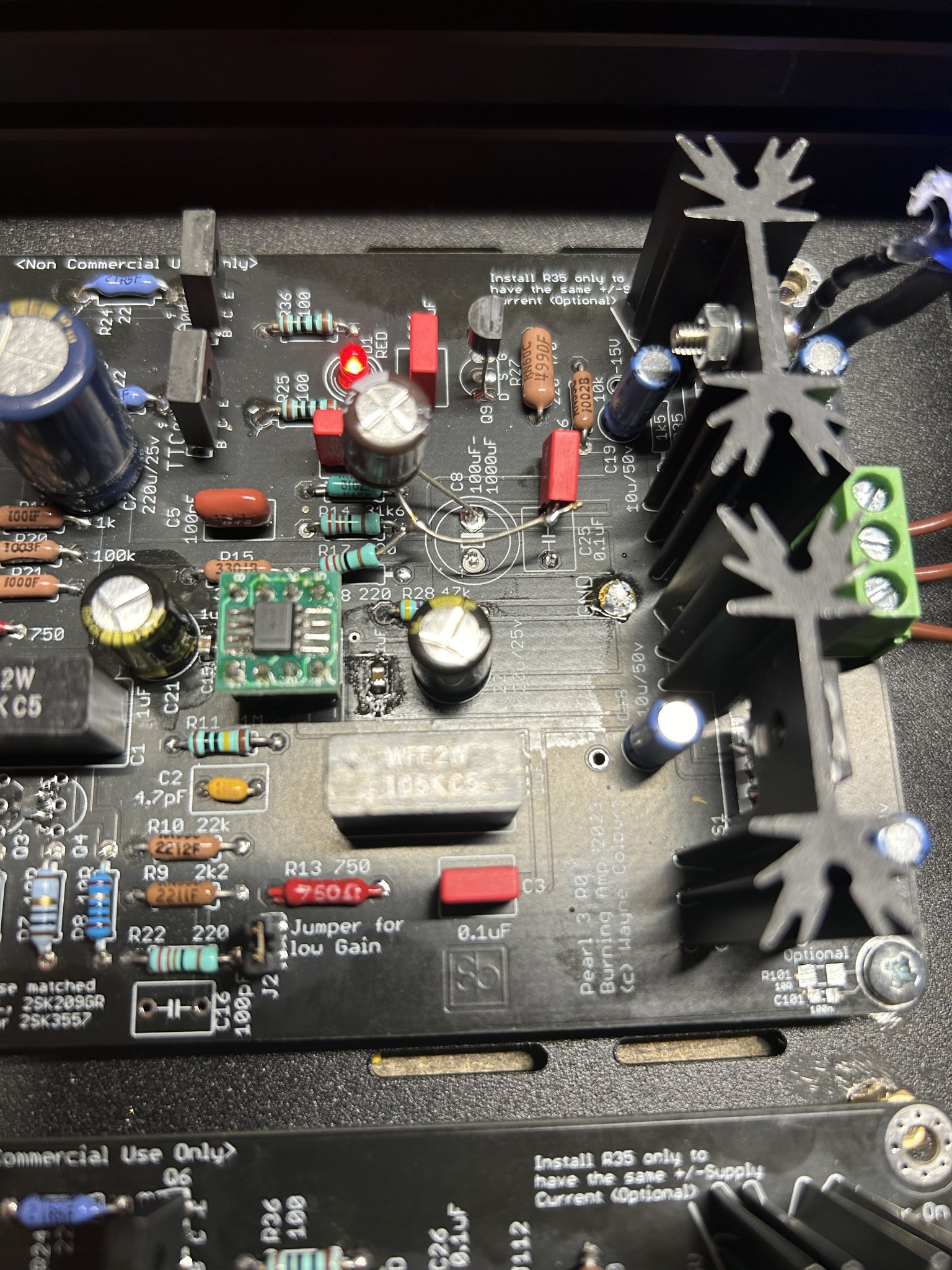

I made the modification
details?
On the boards I bought from another member it looks like there is a trace that connects C8 positive to pin 7. So there is 220 ohms between pin 6 and 7 as well.
I made the below modification. I’ll hook hook everything back up and test it tonight to be sure I have output before confirming that was the exact issue.
I have 3 other pairs of the same boards so I’ll probably try to cut the traces and add jumpers underneath.
The images above show the continuity and the traces. My red probe at the back of the board is touching C8 positive and you can see it attached to Opamp Pin 7 and then to R25.

Hi. Thanks Dennis for the findings, and sorry for those that got the ver1.0a pcb. I made some change to the supply trace routing to try to improve the supply and ground layout on this version (the last one). I took great care to double check the changes but it seems i miss this one, sorry. I’ll send the info, and how to correct the pcb before assembly to those that bought this version. Problem had already be corrected on my design file and next pcb won’t have the error.

Dneu2011 you can correct the pcb error from under, and resolder the parts at their correct location for a nicer assembled pcb. I will send the info today on how to correct the pcb with two easy steps, done from under the pcb, before or after assembly, to all the member that got the Ver1.0b version.
