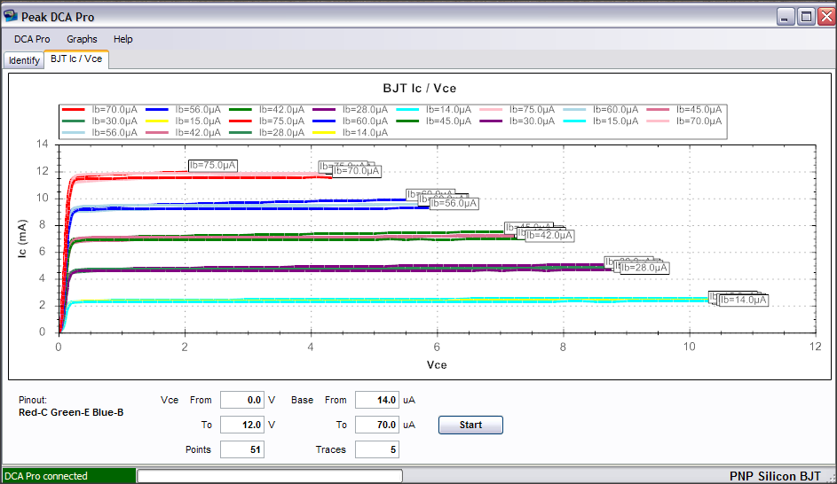

And here with a 3rd 2SA version that is very lightly compensate, phase max at 63deg (very good) 🙂
Random 2SA1930/2SC5171 as used in the non oscillating PSU... 2 NPN & 1 PNP traces.

They are available at Mouser I saw, not NOS yet. Me I had those from when I was collecting various VAS grade BJTs. Because plastic enclosed too, I thought they might solve the PSU oscillation pain in this kit after weighing the problem, still without Silpads and blind tare dangers given the peculiar sink situation. So it worked. But remember, in combination with "delete the 1uF capacitors parallel to the phono electrolytics". So I hope I contributed a little good practical idea.
