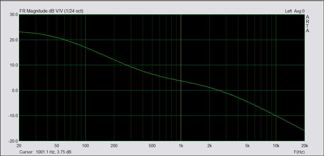

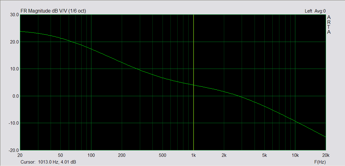

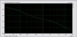

...Stock and flat Riaa values pretest. "Stock" is +0.2dB in the midbass and +0.4dB in the midhighs on average including any of my build tolerances. To go flat we need add 1nF more to the high and low cap values, also 820K across the 73.5K roughly. Just for reference to anybody it may prove handy.
