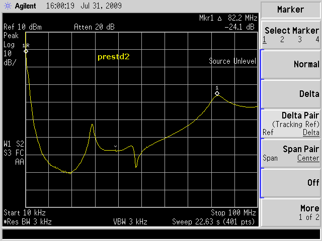

Me think me will ask me doctor for an earupgrade😱One more graph, here is the PSU Power Supply Suppression Ratio(PSSR) Near 60dB at 100Mhz
Me oldie ears cant hear 100Mhz or higher without a reciever😀
It is blocked anyway 🙂
Looks like its down 35dB at 1Ghz, allmost RF immune, impressing😉
That depends on the 10uF output capacitor (and other factors, like PCB).
If we examine the signal path construction of some competent RF function generator, awe at the work of the magician engineers and marvel at the heroic shielding and weird parts, then we know why we can't expect anything better than 70-80dB PSRR up to few decades of kHz beyond the audio band with typical construction.
That is so true 🙂

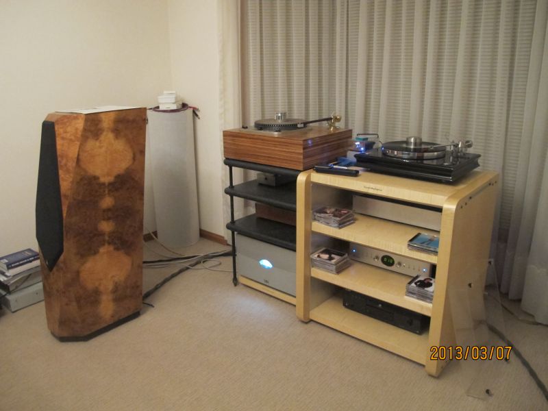

Well guys, i am loving it- R3 mate with Benz Ruby 3H-Turntable Once Analog(Aus made)/Basis Vector 3 arm. Compare to my previous phonostage Herron Audio(tube) the presentations is very different ie more laidback, no noise and so much more details😀
Very nice to hear! After we had so much trouble getting the parcel into your hands, in the end it turned out well...
That sounds good 🙂 be happy in ParadiseAny pictures to show?

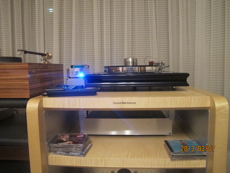

Yeah, my rig:
Thank you for all your help Alfred. I just added a rotary switch for catridge loading as per build guide. Even more flexibility.
Quan
Quan
your system looks great, I am sure it is more than appropriate to hear differences in phono stages!
