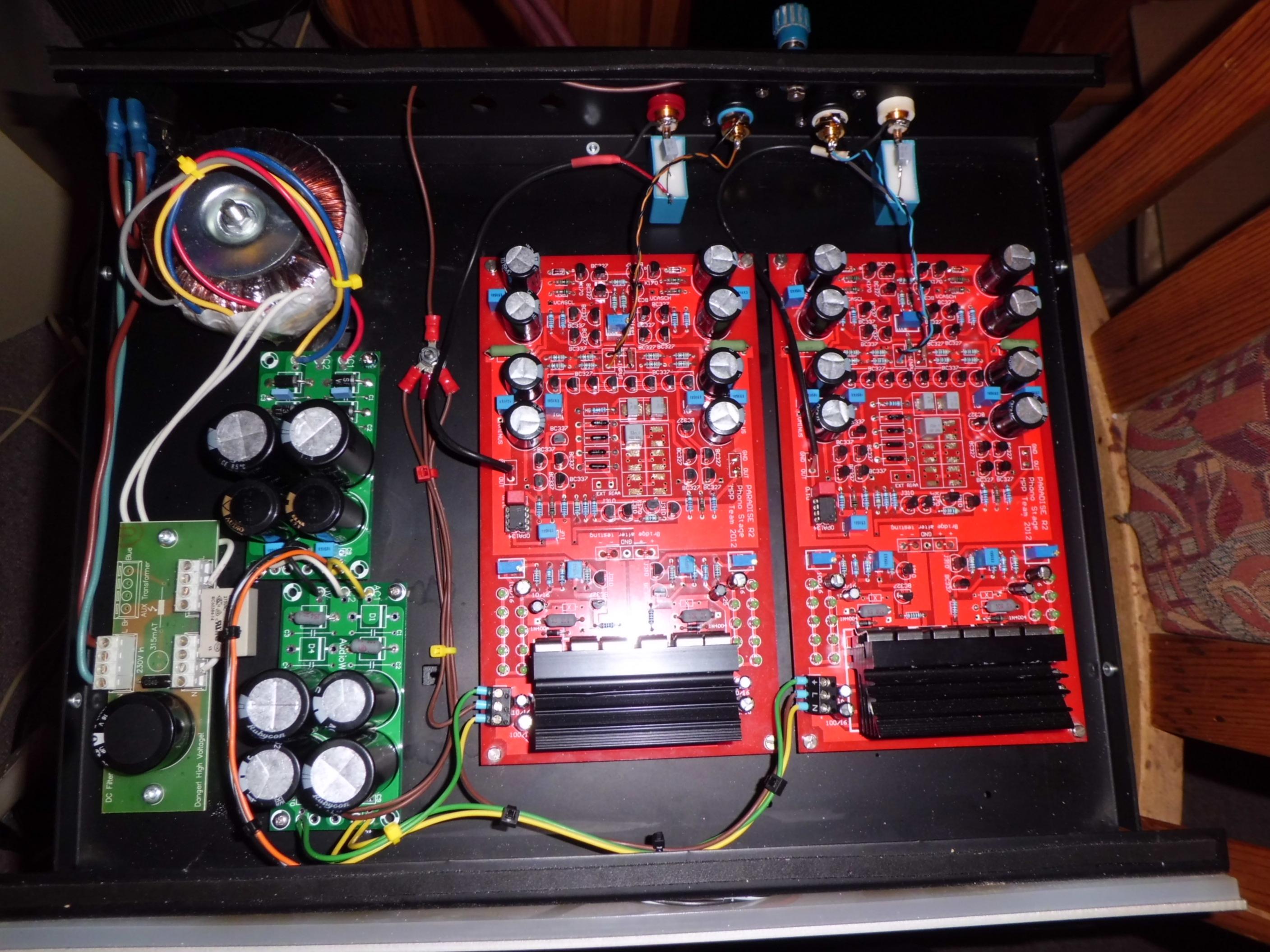

Here is my approach to a one cabinet paradise, some metalwork/shielding will come next, but it really works as is, as expected there is a little 50Hz hum in the channel closest to the psu, but i have to crank the volume all the way up to really hear it. My plan is to shield the psu with some normal material with a fairly high permeability like normal iron, but for now i will just enjoy some records, and the wife will enjoy the higher waf of the one cabinet approach😀

Right now dc coupling would be ok, since i am running through a commercial preamp with dc block, but i am building a dc coupled linestage with a relayvolume to be used in the future, and the relay volume will sound like a machinegun with the dc offset, and since i cant hear the difference so why not?🙂
