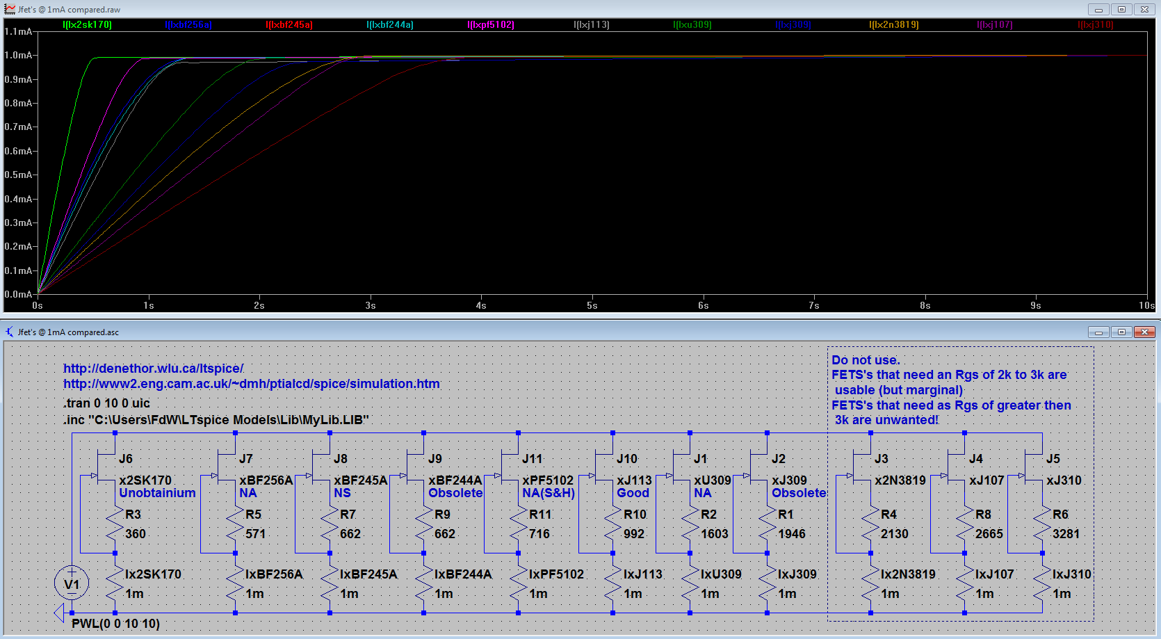

About some more reasons for a (not to bad) (but still) noisy PSU. Salas has found that it is possible that the PSU generates 20 up to 50 mV of white noise. This level of PSU contamination is not affecting the RIAA but we want perfection.
After some discussion, between Salas and me, it was thought that the J310 may be the cause of the problem. Back to the simulator, and the datasheet then, what I find is this, the J310 is used as a CCS of 1mA, for this it needs a Rgs of (about) 3Kohm, that implies a Vgs of 3Volts. The Vgs of the HexFet is (about) 4Volts, in this application. That leave about 1Volt margin on Vds of the J310, given production tolerances and specification spread between manufacturers, this may be not enough.
In case where the Vds margin is to low, the J310 will not be a constant current source, in these cases the PSU will not function optimal, and a higher than normal noise level will be present.
Now how to solve this? Easy! Use a NJF that shows a higher margin. For instance, the 2SK170 needs a Vgs off (about, according to simulation data) 360mVolt, and that leaves a margin of 3.6Volts. That would be enough, but the 2SK170 is something like unobtainium. That is where I started my hunt for a replacement NJF. If should be cheap, leave lots of margin, and easy to get.
I went to the Mouse site and searched for NJF’s that fit the bill, from this and other data I compiled the attached graphs, left to right 0 Sec to 10 Secs is equivalent to 0 to 10 Volt on V1. All NJF’s that are at 1mA constant current in 2Volts (e.g. 2 Secs) are wanted, NJF’s that show 1mA constant current in 3Volts (e.g. 3 Secs) are considered marginal (and the J310 is there, just, borderline).
From my graphs, the best, commercially available and cheap NJF is the J113, good choices are 2SK170, BF256A, BF245A, BF244A, J113, U309 and J309. If you want to propose others, then let me know, if applicable, I will add them to the graph :)

ordinary 2sk170 are easy to get from an
ordinary german supplier named R.... for
~0.70€ each.
Then I say, go for those, use a 330 Ohm Rgs and it will work fine. The J113 is 15 $ct (12 EuroCent) at Mouser and will work just as nice.
