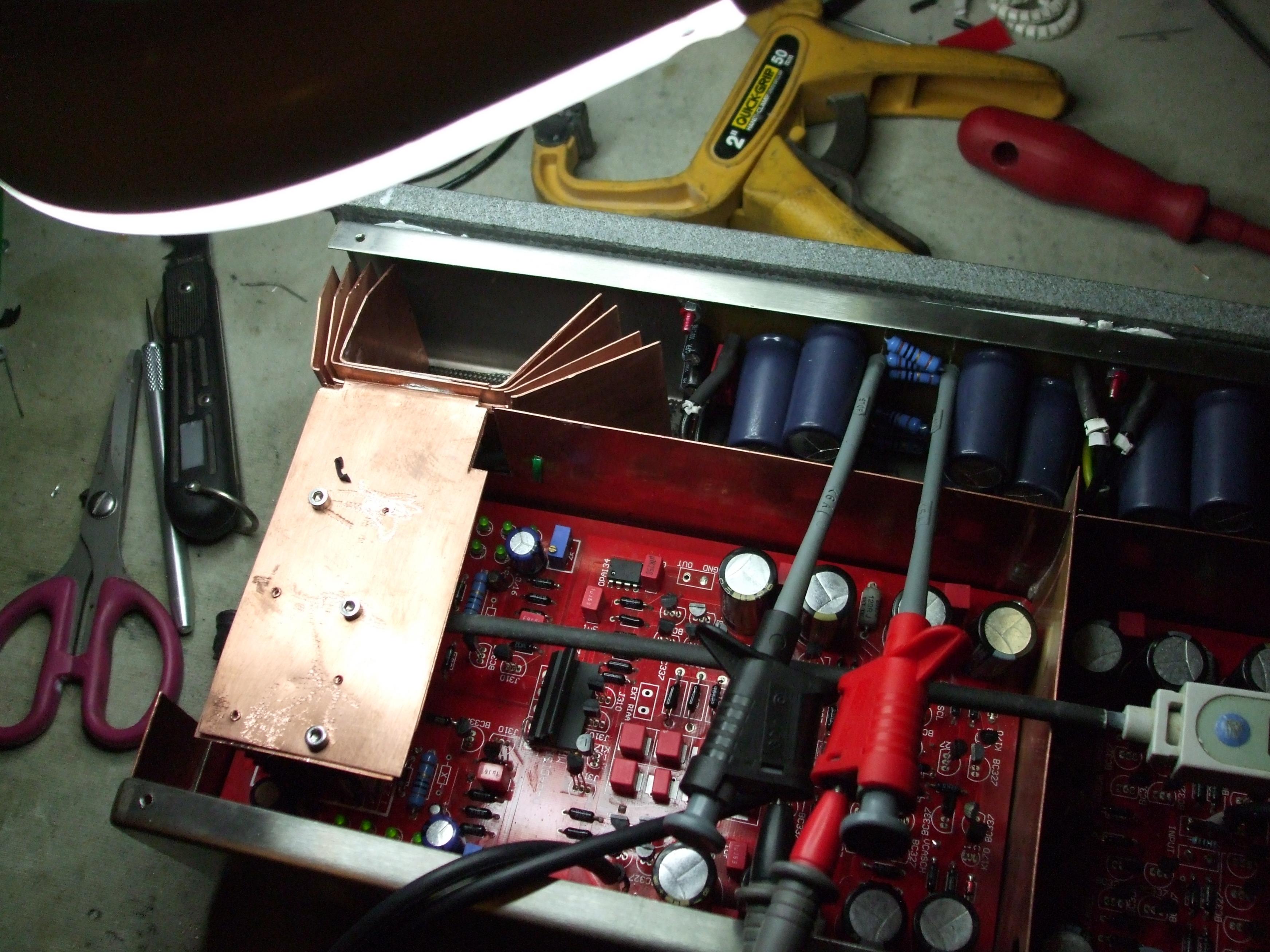

Can someone tell me,"maybe a question for Frans" about heatsink temperature limits? I have measured 50 degree after 30 min steady
What is your experience gays with these temperatures ????

Like Joachim noted, up to 'environment' + 30 DegC (about 50 DegC) is fine for me, on a normal day (20 DegC) that gives 50 DegC, on a hot day 60 DegC, and in a heat-wave condition it will get up to 70 DegC (and that is fine too). Danger comes when the internal temperature goes above 80 DegC (that is still 20 DegC below the maximum allowable/sustainable temperature for the electrolytes).

One can take the temperature out of the sinks with a bit of work.
This is diy after all
Case has a couple of holes covered with Stainless steel mesh outside the inner skin
and heat is transfered there with same cooper.
At the same time consider that inside the inner skin the temperature must be prety constant and no air current are alowed to stop the thermal drift

Yes you can (and did) 🙂 looks good.
