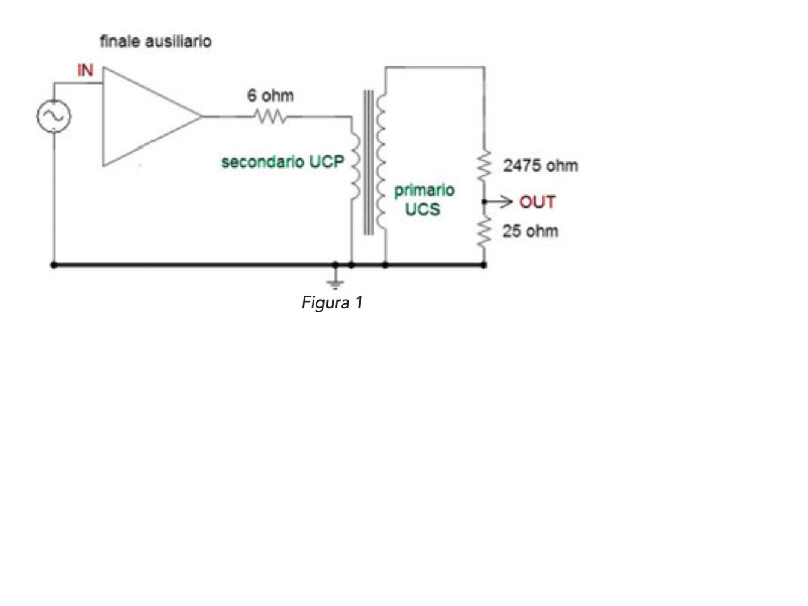

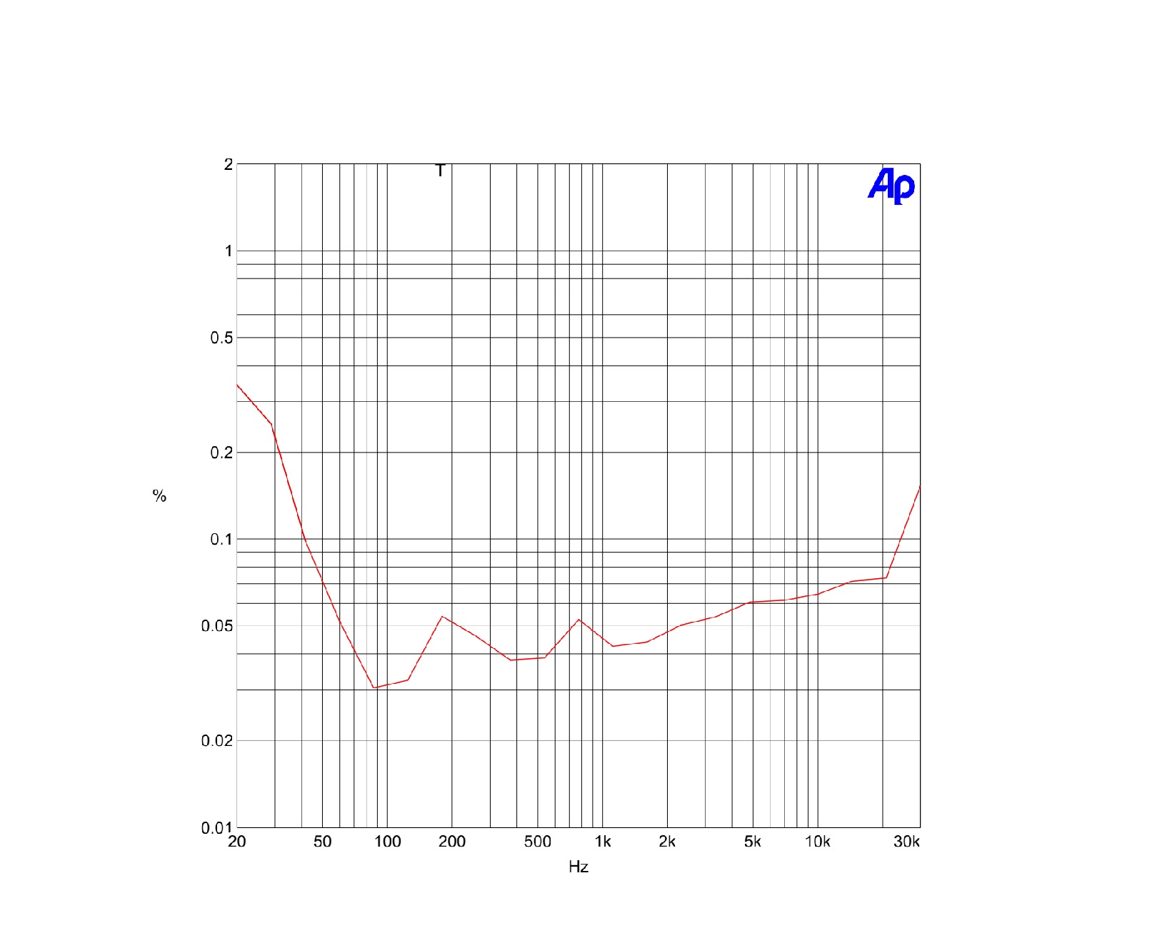

in attach a diagram of the test done with a sw developped inside Audioreview by my collegue Fabrizio.
I spoke about 2017, date of my initial thread.
It is same as yours with REW ( maybe it takes from ARTA the concept to measure the passive components) ) and it is fine so other people can do this ( I am not familiar with REW).
This sw has more info inside respect to REW but is not important for a general use.
The results are exactly the same ( in general) and these test tell us a lot of things except, partially, the quality of iron.
The consifìderation of 45 are fine but for my experience the coupling of pieces moves just a little bit.
I have used different method to put the section of iron perfectly faced (in a p-p) and the final results differ for a bit.

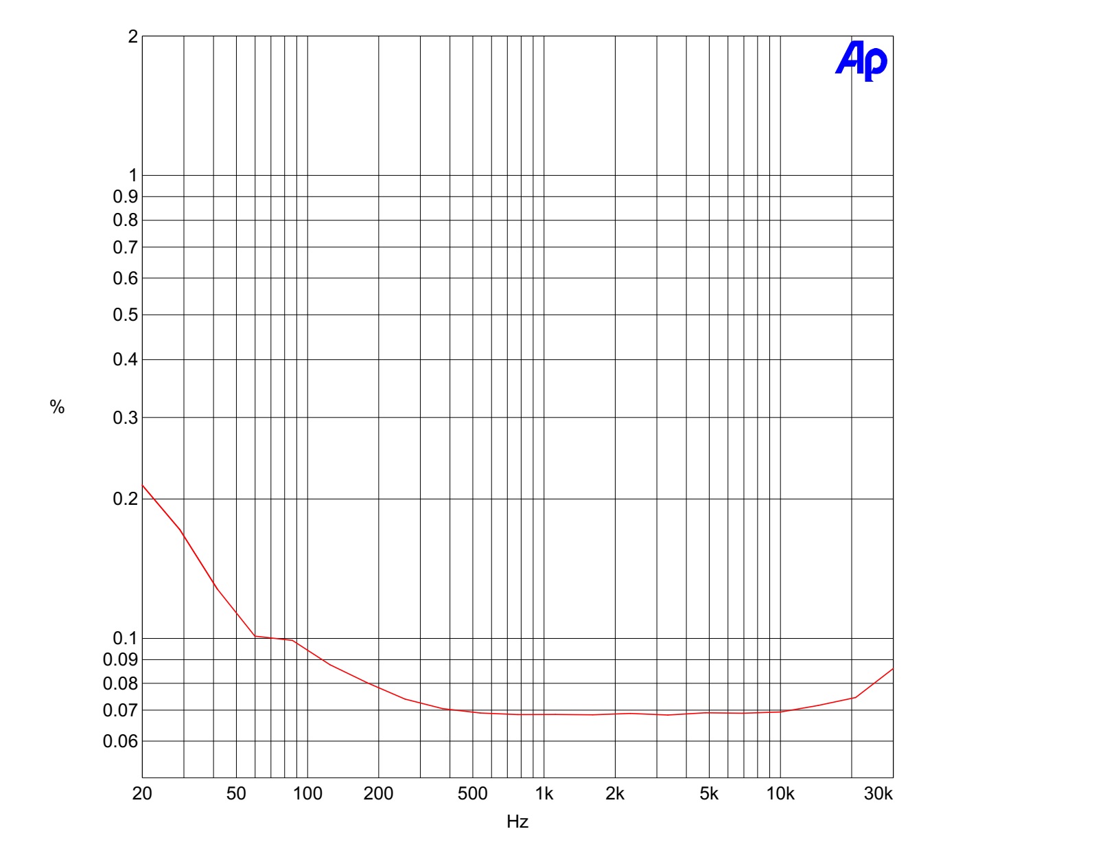

In attach one of the best I have tested, it is ONORI in Italy. The method fo fix the iron is very strong.
And the lamination and material are fine.
In attache the test THD vs freq. with 60 Vrms on primary, 5 watt rms on load, very good results
Walter

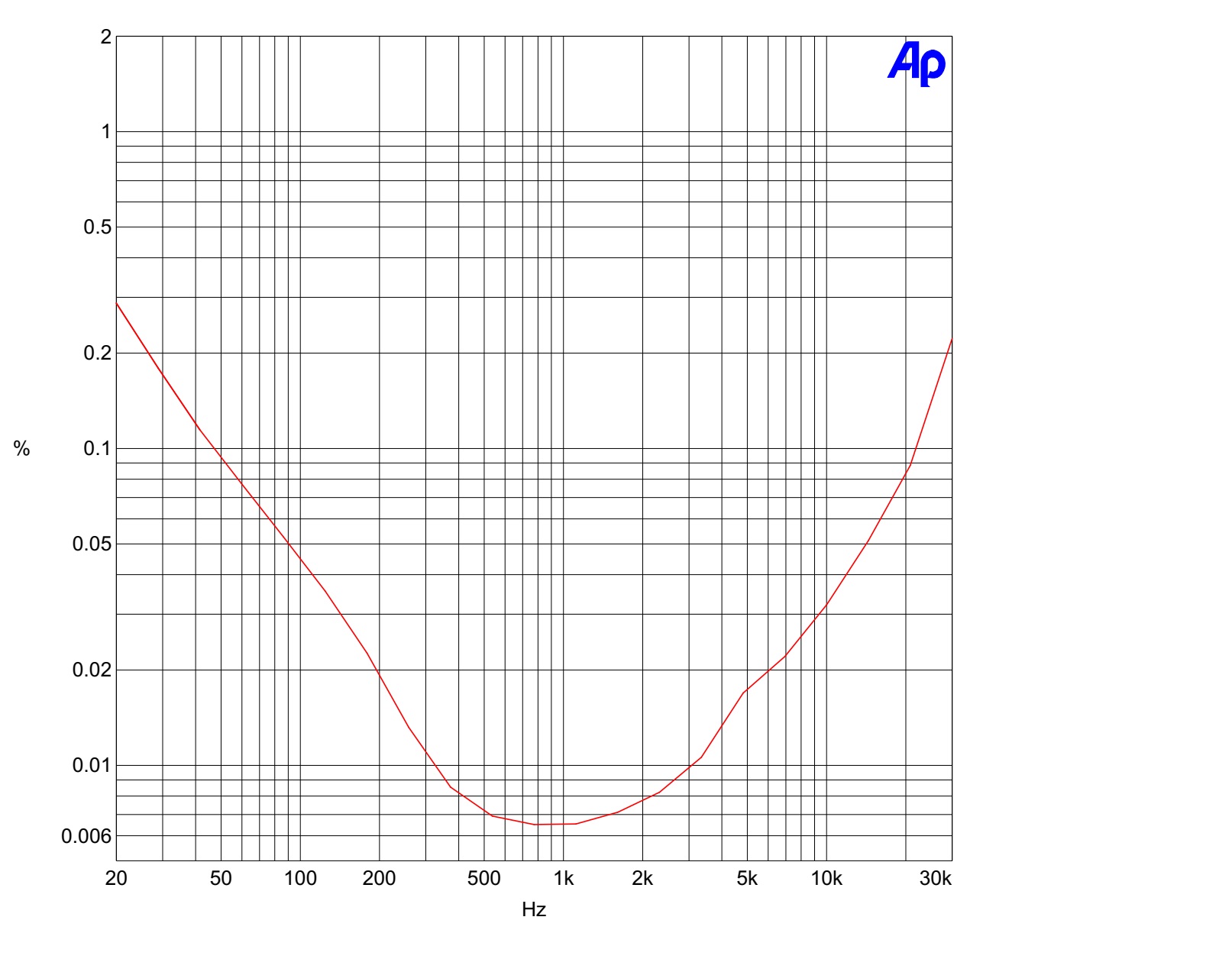

In attach just an example ( this is a proto, not well done, for 300B) of THD vs Freq.
59 volt on primary close to 750 ohm ( almost the Rp of a 300B), around 5 watt.
The shape show that on low frequency there is an issue of iron and Inductance and on mid high an issue with capacitance.
In absolute the value of THD are not so bad but the problem is the shape.
I have measure hundreds of tube amp at Audioreview lab plus others in my lab and I always found a good answer between measurement and listening tests when the shape of this test is not a narrow U but wider
In this case the region with a very low THD is little.
For example ( of the shape) the other one in attach, as reference. The difference is high
And the shape must be same for different level and this is very hard to get.

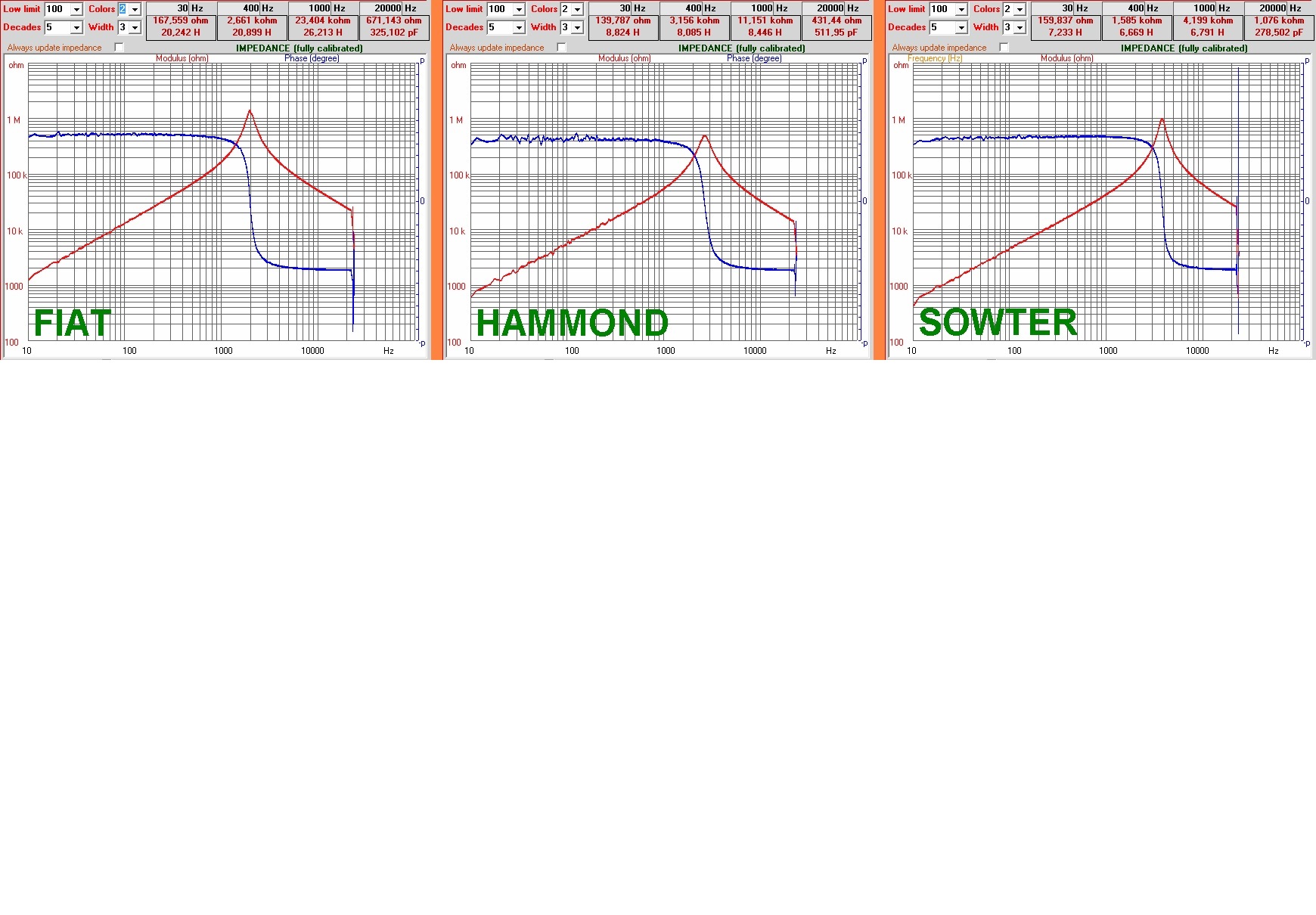

Just for info, in other attach the freq. answer of a assembly (ONLY bobbin) of an OT; intersting!

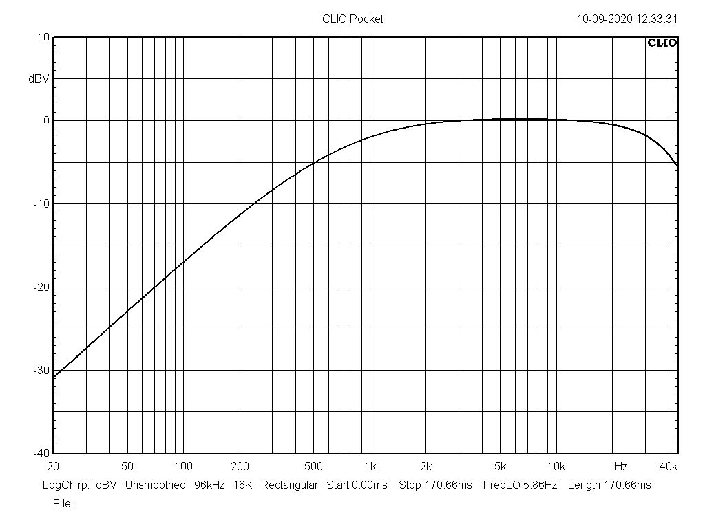

I don't think the tube will see a reactive load in the midrange. That would mean that the phase would change but this does not happen. For a resistive load, the reflected impedance is resistive for most of the audio band and then getting inductive on both ends. On the high end, outside the audio range for good transformers, it becomes capacitive past the transformer self-resonance. Otherwise you would be in deep deep trouble when applying even a small amount of feedback.
Maybe your problem is that your set-up with the generator in series with the resistive 6-8R load on the secondary is a capacitive load as seen from the primary where you take your measurements.

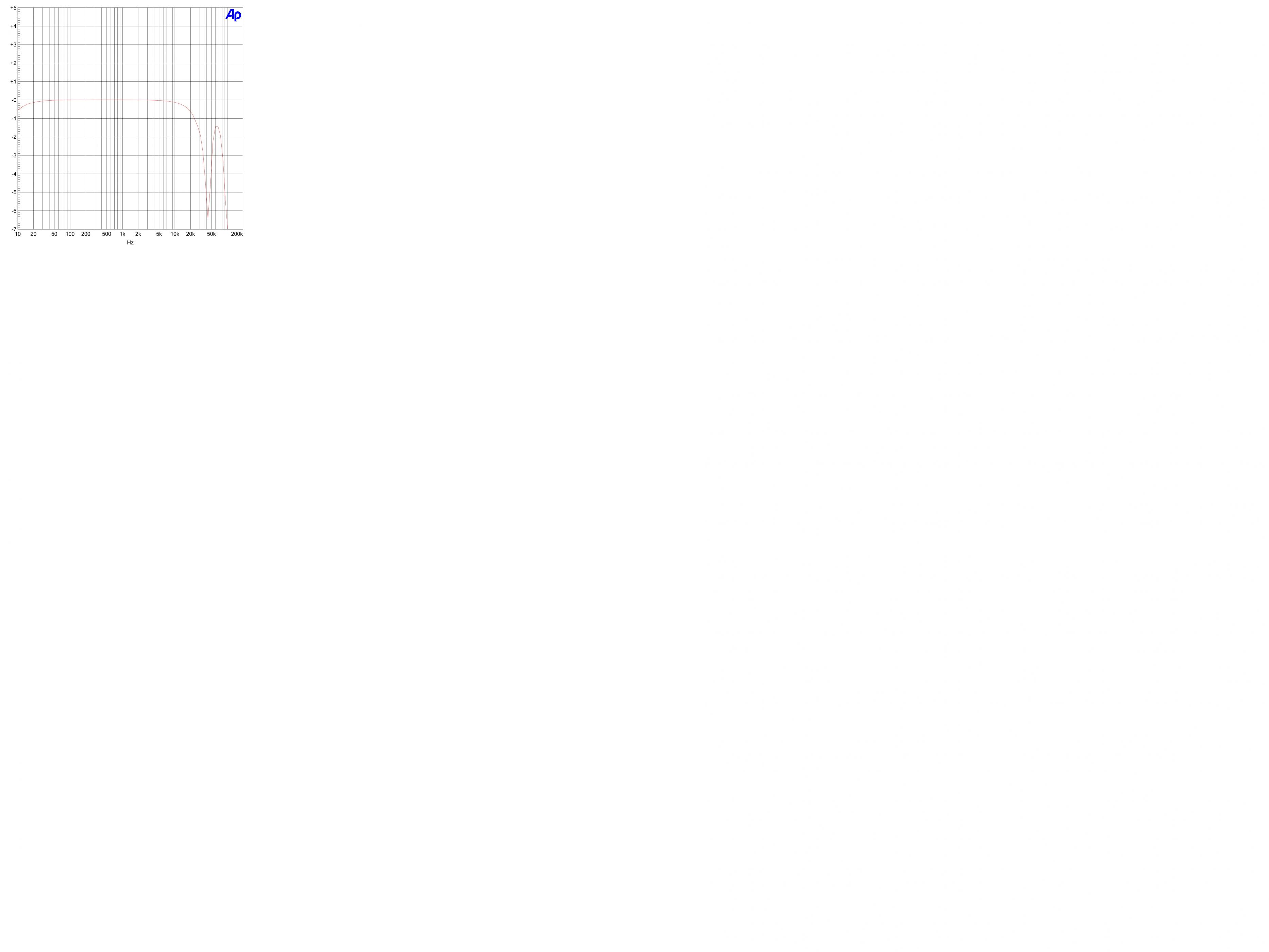

In attach a test of freq. respinse for Onori trafo, se, 3k5 primary, 8 ohm secondary.
The first one is done time ago driving from secondary,
27 volt on primary closed to 750 ohm, 1 watt
on secondary there is a ss amp with 7,5 ohm in series
The second one, done minutes ago is the same trafo with conventional test
AP Sys 2 with 12 volt out ( the max value that can run in this configuration) , Zout= 20 ohm plus 680 ohm in series
Secondary closed to 7,5 ohm, around 500mV out
The results are perfectly comparable.
(I don't know why are so little, I will try to post better image)
Walter

The method I explained is simply and fast, just to get a good ss amp (commercial).
Then with a simply attenuator 1:10 or 1:100 you can read with a an audio card (normally with a limited acceptance) the results
In attach a base circuit with components.
On primary (now act as secondary) there is resistors network where the total Z is the load with a similar value of the Rp of tube.
(the value written are referred to the test done in the article)
Walter

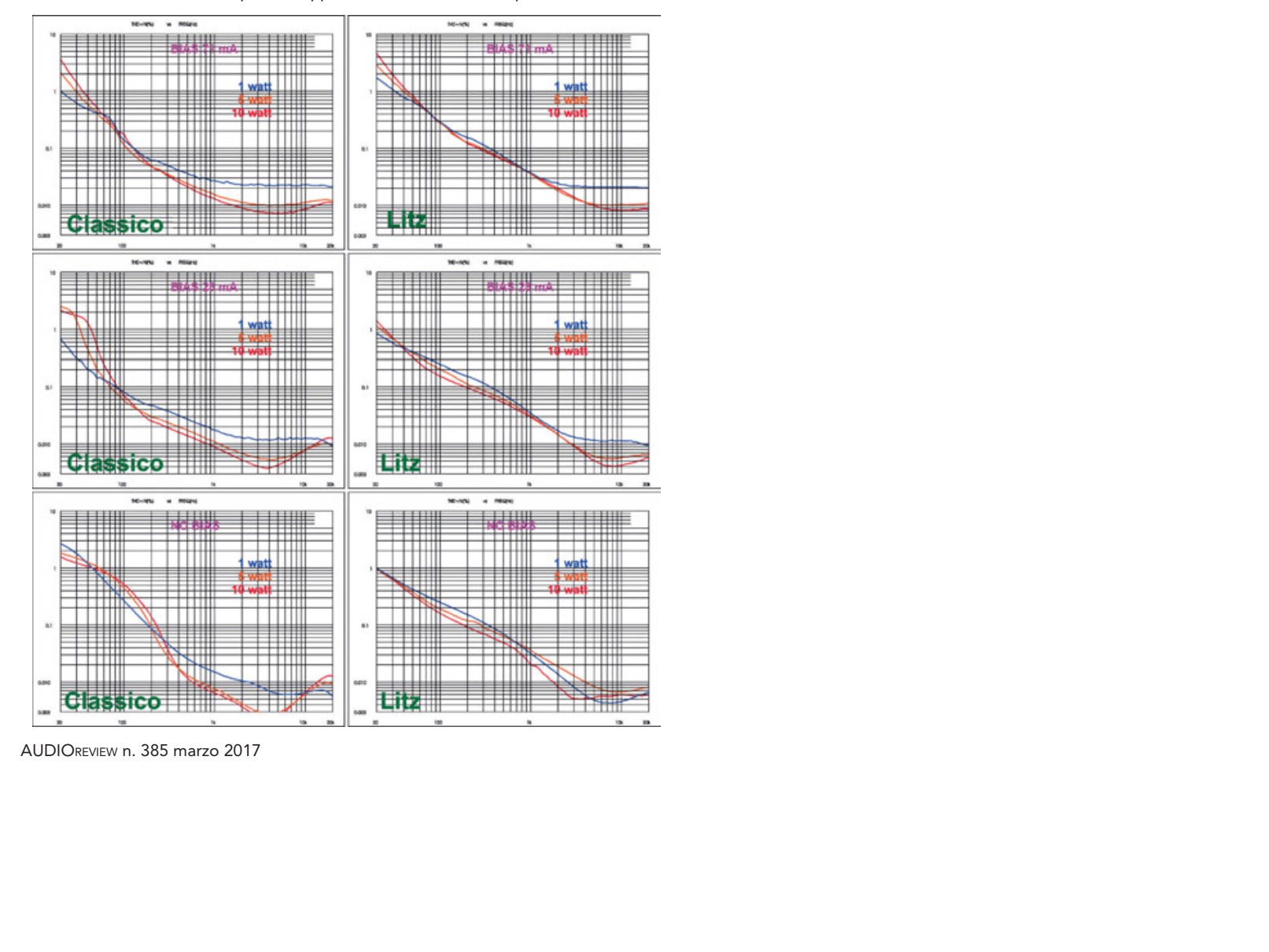

For each type of trafo; I am preparing also a test set with the bias current to test the SE
I can tell you that also the changes with or without are non so different, most of the problems in low frequencies are related to iron quality
We done something in the past, in attach a test on one proto with Litz wire and another with classic, Ibias e non bias
Walter
