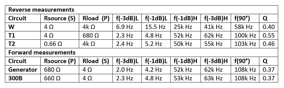

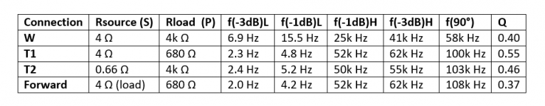

@Jazbo8: I just did the forward measurement, as it is a really quick one. I used a source resistor of 680 Ohms driven from my signal gen, and loaded the transformer with 4 Ohms. I have added a row to the table with the results of the forward measurement, I have attached the new table.
The -3dB, -1dB points are found the same way as before, by taking the AC transfer ratio at 1 kHz as the 0 dB reference point. So it always measures the transfer ratio relative to the ratio at 1 kHz, not the level. in this way, absolute level is not critical. I set my generator at full output, 20 Vpp or 7.07 Vrms.
It is interesting to see that the LF -3dB point has lowered beyond measurement error. HF -1dB and -3 dB remained the same, but the 90 degree point and the associated Q have also shifted a bit.
That is an acceptable way to predict HF bandwidth (influence of stray capacitance).
To check LF bandwidth and maximum LF power (core saturation), another measurement setup is needed.
Absolutely! Post 91 shows clearly how the primary effective inductance is level and bias dependent, as can also be seen from the magnetization curve I presented in that post. In order to measure the LF response, you need to apply the correct bias and measure at realisic level. This measurement was done with no bias and very low signal level.

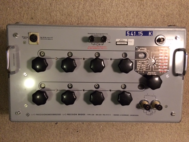

This thing can measure inductance with DC current applied, but I am not sure if it accepts high AC voltage to mimic primary AC swing.
Very heavy, would need a permanent place on the bench.
Nice boat anchor! Seriously, R&S gear has always been fancy stuff.

Final measurement with 300B
I have done the forward measurement with a 300B tube, and added the results to the table. I have traced the tube's characteristics with my uTracer, and found the following properties:
Va = 250 V
Vg = -45.0 V
Ia = 74.6 mA
gm = 5.5 mA/V
Rp = 660 Ohms
mu = 3.6
The plate voltage is a bit low for a typical 300B operating point, but I chose this point because it was within the capabilities of my uTracer. It goes down to -50 Volts on g1. The resulting Rp is normal for a typical 300B output stage.
From the reverse measurements, the T1 connection matches the forward results best, the differences are negligible except for the 90 degree point. The forward measurement on the function generator nailed that aspect. The rise of the -3 dB point to 3 Hz that I expected did not occur.
The conclusion...
Measurement of the frequency response with the OPT reverse connected is feasible, the most representative results are obtained when the secondary is driven from a source with a series resistor equal to the rated secondary load impedance, and the primary is loaded with a resistor that is equal to the driving tube's internal plate resistance (T1 circuit). The disadvantage of this method is that the transformer cannot be driven to full voltage without overloading it.
When the secondary is driven with the driving tube's plate resistance transformed through the impedance transformation ratio and the primary is loaded with the transformer's rated plate load resistance, the transformer can be driven to full voltage. This connection is thus better for distortion measurement. However the resulting measured frequency response is slightly less accurate. And stay away from the transformer's LF -3dB point at full power, if you don't want to fry the driving amp.
When the primary is loaded with the transformer's rated plate load, the transformer appears to perform significantly worse than it actually does in-circuit. This result confirms what I said in post 30, and is in line with the simulation results of post 35.
For the nitty-gritty details of the HF behavior at the extremes of the passband, the reverse measurement loses accuracy regardless of the circuit used. But the forward measurement with the generator matches actual performance perfectly. This is not relevant when no global feedback is used, but when feedback is used, the exact behavior of the HF rolloff becomes highly relevant for loop stability.
The measurements thus prove my point beyond any doubt. In that sense, I am done. I'd also like to figure out the distortion performance, but that will have to wait until a later time.
