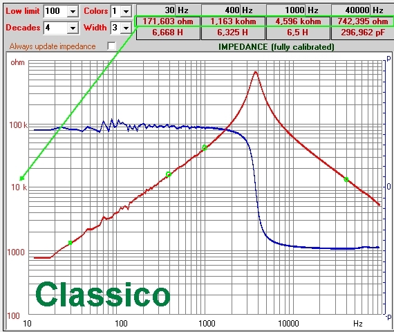

The value of R are the parasitic value of the resistive component in serie with the reactance.
In theory less are these value, for the same frequencies and same value of H, better is the quality of the trafo.

So the R value has nothing to do with the impedance plot below. Just want to know how to read and interpret the data given. Is the software available? I'd love to try it with my own OPT's. Thanks.
Yes.
Again, not necessarily. High DC resistance of winding may increase damping of transformer's self-resonance, lowering the high frequency response peak. In one particular case, unloaded secondary of an interstage transformer, high DCR is pure goodness without any disadvantage.
