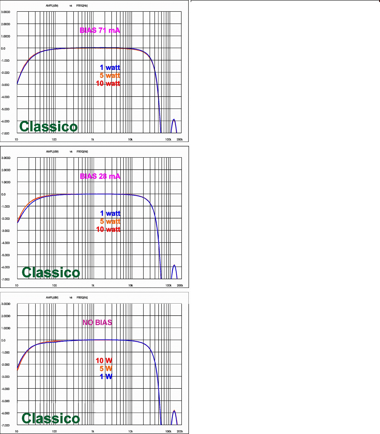

1- In attach some test done with s.e. trafo reagarding freq answer and thd s frequency, with and without bias. There is a test also with a Litz trafo; I have posted them in another thread time ago.
The differences are marginal.

I don't think the differences are marginal. They may look marginal on a log-log scale, but if I look at the low frequency performance of the "classico" transformer, THD in the bass region jumps all over the place by almost a factor of 10 between the various bias currents. Also, the distortion spectrum is not given, which is something I expect to vary greatly with bias. The litz transformer is doing better, but still displays significant differences. Is everything on the litz the same, or is it an entirely different transformer?
How was bias applied?

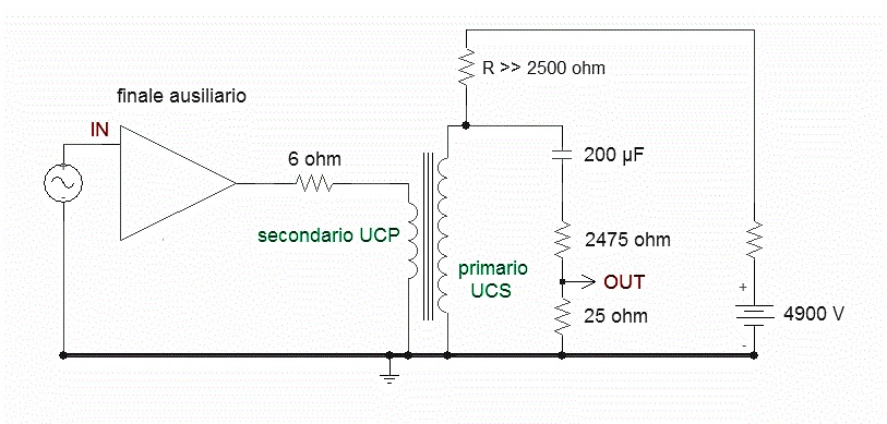

Some answer to Timpert:
1- every trafo is a reversible stuff in each parameters; the difference are done by real loads connected on primary and secondary; with the our test set you will get exactly how the trafo is playing
2- the bias was applied with a current generator; in attach the test set .
The 4900 volt is a generator made from Fabrizio for another project and it was used here as current generator. We will implement a new ones more easy.
3- When we have a very low Z at low frequencies the main trouble is the current delivered by tube and not (only) the problem of trafo; in this case it is close to the limit and it will be distorted; in the same way at high frequency, of course
4- Regarding measurement I confirm you that are all exact because are compiant with a simply lcr meter
You can double check this paramente looking at THD vs freq; the Hammond and Sowter exhibit a double THD than FIAT at 20 Hz
Walter

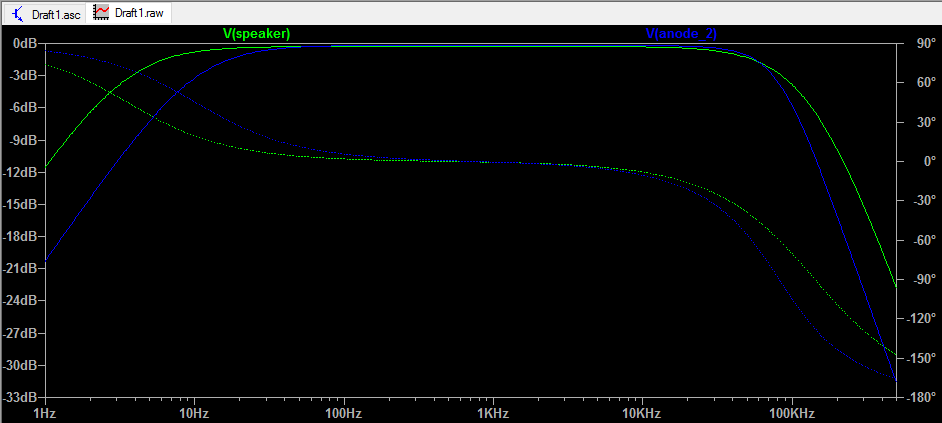

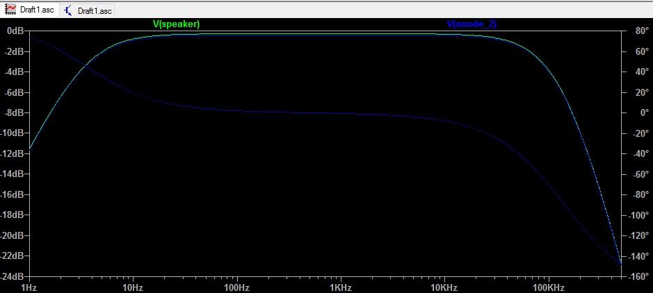

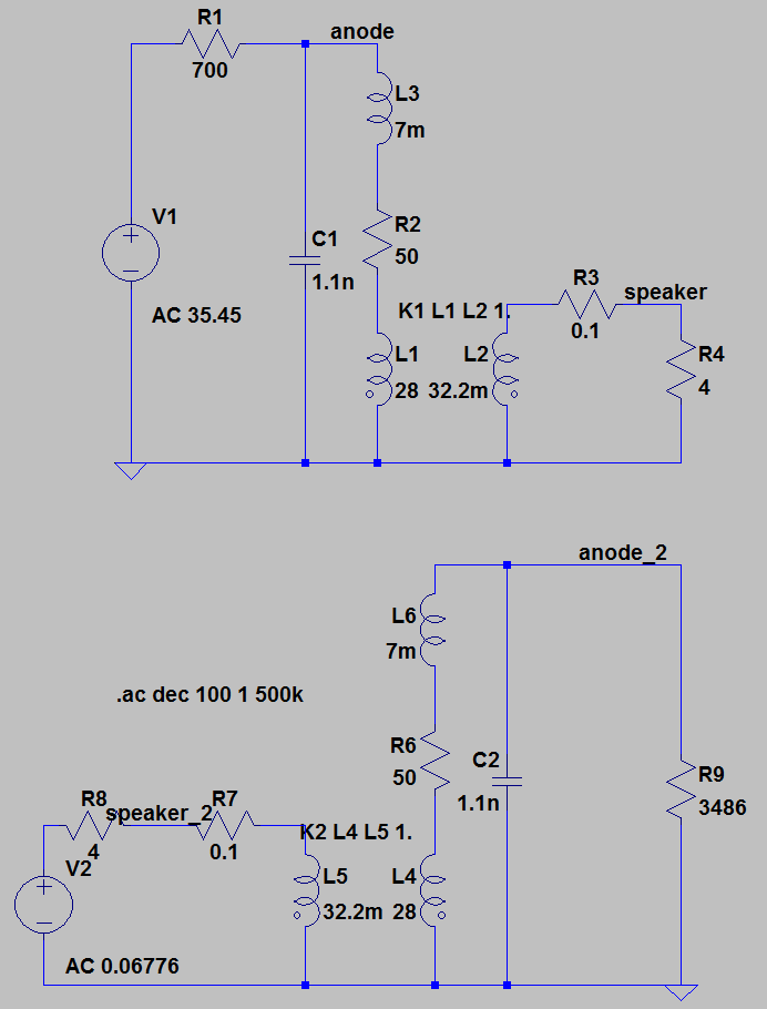

That is true to a large extent, but the results from post 301 are still incorrect, please let me show. Imagine a well documented transformer like the VDV3035SE. I have had this transformer myself, and I can confirm that it meets its specs with great accuracy. In the attached circuit, the upper circuit is the "normal" connection, where the 700 Ohms source impedance represents the 300B. I have taken the datasheet values for leakage inductance, winding capacitance, Rdc, yadayadayada, and I have simulated it in LTspice. The result is an almost perfect match with the published response graphs, and coincidentally, with my own measurements on this transformer as well. The LF -3dB point is at about 3.5 Hz, and the Hf -3dB point is at about 85 kHz. Of course, these are all small signal values.
The lower circuit is how you propose to measure the transformer in the reverse direction in post 301. The resulting response is quite different, with an LF -3dB point at 10 Hz and a HF -3dB point at 75 kHz. The LF rolloff has a first-order slope, the HF roloff has a second order slope, but the Q of the slope in the lower circuit is higher, and the phase response is worse, as can be clearly seen in the second attached picture (response.png). V(speaker) is the "correct" response, V(anode_2) is the "reverse" response. I wouldn't call these results the same. The reverse response is quite a bit worse.
You can transform the RDC of the primary and the leakage inductance as series components to the secondary, but not the primary's parallel winding capacitance. That's why you cannot simply reproduce the primary-to-secondary response in the reverse direction, and have the impedance transformation ratio correct as well. You can however get a rather good approximation of the transformer's transfer characteristic by reducing the load resistance to the driving tube's Rp, so in the lower configuration, that would mean reducing R9 to 700 Ohms to represent an average 300B. If you do that, you get the result from the third attached picture (response2.png). They are the same for our purpose, only a nitpicker would would not accept the result as representative because the input impedance as seen by the source is not an exactly transformed version of the input impedance as seen by the 300B.
But now we have a different issue: the load impedance is about a fifth of the normal impedance, so the test can only be done at reduced level if you don't want to overload the transformer.

There is nothing wrong with using simulations, since the OPT's equivalent circuits are well known, and match well with real-world performance, even if they are not perfect, they are certainly sufficient for discussion purposes. That's why we really need to see Montanucci's article, perhaps he has some explanations for measuring the OPT "backwards"...
Please leave the simulation.
Why can't a simulation be true? I have indicated that the results match the datasheet and also the measured performance of the transformer. Why would it somehow be invalid when the same simulation is applied to your method? I have shown that you can get representative results with your method when you terminate the transformer with the driving impedance instead of with the rated load resistance, and that's the source of the whole error. My point is that if you don't get the impedances right, the measured performance of the transformer in your setup is significantly worse than the achieved performance in a real amp. That cannot be the intention...

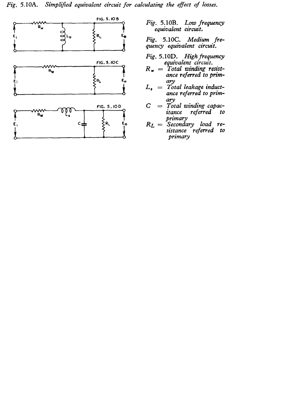

Regarding the trafo for me it is easy to see it as a bi-directional stuff.
On theory, as in attach, the facts are shown
The main reason to play with the test I show is to define exactly the specs of a trafo without other influences.
And is not possible that the simulation has a better credit than real tests!
Regarding the reverse test set in other old thread I have shown othe measurement, please check them
Walter
