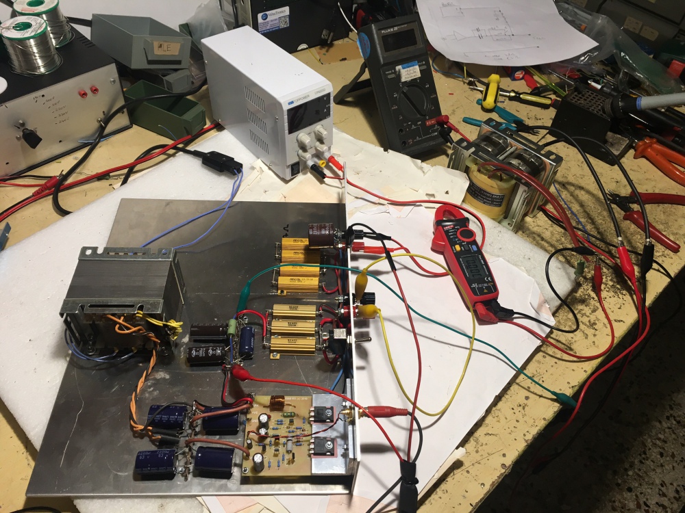

Each trafo is a bi-directional device and you have a care to connect the right load on primary.
But also you can ply with different values.
And the driving voltage comes from a good ss amp is enough to get a different amplitudes for test.
The test of the OT trafo alone with a large swing is very difficult

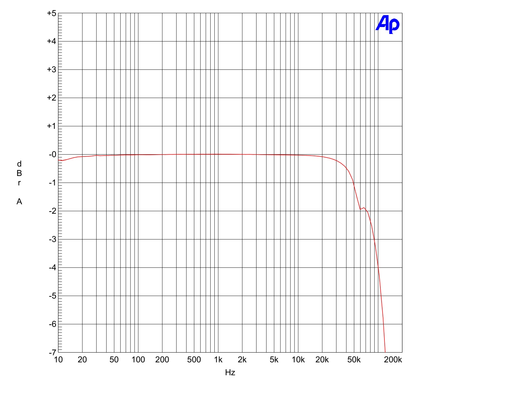

In attach an example of a freq. response
EL34 p-p, nominal 6000 ohm a-a, 8 ohm secondary.
From SS amp comes 17 Vout rms ( 1kHz as reference) , 8,5 volt on secondary of OT ( as expected) , primary closed to 6.000 ohm.
The V on primary are 220 Vrms, ratio 27,5 , as expected

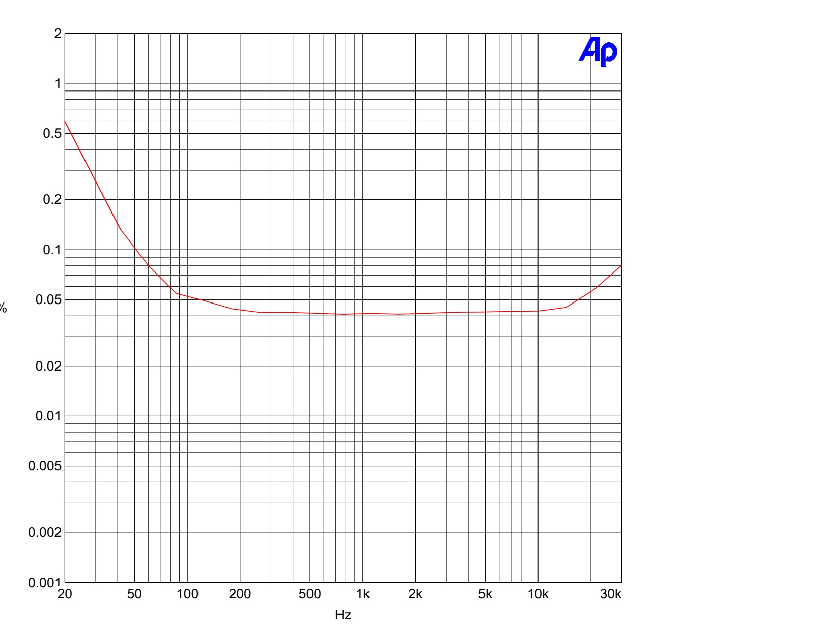

Then the Thd vs Req, at the same level; the results are not bad.
Walter
